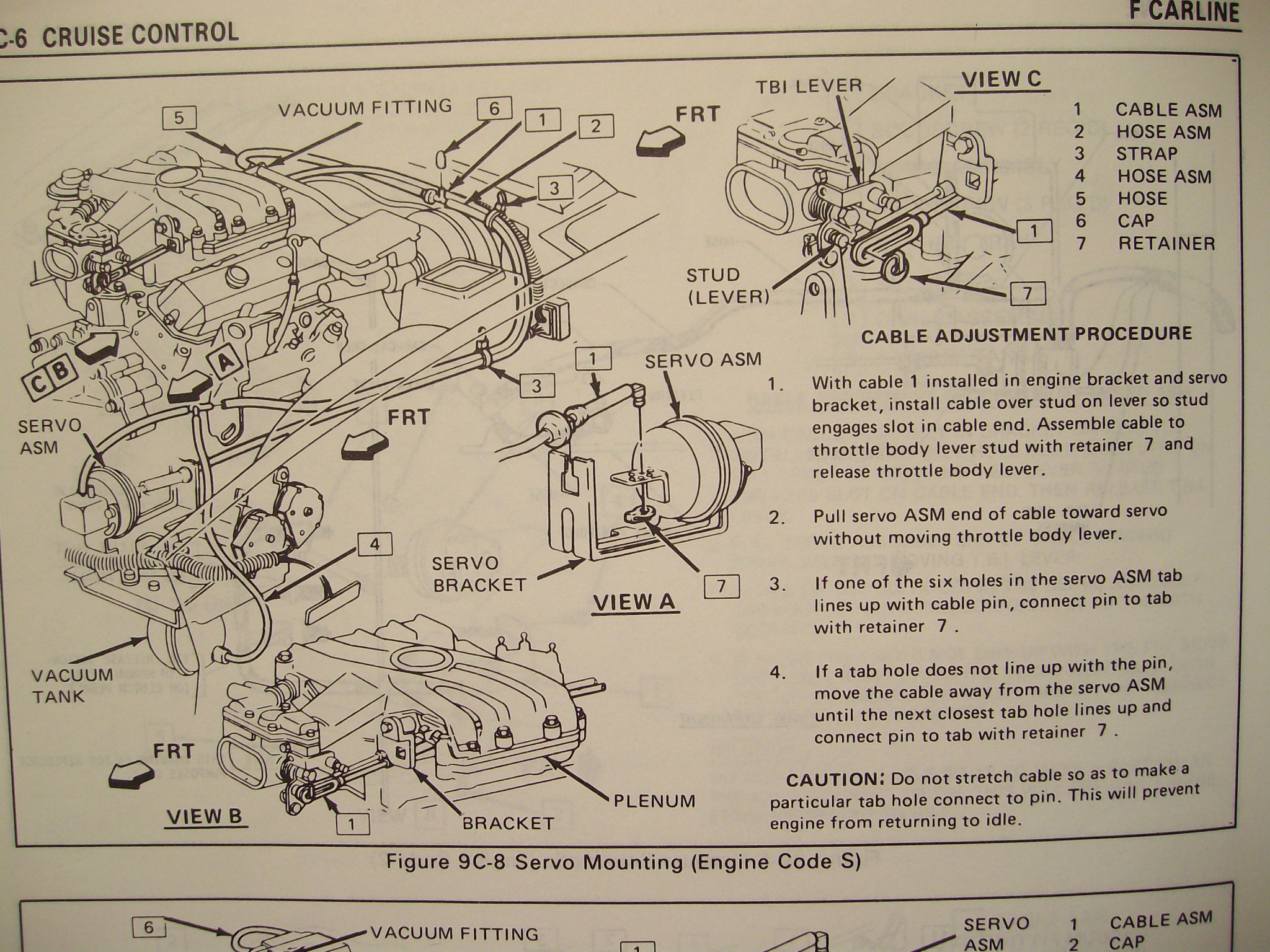

From the fender vacuum tank, the line tee's to the cruise control servo then all the way back to a tee for the plenum and brake booster. That's what the factory manual show's anyway.

I tried to copy my manual for ya.

That helps a little but I don't have cruise control. I may just try to tee the plenum port to each of the loose lines and see what happens. Like I said I think they are for the heater controls. The only diagram I found shows lines the back of the control not in the engine compartment.
