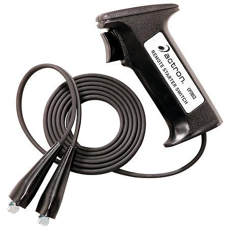

Hook up the MULTI METER and verify you have 12 plus volts at the starter, then, if you do, why not try jumping the starter leads to see if its an ignition or starter issue an checking voltage drop under load as a first test, if the starter spins the engine with the manual switch you know its not the starter itself, if it fails too you know its a starter failure
