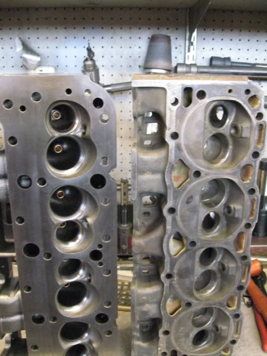

Ah didn't realize it was a DD. Ya the amount of miles you'll put on it in that case makes a hyd roller a better choice. The solid does tend to beat things up, especially with the much higher spring pressures they require. I was under the impression you were building a weekend warrior. Still look a cam in the 230/236 range from comp's XFI line. I think you'll be happy.
The EQ 200 ccs are nice heads imo. Performance wise, for the price, they're a good piece. Here's the pics of mine right out of the box next to some stock L98 heads:
