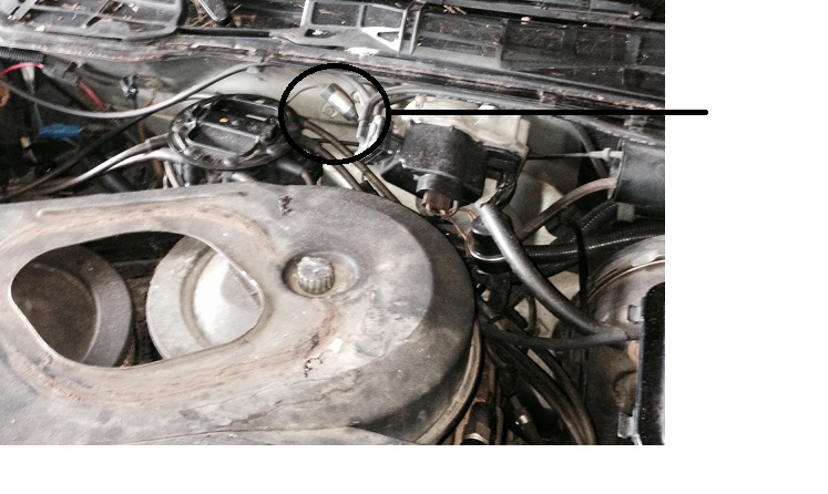

I have a 1982 Camaro with the Crossfire engine. Can anyone tell me where the ESC module is located? My car was parked for a year, and something chewed some of the wires in the engine bay. I removed the harness and traced the wires from a diagram I found here, but now it has a lot of spark knock when I drive it. Never had that before. There is also a wire that I could not trace that is located on the firewall behind the distributor. Can anyone tell me what it is for? I have attached a pic of the location, so any help would be great. Just need to know where the ESC is located. I have seen nothing that even closely resembles the pics of the ESC I have seen online. Thank you. Gary.Camaro Crossfire?-camaro-firewall-wire.jpg

ESC module is on the firewall, somewhat lower than that. It's a flat black box about 2½" x 3½" x about ½" thick with a long connector all the way along one of the long sides.

the '82 ESC module is under the dash close by the ECM-it is a black plastic box much larger than the '83 up underhood mounted ECM module.The '82 setup,if faulty,can be swapped to the '83 style and it will work the same.

I had the dash and harness out of the car yesterday, and I didn't see it either on the firewall or next to the ECM. I'll look again this weekend to see if I can locate it. I would like to eliminate the spark knock so I can drive it. The car only has 67,000 miles on it and, otherwise, runs very well.

I don't think it is by the ecm. IIRC you can see it when you drop down the valance trim piece under the map pocket in the Trans Am. I would imagine it is in a similar location in the Camaro.
Looks like this-
Old Sep 23, 2014 | 07:38 AM
82tarecaro's Avatar
Joined: Aug 2003
Posts: 2,708
Likes: 15
From: NYC
Re: Camaro Crossfire?
I found a pic on the net of its location. You can see the black box on the passenger side of the dash in this pic.

I found mine on the lower passenger side I/P.
