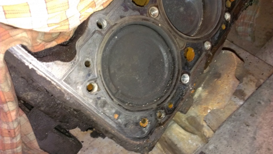

Hi!
What pistons do I need to get 9.5:1 compression ?
I want these pistons +5сс
I will get 9.5:1 compression?

Those will work. The LG4 earlier than 1985 used dished pistons to get it's lower 8.5:1 compression ratio.

I buy this engine. Cast #14010203
I want rebuild and new carb,cam,piston,intake,headers.

My heads #14022801 (1.84/1.5 valve)
I want instal:
-intake edelbrock 7501
-cam CS XE262H-10 http://www.summitracing.com/parts/cc...make/chevrolet
-carb Holley duble pumper 600cmf
Question.
What do I need pistons and head gasket for 9.5:1 compression.
Can I put a 1.6 rocker?

Those flattop pistons with stock heads will get you right around 9.5:1 (9,5:1 is how you would write it!) compression. You're fine.
I wouldn't do 1.6:1 (1,6:1) rockers. It's not just the lift, it's also the fact it can cause the pushrods to bind against their alignment slots in the heads.
Get the right springs to work with that cam. Not that you will bind up the stock ones, but they will not have the pressure necessary to control the valvetrain with a more aggressive aftermarket cam in the higher RPMs. Comp 981 springs are what you want. They are drop-in replacements for stock. Reuse your stock valves, locks and retainers (even the stock exhaust-side rotator-retainers).
