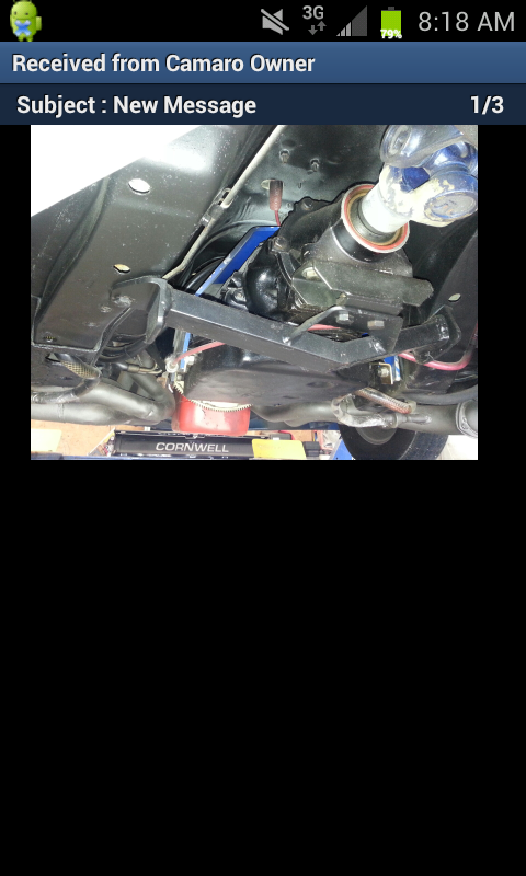

I read your other post, and saw the pictures..
that exhaust system looks too small for a BBC..

Re: My 468 bbc Flat lines in 3rd gear
Hey we have the same rear end and brakes i almost caught mine on fire after a pass lol went to get my timeslip and the guy yelled FIRE and they were just smoking. freaked me the f out. ceramic pads dont like long burnouts lol

Attached Thumbnails My 468 bbc Flat lines in 3rd gear-screenshot_2013-08-12-08   My 468 bbc Flat lines in 3rd gear-screenshot_2013-08-12-08   My 468 bbc Flat lines in 3rd gear-screenshot_2013-08-12-08

I see, the headers take a different path and route the exhaust pipes away from the transmission.
They went under the axle but that's ok since they don't hang lower that the lift bars.
That looks great ! but are you sure that the pipes are 3"? they look smaller to me.
Regardless someone spent some money on that car to do things right, despite they undersized the carb for track use.
You stole if for 9 grand ! Enjoy it even if you need a new carb, that is small change.
