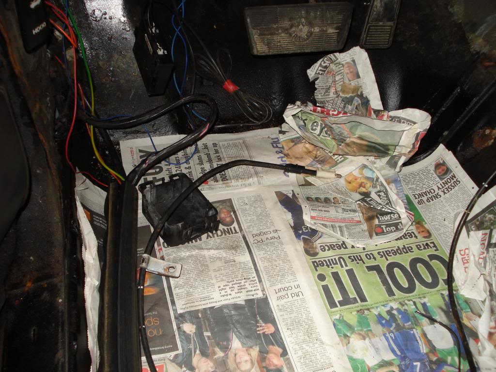

here are the pics
the first on is from the gear shifter
the other the other end of the cable
hope that helps
Old Nov 10, 2013 | 11:43 AM
Joe Tag's Avatar
Joined: Jul 2011
Posts: 1,613
Re: cruise control
Shifter lock out. The piece in the picture houses it. You will have to drop the column and remove the dimmer and ignition switch it is mounted to. Mark the position of the screws you remove with a sharpie to make the adjustment easier in reassembly.

what does that mean do i have to take the dash out as well where is the dimmer and ignition switch then the cable should connect is the shifter lock anything to do with cruise control if so its never worked before
Old Nov 10, 2013 | 12:01 PM
Joe Tag's Avatar
Joined: Jul 2011
Posts: 1,613
Re: cruise control
Totally unrelated to the cruise. The dimmer is below the circled part, the ignition switch is above it in the pic. It mounts to the ignition switch, but the dimmer is mounted on top of it. You just need to remove the two 13mm nuts that secure the column mounting bracket to drop the column.

yes it is , is that where it goes into whats the shifter lock out and what the dimmer
Old Nov 10, 2013 | 12:21 PM
Joe Tag's Avatar
Joined: Jul 2011
Posts: 1,613
Re: cruise control
It locks the shifter so it can not be moved without the ignition on as stated in my first post. The dimmer switches between high and low beams.
