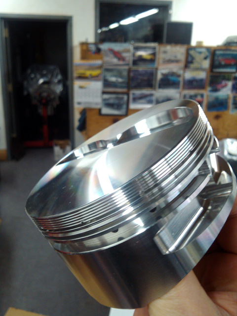

Anyone recognize the pistons? And how do I know how much the block has been decked? Don't have any idea what the compression is.

First, those pistons are domed pistons which will have a higher compression ratio. If you are stuck using those pistons, I would look for heads with the 76cc chamber to help keep some of the compression down so you can at lease use pump gas and not have to always use racing fuel.
Second, pistons may have a part number on them and you can look the part number up online. Hopefully those are forged pistons.
To find out if the block has been decked, just measure one of the pistons that is all the way up an measure the gap between the outer flat part of the piston and the block. If there is no gap, odds are the block has been decked.

Thanks for all the info. I'm still kinda drowning in this rebuild as I'm just so overwhelmed!
On the pistons/compression, can I just run a slightly thicker headgasket to alleviate some of that if I go with small chamber heads? Reason I ask is below.
If the pistons have part numbers, they aren't on the top surface :/

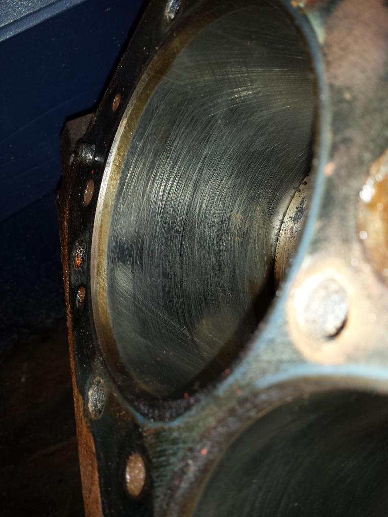

engines in plow truck live hard lives.
The cylinder walls look good, they still have cross hatching..
There is nothing special about the pistons they are flat tops with valve reliefs, they are dished NOT DOMED. They are not high compression pistons.
64 CC heads should be fine.. but a machine shop can CC the piston and head and do the math to determine static CR so you are not left guessing.

Nothing weird looking about the pistons,
Those pockets are called valve reliefs. You may have a cam with alot of lift, the reliefs keep the valves from hitting the pistons and are very common on high-perf engines. You did say this was a 383 crate engine?
