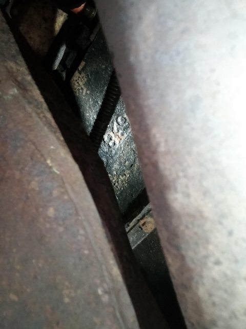

This image clearly shows (GM) 5.7LG SGI stamped into the engine! Its a 350!
For the life of me though, I cannot find the casting number anywhere!
The only other number I found cast anywhere is this:
(G?)52(8/3?)9
Not too sure what it means
Anyone have any idea where the casting number should be? It doesn't seem to be in the usual place.
So instead of a '91 LT1 swap' Mr. Red Neckerton said was in the engine, it seems to be a '94 Truck/Van Engine, probably an LO5 or something.
(G?)52(8/3?)9

I've attached below a number I found casted in to the block as we were loading the car on the Uhaul trailer to bring back to Virginia, it seems that these are the last 3 digits of the casting number, and are really all that matters.
From what I've researched all of the 638 blocks had provisions for roller cams (bosses existing as we as being drilled and tapped for the spiders) whether they actually used roller cams or flat tappets. That right?
The engine is going to need a rebuild (mosquito foggin every time I floor it) and i figure if I'm going to do it, I'm going to do it right, parts wise. But then I started reading about PROM flashing and all the equipment required with that... oh boy. Is that absolutely required to do after changing out the cam/heads and everything? I'm thinking the engine will run like donkey doo until its done. I wish there was someplace local that did all the legwork for a reasonable price instead of 400$ something in ancient computer-specific equipment.

Correct a 638 motor could will have provisions for a roller cam but the bosses may not have been drilled and tapped. That's why seeing is better for believing. If it has a flat tappet, you'll just need the spider, dogbones, and retaining plate. Not hard to get those from a junk motor or a member on the boards.
Recommending what parts to use has a lot to do with what budget and performance goals you have, what do you plan on doing with the car, what intake (carb,tpi,tbi) your planning on using, what the rest of the drivetrain is like gears and transmission. (fill out your profile, advice givers really find that useful) Being a motor with mystery miles on it and able to smoke out mosquitos, you might want to debate rebuilding the whole thing so that you have full choice of compression, quench, rings etc.
As far as computer, I think your car is TBI, you can do it yourself if so inclined to learn using EBL. http://dynamicefi.com/ As far as older efi, that's the best bang for buck and functionality.
