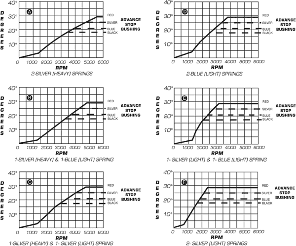

So it looks like the the lowest advance block i can install is 18 degrees advance, so i could run 16 degrees initial and that would give me about 34 total. Based on your input it appears the chart B would be the best curve. I was actually considering the C curve but i will try the B curve first.

SO i finally got the limiting bushings from FBO. I went with the 14 degree bushing. I set my initial timing at 22 and my total is now 35 degrees. I change the springs in the distributer swell. The total timing comes in at 3000 about a 1000 less then it did before. I also install a A/F gauge so i could start tuning the carb.
Thank you for all the suggestions, the car runs completely different, will easily break the tires loose at 60mph causing instead of just laboring so i think i am on the right track.

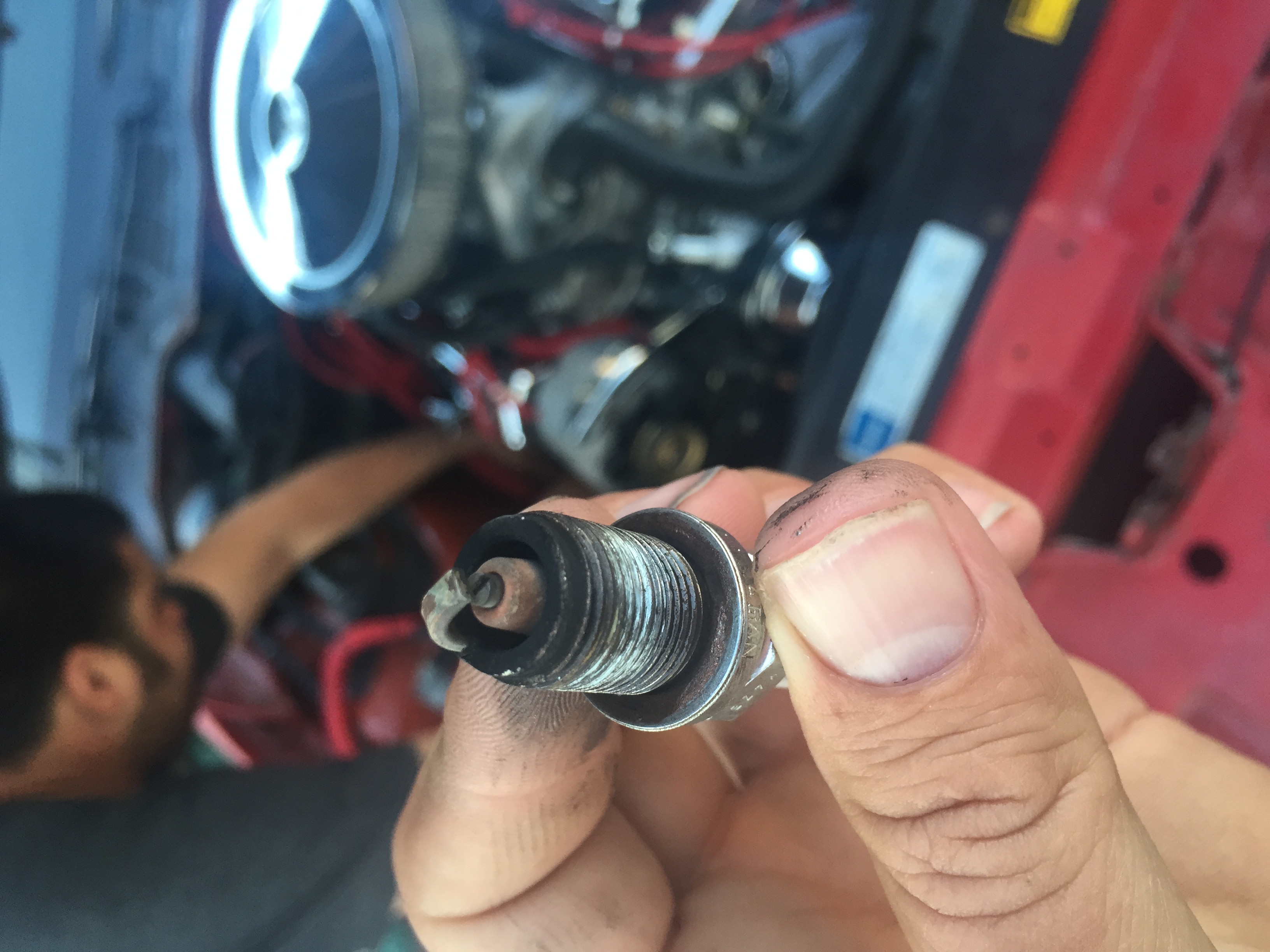

Engine runs strong. here is what the plugs look like. I am thinking it needs a little more fuel and maybe a little less timing. Maybe put the primary back to a 70, leave the secondary alone and maybe pull timing back to 34. I am also on the fence of dropping to one colder plug. What do y'all think.

Cool deal! I'm glad you got it running better. IMHO 1st thing I would do is throw those bosch plugs as far as I could and put Auto lite, AC delco, or NGK V power plugs in it. I have never had good results with bosch plugs. I seen a .2 second slower ET at track with bosch vs auto lite plugs in my own car.
Based on your plug coloring you need more timing. Look at the ground strap where it welds to the base ring threads. Perfect timing would have the carbon mark flush with threads. Higher up the strap = Timing too retarded for engine combo.
Too hard to judge small size from a picture but here's the info.
about 1/16" movement of carbon mark = 1 degree of timing.
So measure from the top of carbon mark on bottom of ground strap to the base thread .. Adjust timing (advance it) based on the 1/16" = 1*
I can not see the top of ground strap too well but it looks like you are getting a color change right in the middle of the bend. If so then plug heat rage is correct.
If color changes closer to the tip end of strap, plug is too cold, if color change closer to the welded on part , plug is too hot.
And jetting is read from the soot on the base ring. 1 full round of light soot would be perfect. It looks like you are too rich for sure

throw a fresh set of plugs in there, those tell me you are pig rich at idle based on all the soot at the base (did you replace the plugs after you adjusted the carb)
to check WOT you want to look for the fuel ring (at the base of the plug's porcelain inside the plug you need a spark plug scope or ear scope to look inside there.
BUT you have a A/F gage I would not bother reading the plugs for fuel.
for a SBC 36 degrees total mechanical advance is about right 99.99 % of the time.

Those heads shouldnt need more than 34-36 deg timing
