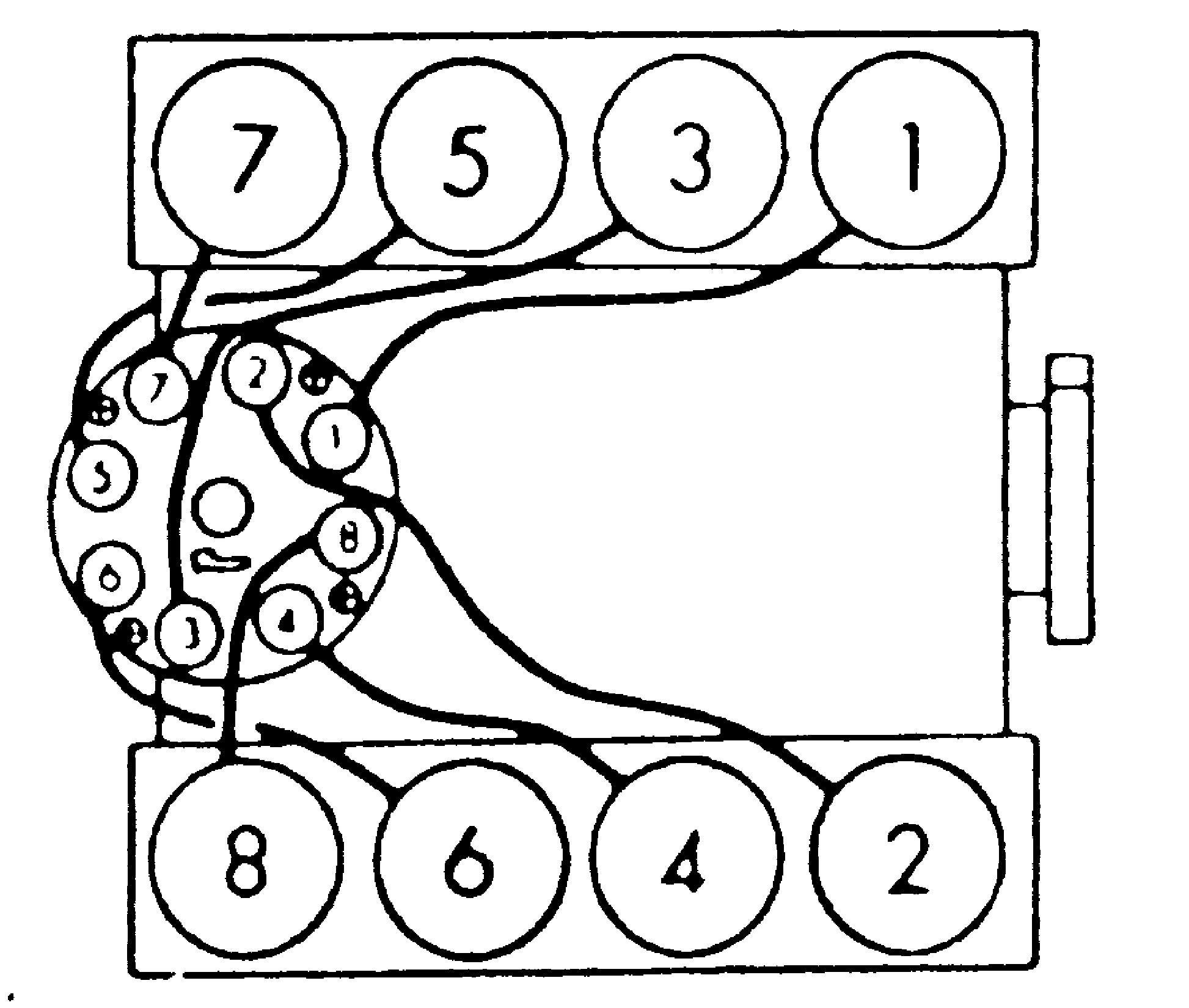

Old Jun 8, 2015 | 03:07 PM
tarouty's Avatar
Joined: Mar 2013
Posts: 32
Re: problem RPM jumping
Thanks for help
the image very excellent its help
But it is difficult to reach the spark from top of the engine
I'll try
