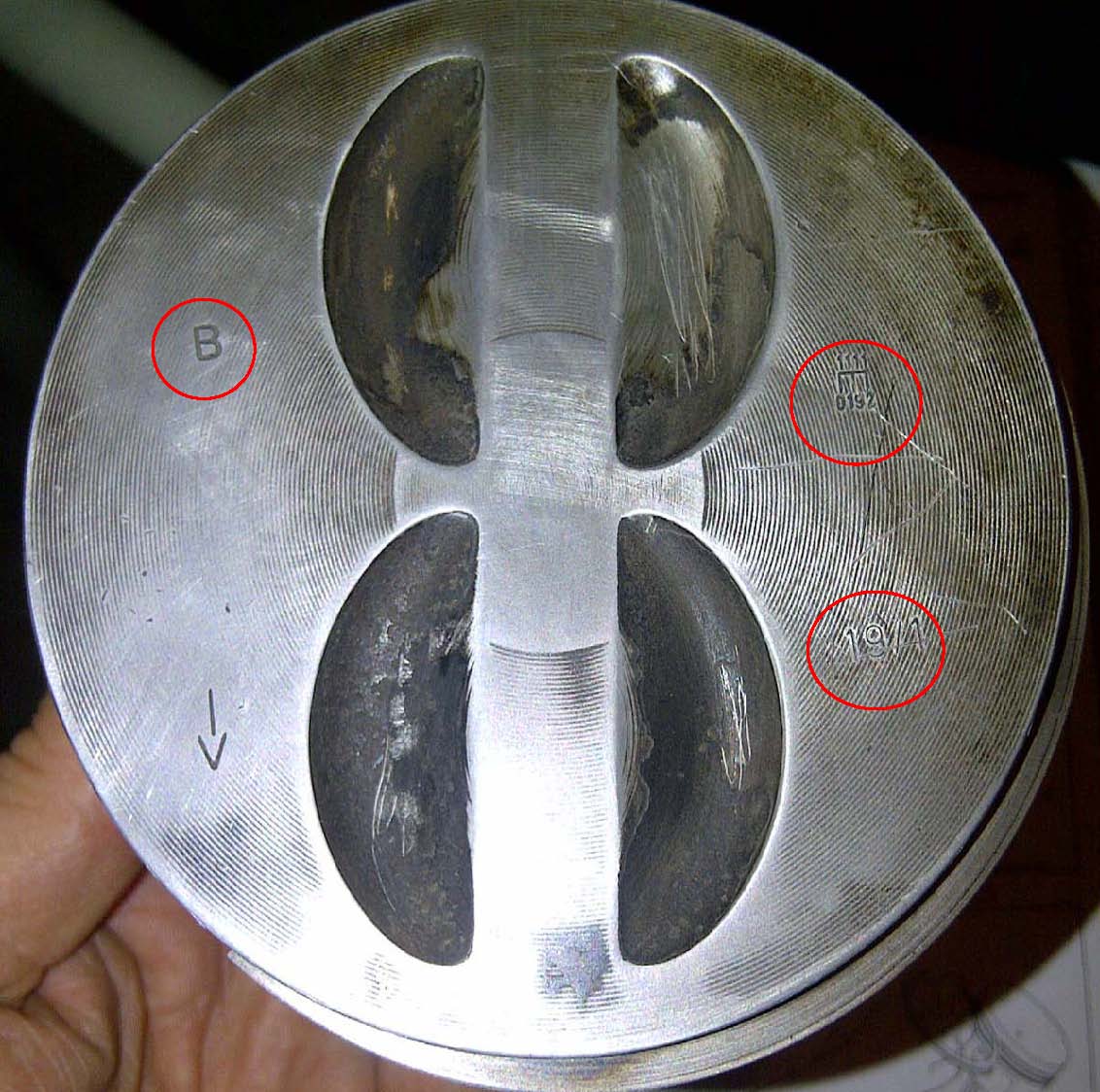

Originally Posted by TTOP350
I would bet money that there is more than 1 piston damaged.
All the other pistons had good compression (150 psi). Even if this does happen to another piston, I had been driving this car with blowby for two years. I'll probably have plenty of time to deal with it if/when it happens. In the mean time, I'm not too excited about dropping a $2000 short block into a car that's probably not even worth $2000.
My PCV systme is fine.
A few yrs ago, I pulled apart a Paxton supercharged 350 tpi motor. It ran smooth a silk but 2 cyls were way down on compression and the rest were fine. Had a blown head gasket and broken ringlands on 6 of the other pistons.

I think the damage was probably metal fatigue that started over 20 years ago when I had the Paxton on it. Just got back from the machine shop. He said he thinks he can find a replacement piston, but it's probably not going to be a Mahle.

How do the other 7 look? Can't think of many things more short-sighted than seeing one cyl destroyed that bad, and "fixing that one, but not even looking at the others.
The factory "balances" by accumulating enough similar-weight pistons, similar-weight rods, etc., as they randomly emerge from production; then matching a crank to them. They don't "balance" the same way a machine shop "balances" a single engine.

The other seven look good, but as several here have warned, they may be weakened and fatigued due to things that happened over twenty years ago. The engine seems to be pretty clean. There was hardly any ridge to speak of at the top of the cylinders. Now that I went through the trouble of taking all the pistons out, I'm planning on replacing the whole set with new rings and probably new bearings. I do appreciate all the advice.
And when your finished putting it all back together you'll have an engine done right , and hopefully 200K or more miles for it to go .
