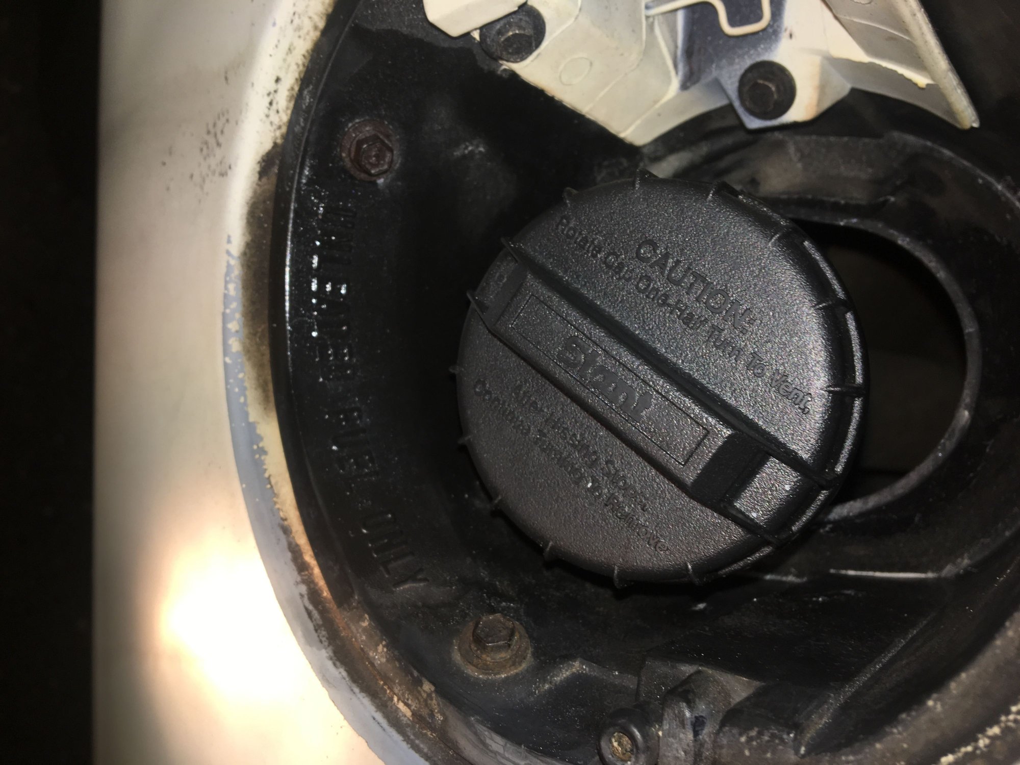

Hey everone, I have a 1989 iroc 5.0 TPI and I've been have this issue since I had the fuel pump replaced about 3 years ago. It wasn't bad 3 years ago when the fuel pump was replaced but now it is significantly worse. I tried 3 seperate gascaps and none of them make a difference. I'd say I get around 8-9mpg now and the car idles rough around 5-600 RPM, sometimes it'll Idle around 1000 and drop back down. There is a strong smell of gas from the rear of the vehicle considering everytime I drive it some gas will pool up in the gas cap door. I honestly do not know much about the fuel or evap systems so I have no idea where to begin. Any advice or help would be really appreciated, thank you!

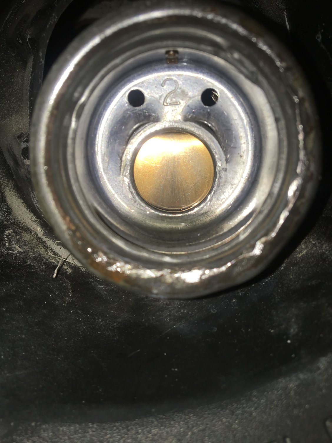

So the vent valve is fine, had some nice weather over the weekend which was nice. The valve was surprisingly held to the clip by two zip ties and the plastice at the top was cracked, but it still worked so that was nice. Tonight I'll check the vaccum hoses. With the canister though, how will I know if it's bad? Are there any tell tale signs?

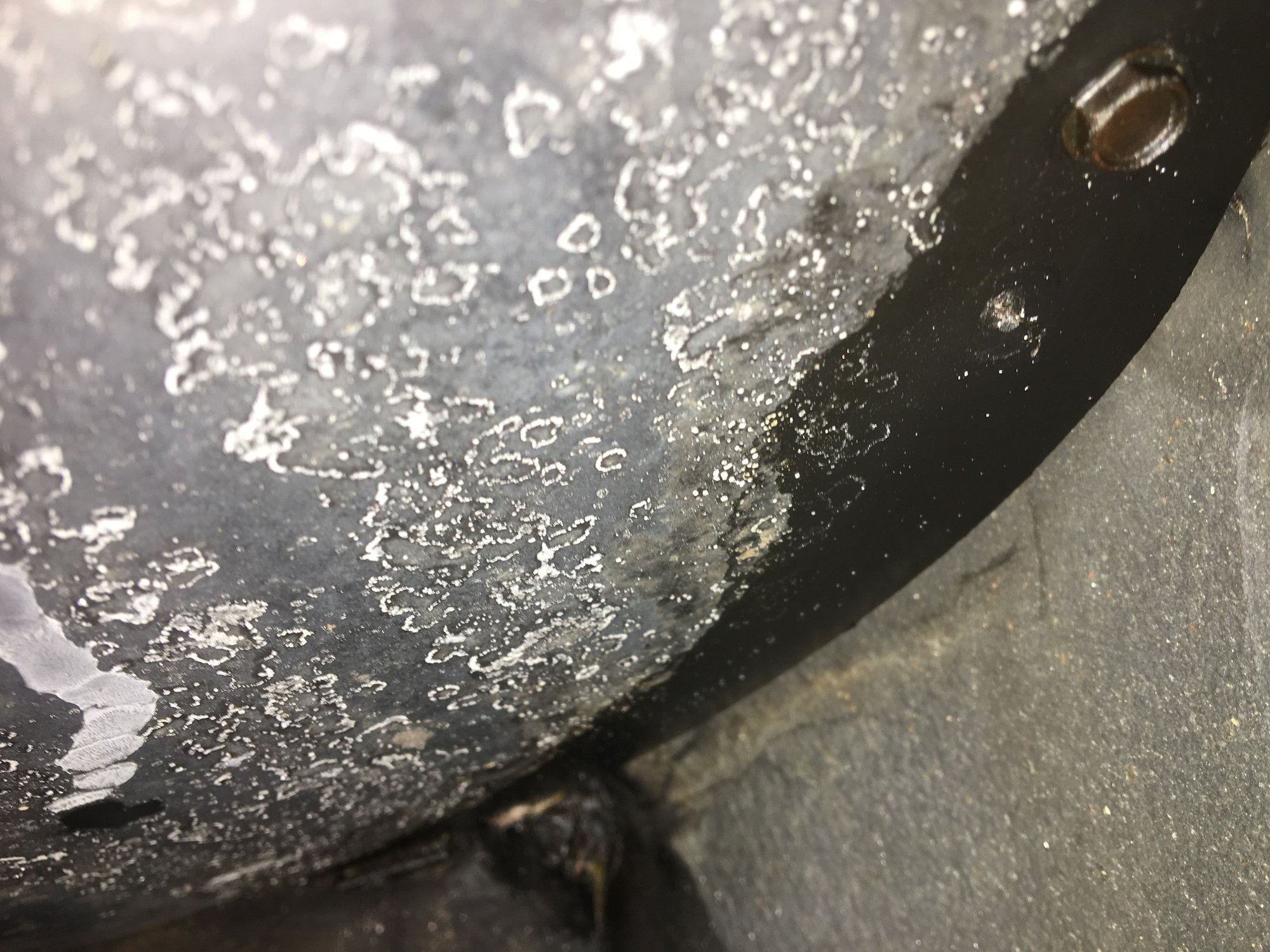

I think the issue might be with the lip of the fill neck.
Old Jan 16, 2020 | 09:05 PM
Posts: 27,995
Likes: 2,485
Re: Poor Mileage, Gas At Cap Fill Door
Yeah sometimes it's the obvious things...

Any Idea on to how to go about fixing that without replacing the neck? Was thinking about seeing if I can get underneath it with a small punch to try to get it out. I also know that JB sells gas tank repair kits, maybe using the epoxy from that to fill the dent.
