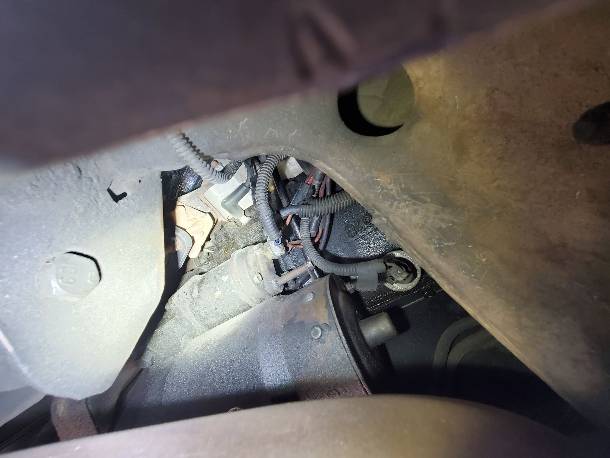

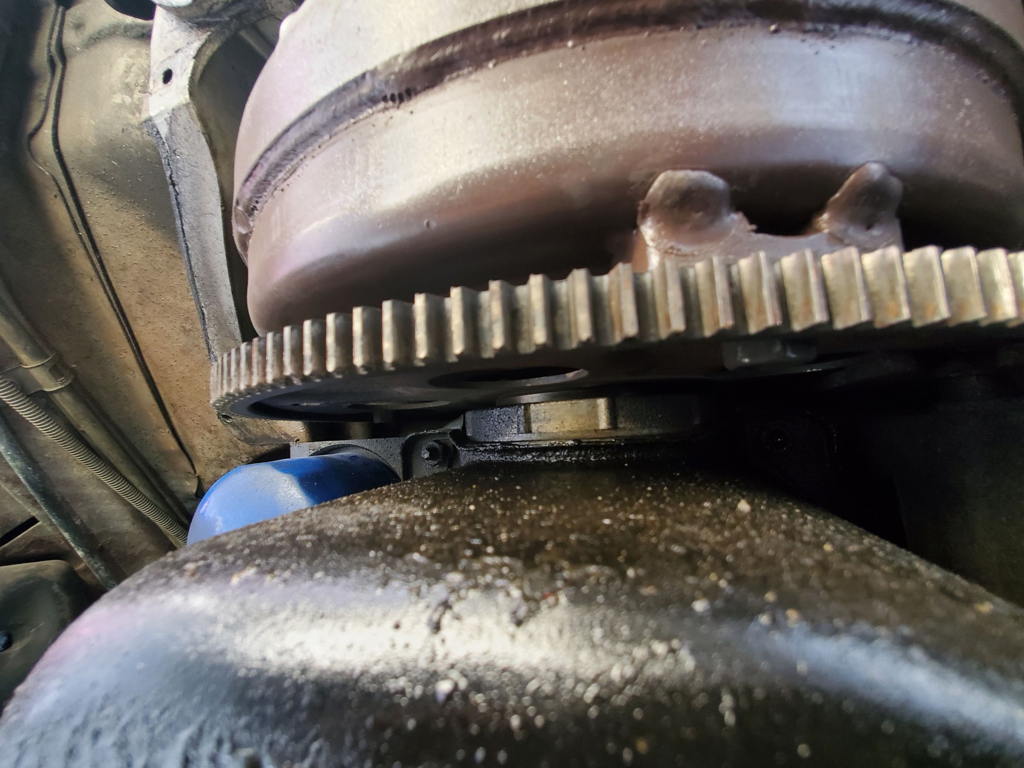

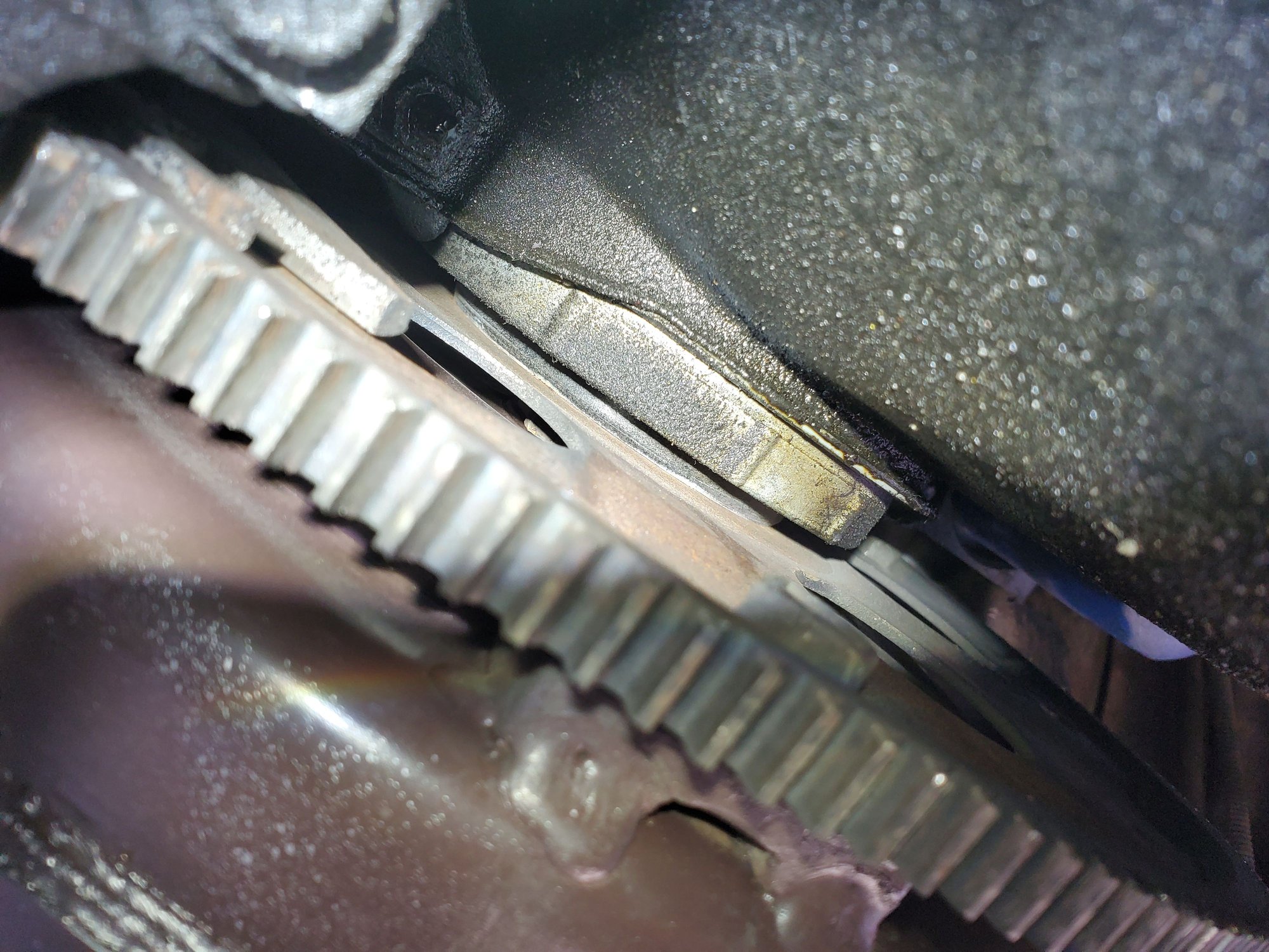

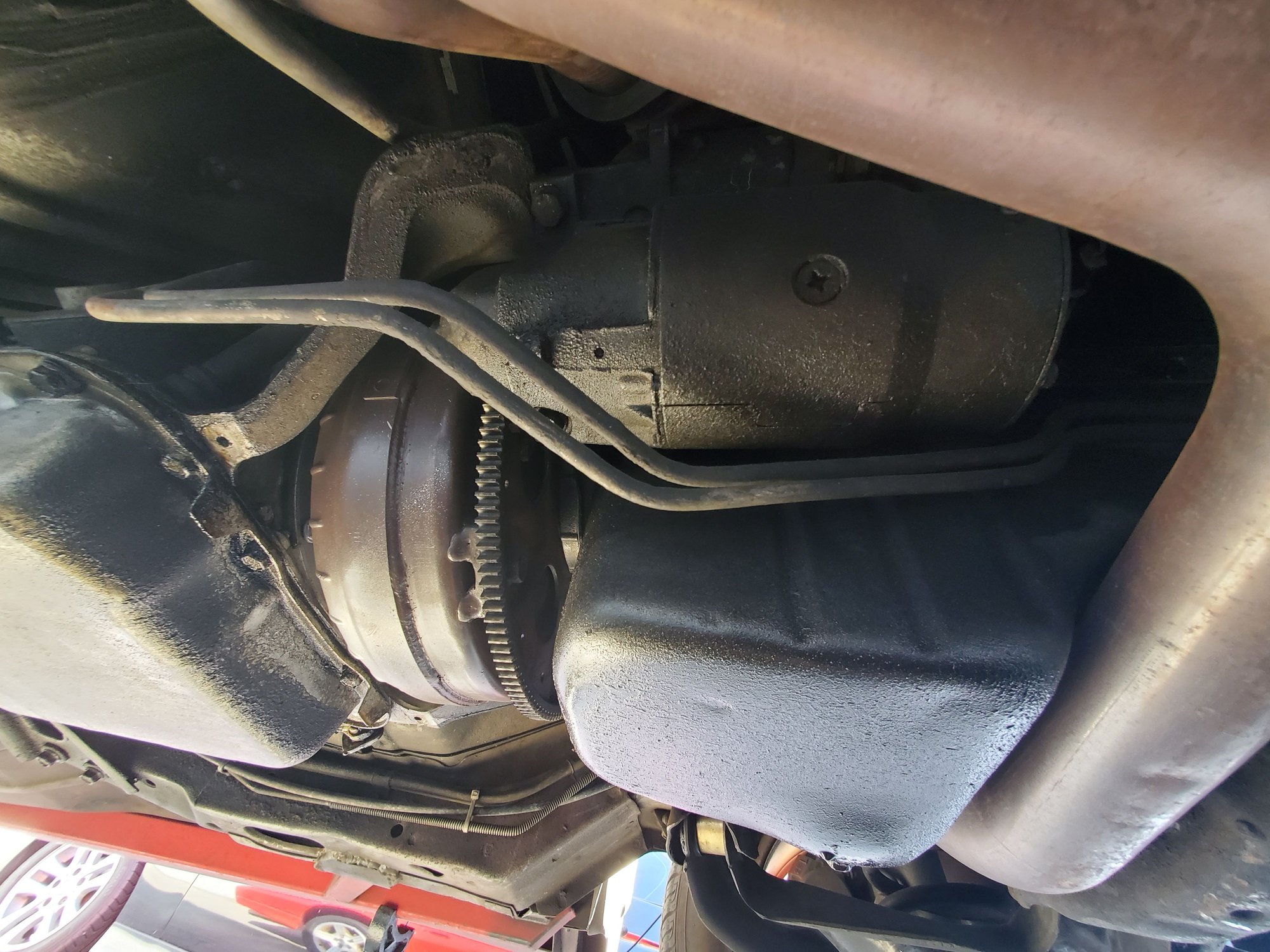

Does this look like a rear main seal leak??
1989 5.7 TPI
Tracing an oil leak the car doesnt get driven much and sits in a garage. But it has had an oil leak since I can remember. The starter is covered in oil and so is the oil pan and tranny. I took the converter cover to take a look at the rear main but cant tell if thas the source of the leak. Driver side engine block looks pretty dry. Passenger side towards the rear not so much. Ive read the dipstick may leak, I can move the dipstick tube in and out of the engine block with no effort, is that normal?

Probably not the rear main seal.
No it is not normal for the dipstick tube to be loose.
It would be easier to spot the source of the leak if you took that to the quarter car wash and cleaned it up first.

The rear main and rear of the pan gasket don't look too bad, they're not dripping, which usually if they were leaking more than normal i'd expect a visible drip. The oily mess seems to extend forward on the block, so look further forward. Check the front cover seal around the balancer, for example. Check the intake gaskets. Visually poke around until you see the obvious AH HA! source of the leak.
The dipstick tube shouldn't move because it should be bolted under one of the exhaust bolts with a welded tab that keeps it from coming out. IF the bolt is there, and you can pull the tube out, that'd be bad. If you don't see a visual indicator of lots of oil around the dipstick tube to pan connection, it's probably not the source of your leak.
Think of it this way, compared to a pre-86 SBC, that's not even a leak. It's insignificant from that viewpoint.

cleaning the underside
Quarter car wash. Pick up acoupla cans of "engine degreaser" on your way; soak everything with that real good; then blast it off with the high pressure. Being careful of course around electrical things.
