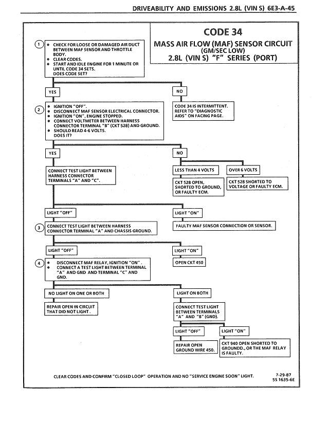

Today I followed TP's flowchart for code 33. I hook up the fused jumper to the fuel pump and it runs, but it sounds like there is a hiss/whooshing at the engine almost as if it's leaking into the cylinder or something? But don't see or smell any gas. Is it supposed to sound like that? Continued the chart and test MAF harness E(red) to ground and no light. Test both the orange(red?) and tan wires at the relay and both light on. And then I got confused at "Probe blk wire to MAF term "B" with a test light to 12V". I tested both the solid black and black/white strip to the battery with no light. Is that the correct way?
Then I jumped into code 34. Cleared codes (ground disconnected from battery for at least 30 seconds) and ran until SES came up. Checked codes and both 33 and 34 still there. According to the 34 flow chart, how could there not be a code 12? Isn't that part of the diagnostic series? But because the code 33 was still there does that mean the MAF is still bad even though in testing 33 the chart says it's either open ground or bad relay.
EDIT: And now I'm all of a sudden wondering if the flow charts are different from year to year. I pulled the ones I used from other threads but they they weren't likely for an 89. Hmmm. Where can the flowcharts be found?
I'm just curious here , are you saying the code flash sequence doesn't start out with code 12 three times , and then followed by the rest of the codes , but instead just starts right out with code 33 (or 34) without first beginning with code 12 ?
If so , I don't believe that's proper , everything I've ever read says the sequence begins with 12 ....
My sequence starts with 12, as expected, but the 34 flow chart has a branch that has "No code 12" as a path. Which seems odd.

Minor update: I swapped out the fuel and burnoff relays with each other, as I've read others have done, and the code 33 went away. Repeated the code 34 flowchart, http://www.chevythunder.com/maf_code_34.htm, and ended up at the "No code 12" but I still had the 12 and 34 codes. And following the chart as if there was "no code 12" I have no dark green wire to check for short to ground in MAF signal wire. Suggestions?
I believe the difference is because those are diagrams for 8 cylinder cars , and your working on a 2.8 V6 . If you look at the wiring diagrams associated with that V8 diagnostic flow chart the 1989 one shows the MAF Burnoff Relay that your 2.8 V6 doesn't have , your only MAF relay being the MAF power relay located next to the radiator . (If you swapped a relay with what you thought was a MAF burnoff relay , it wasn't a burnoff relay but instead likely the radiator fan relay or perhaps the fuel pump relay if you swapped one from next to the brake booster) . With such differences in the systems V8 VS V6 I think you'd be better served to find a troubleshooting chart specifically for the V6 . Remember , the different engine type equipped cars have different relay locations , your relays next to the brake booster being the A/C cutout relay , the fuel pump relay , and the radiator fan relay . V8 cars do indeed have MAF relays in that location , hence the need for only using V6 specific information if a proper diagnosis is ever to be made .
Here is your 1989 2.8 V6 wiring diagram , with the MAF circuit shown having a single power relay only .....
Thanks for that chart. I have also found a flowchart for code 34 for a '88 2.8L. So I hope that is close enough. I'll give it a go tomorrow and check back in.

So I found the same wiring chart as you posted in my Chiltons, and it's wrong on wire colors. But I also found that, according to my Chiltons, that my engine compartment is set up like the 85-87 2.8L component locations. The code flow chart for 88 2.8L seems pretty spot on. Using my multimeter in the Continuity setting as the test light. Worked through things until I got to step 4. E(brown) and ground was closed but A(orange black) and ground were not. And this is where I'm scratching my head. If A just runs between the sensor and relay, how could it be closed to ground? As well both ends of A have continuity with itself. I really hope I'm doing something wrong as this doesn't seem to make sense.
