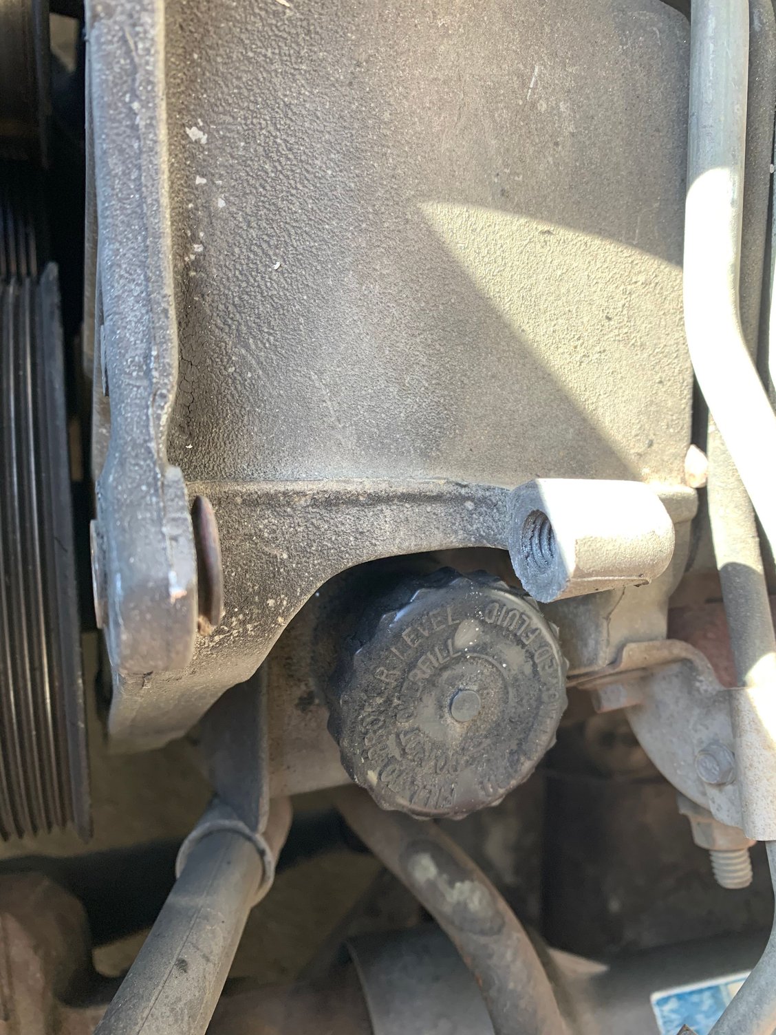

Seems like it would be fairly simple to measure what you need and just order a pack from some place like this. https://www.mcmaster.com/screws/roun...d-head-screws/
Thanks, I’ll check out the site. Here is a picture just in case anyone is curious. GM listed it as a generator mounting bolt.
