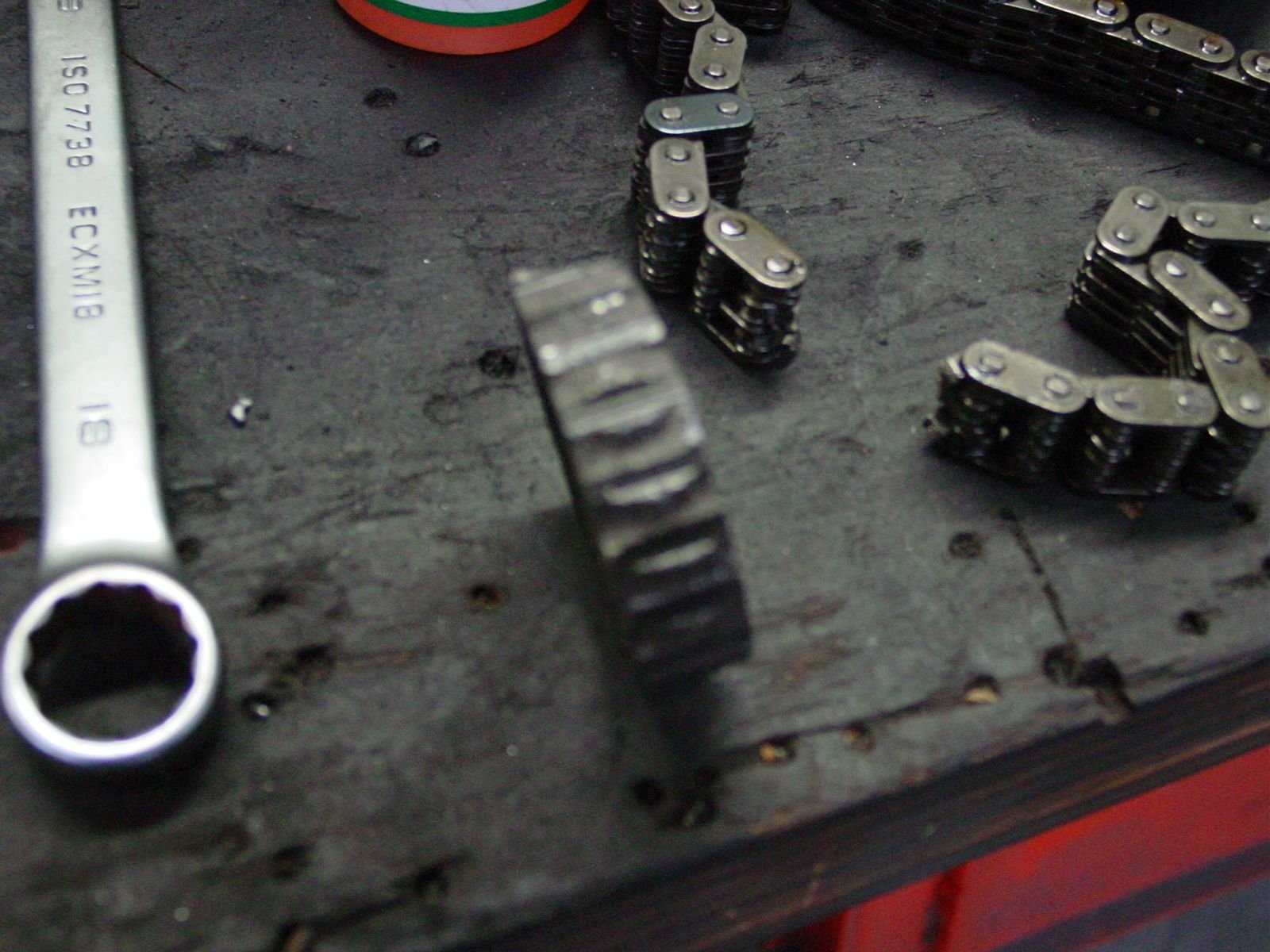

Old May 12, 2020 | 06:33 AM
J.C. Denton's Avatar
Joined: May 2008
Posts: 417
Likes: 82
From: Viersen, Germany
Car: 85 Iron Duke, 88 GTA and 92 TA
Re: Cross threaded crank
Originally Posted by Sling Meister
I bought a new Timing set do I honestly need to put the new lower gear on or can I just use the old one and just skip having to take it off
Well... You should DEFINITELY replace it.. Just sayin'...
