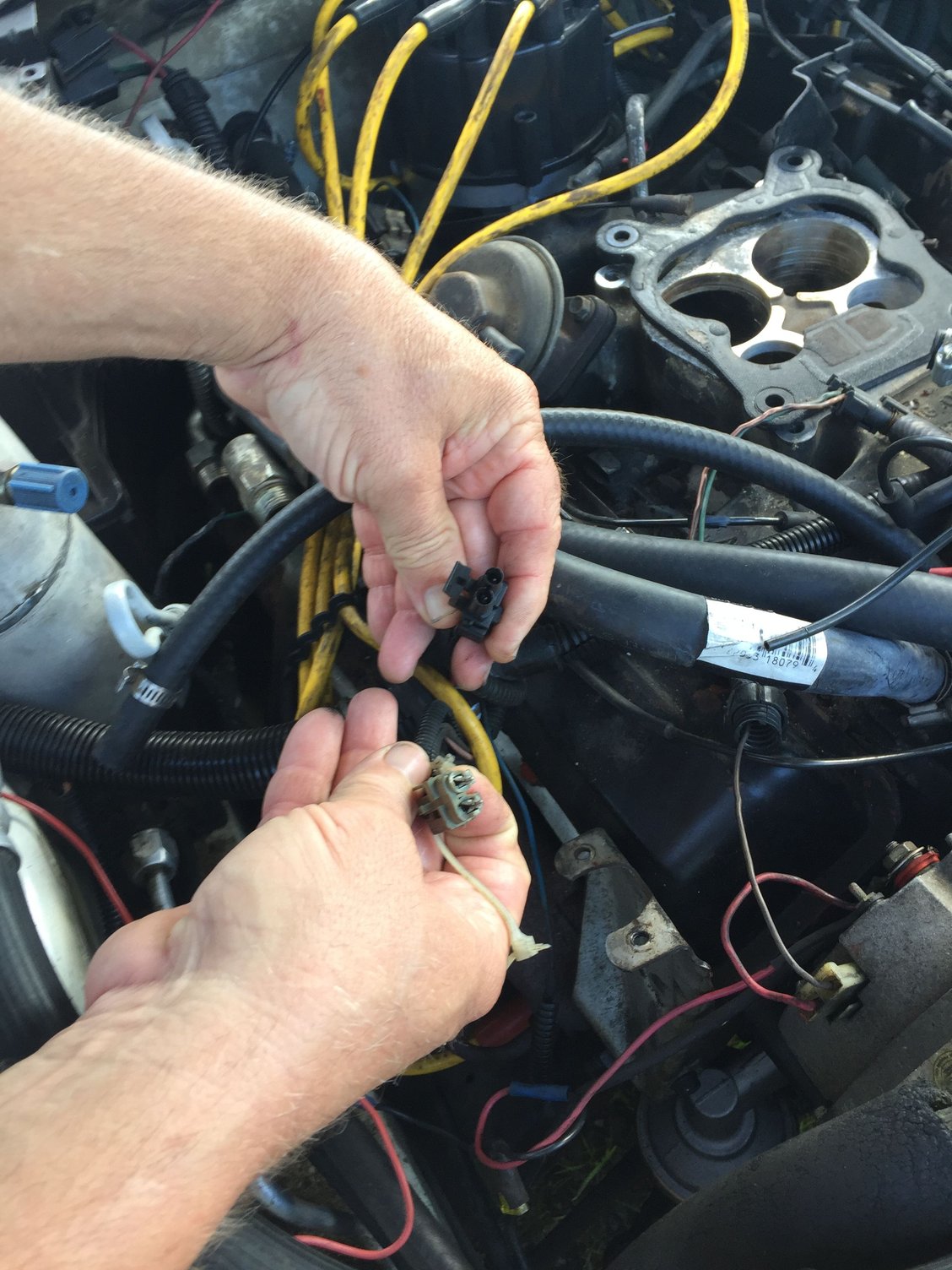

Ok so what did you do with these plugs that are left and what exactly are they ?
Old Aug 23, 2020 | 06:56 PM
NoEmissions84TA's Avatar
Joined: Feb 2017
Posts: 4,185
Likes: 576
From: Meriden, CT 06451
Re: 1984 Trans Am smog delete
Those are for the air diverter valves.
DON'T CUT THE WIRES. You might regret it later. Or the next owner might.
Put some dielectric grease on/inside the terminals to protect them from corrosion and roll any unused wires up neatly. Use ty-raps to secure and tuck them away in an inconspicuous area. You might even want to slide the whole bundle into a plastic bag before you tuck them away.
Correct. I disconnected and kept everything just in case.
