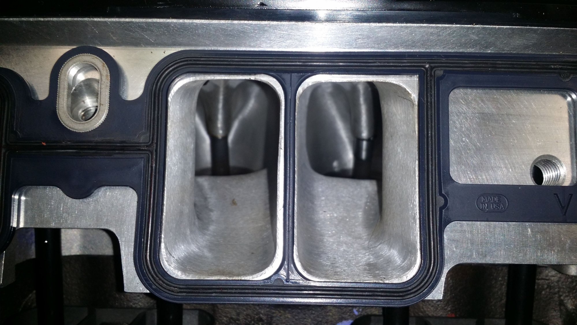

Wouldn't exactly call the truck intake lousy it outflows a factory TPI base in stock form and I am working on a ~500 hp 383 build running one. The truck intake has a very thick casting and a ton of room to grow port wise. I am over 300 cfm on my ported truck base and it was over 250 to start with. I was easily able to open up the truck intake enough to match the 210cc ports on my heads. Was not quite done with it in that picture but you get the idea. Stock truck base with no porting can support ~400 hp. The same cannot be said for TPI.
I stand corrected.
