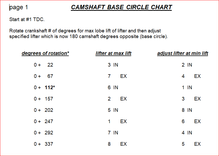

I created this chart from my SBC using a Crane CompuCam 2050. I took the numbers off of the degree wheel attached to the crank.

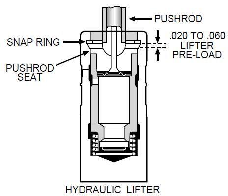

Zero lash means that the pushrod seat is still up against the snap ring / retainer with all vertical clearance removed. As soon as the the seat is no longer in contact with the snap ring, you are in the "lash zone". That clearance is the preload you are adjusting for by turning the rocker's adjusting nut down your additional 1/4 to 3/4 turn.
