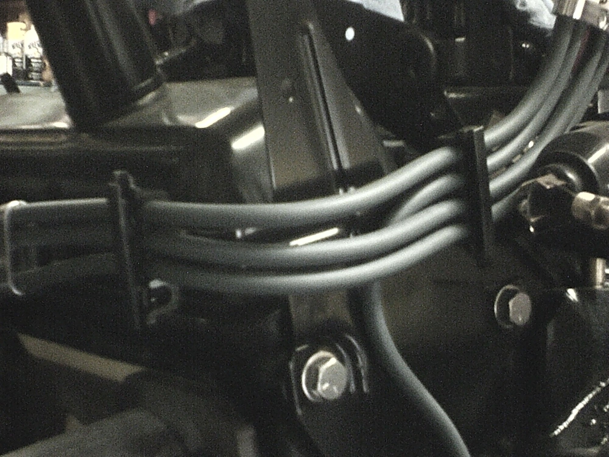

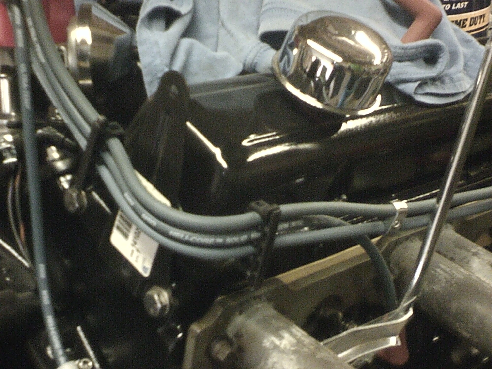

I was wrong about the plug wires running under the manifolds on my 95 GMC truck. They run around the back of the valve cover retained in these cool brackets, and then along the lower side of the valve covers.
This is my 334 SBC that I plan to get back in my 84 TA......... someday. I hope these wire retainers work and don't interfere with the firewall.
