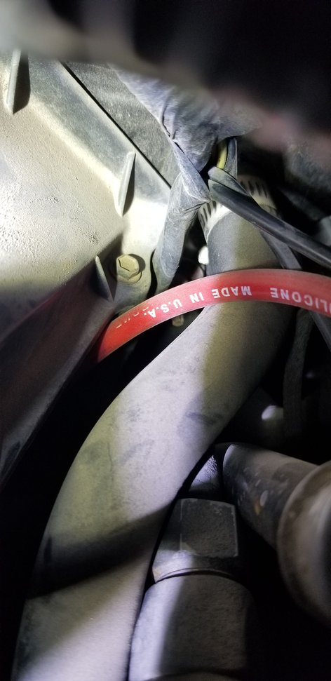

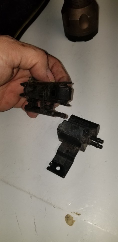

Ok I found the solenoid (it was sitting under the distributor against the engine) and I happen to pull one from a scrap yard with pigtail. Will this work for the tpi? It was off a 92 tbi

If normally closed should work

Should be sandwiched between the coil bracket if you had the right bracket/solenoid.

The one I picked up has a bracket so hopefully it'll be useful then all I need is new vacuum lines
