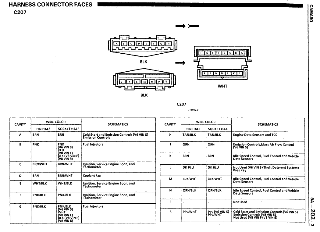

Check c207 for injector power. Straight run from there to the injectors through the fender pass through wires.
The c207 harness connects to the ecm correct??
yes it has ecm accessory power, injector power ecm. Kinda a clear color connector.
Ok, I found it.. What do I have to test on it?!?! and how?!?!

http://www.austinthirdgen.org/mkport..._1989_C207.gif
check to see if you have injector power at the c207 condition
Found it.. how do i test it?!?! I have a multimeter.. What am i looking for and what wires?!?!

How would I test the harness with a multimeter???
