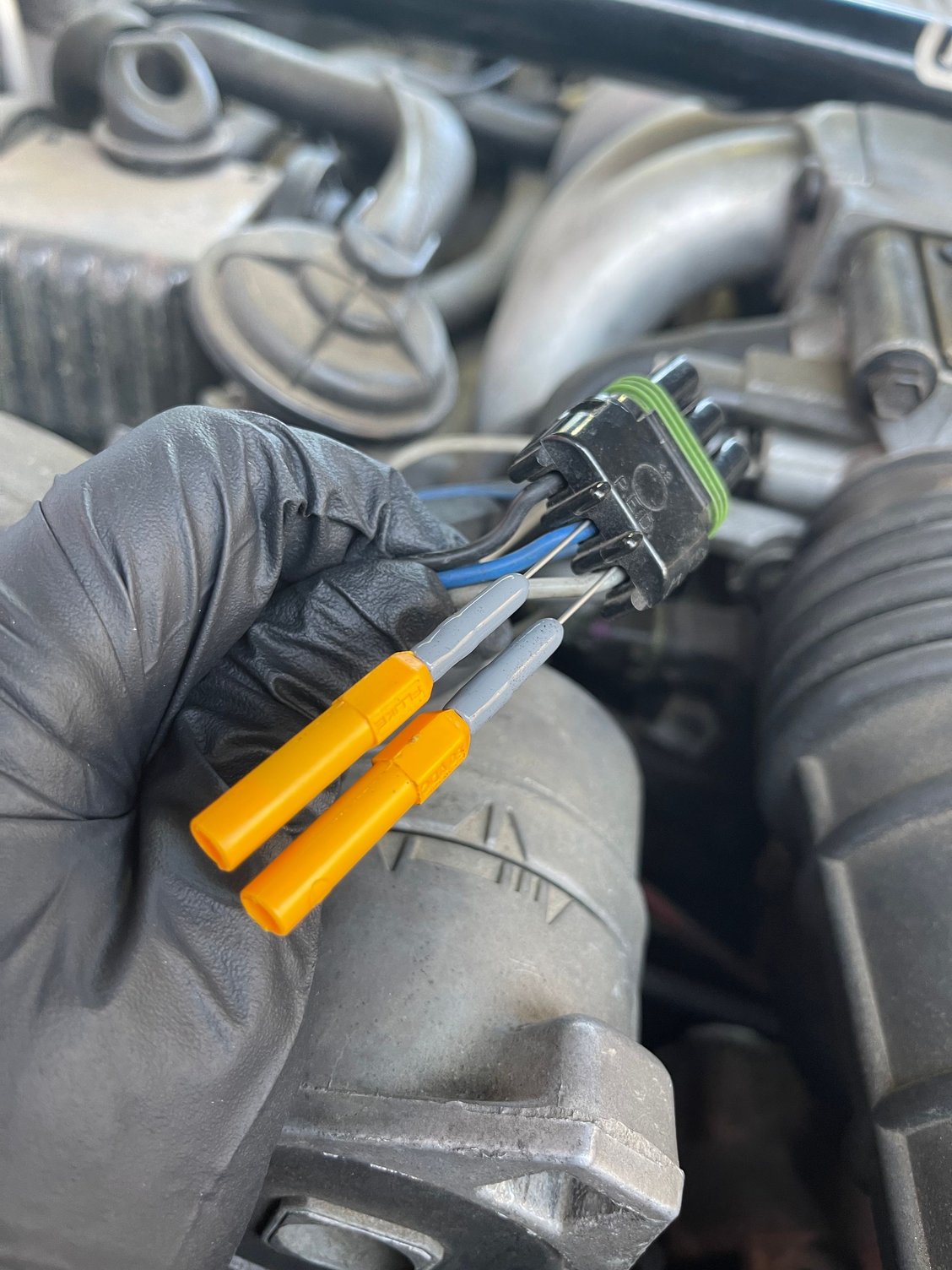

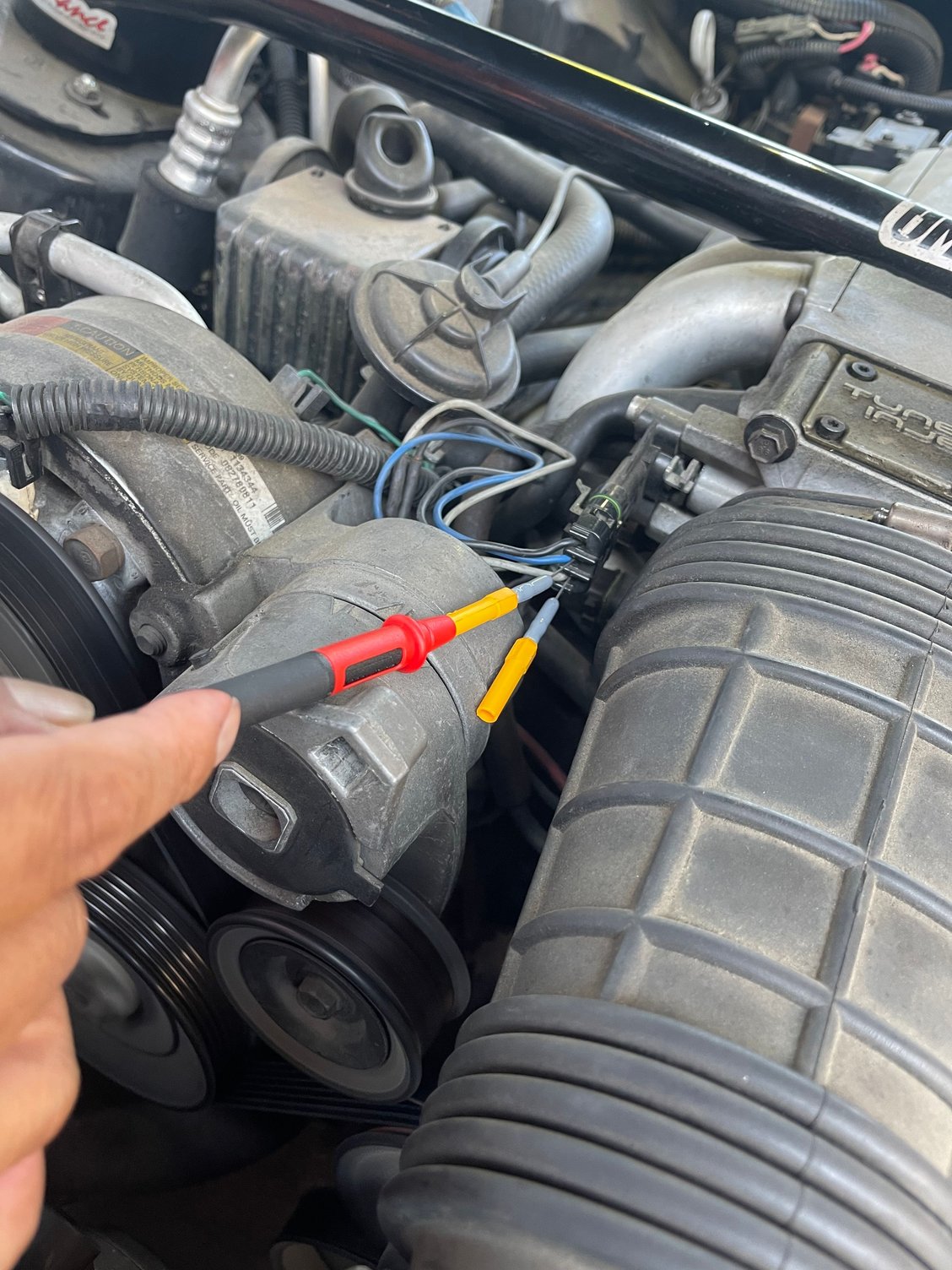

Backprobe the blue wire at the tps. It might be non adjustable but should be .67-.75 idle and increase when throttle opens wot 4.5v. Grey wire to tps is a 5v reference.

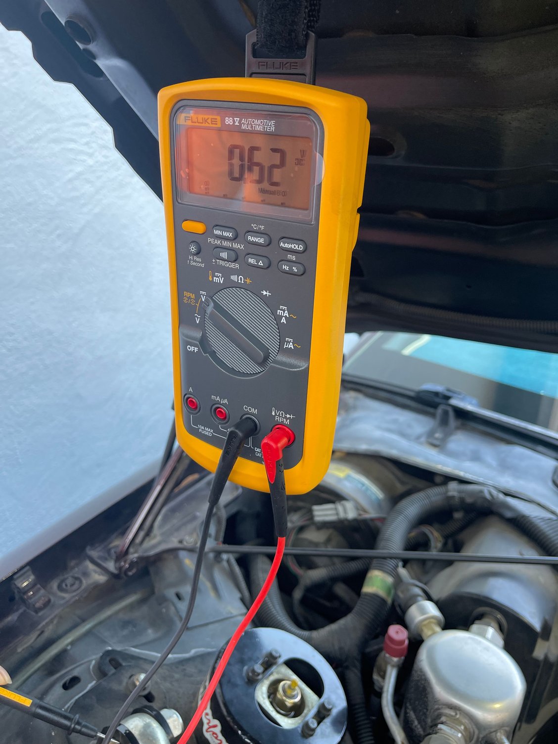

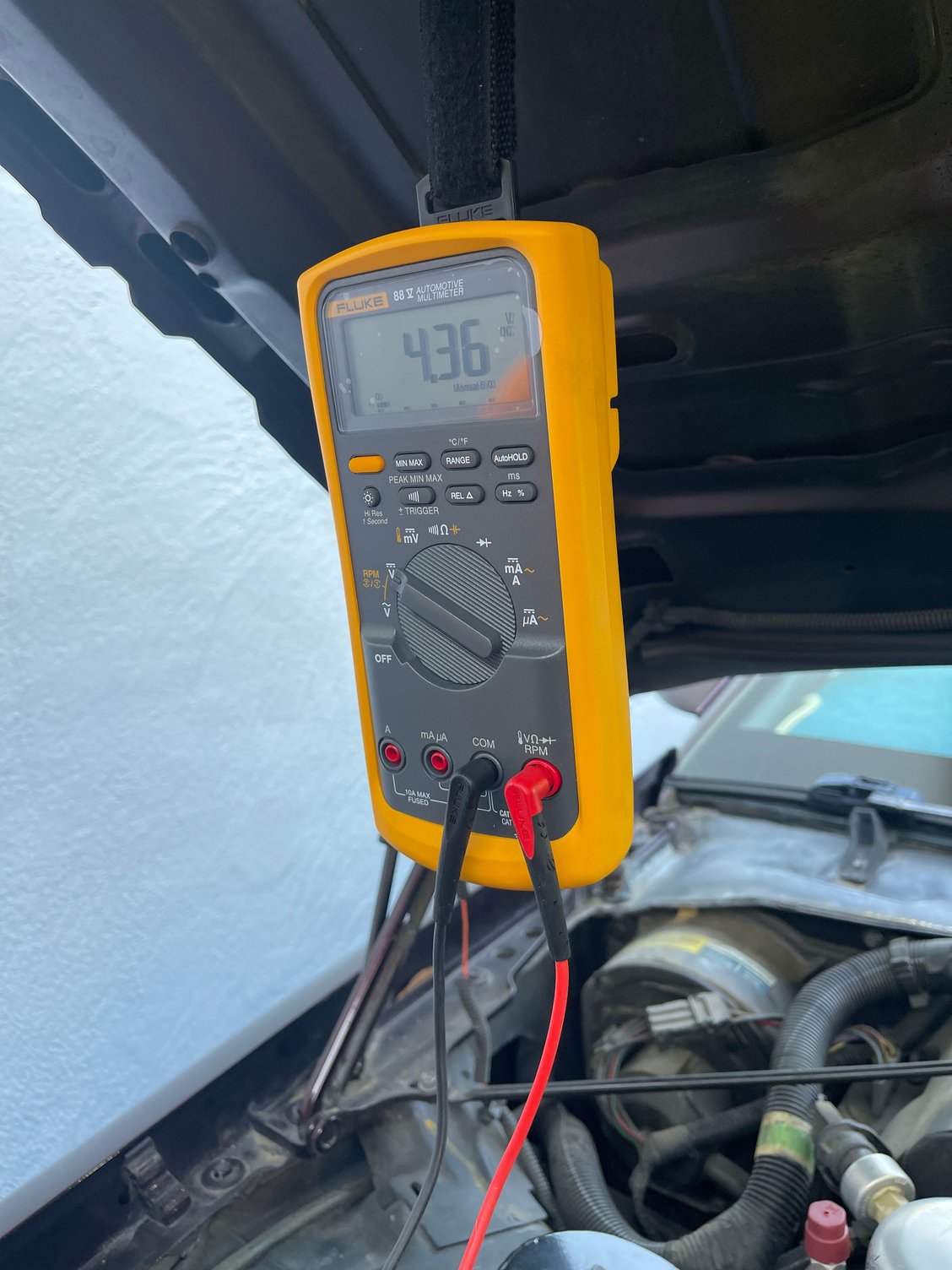

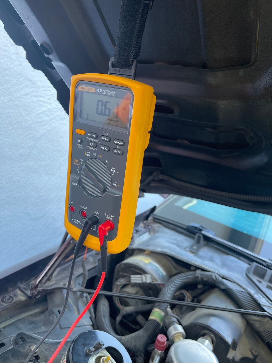

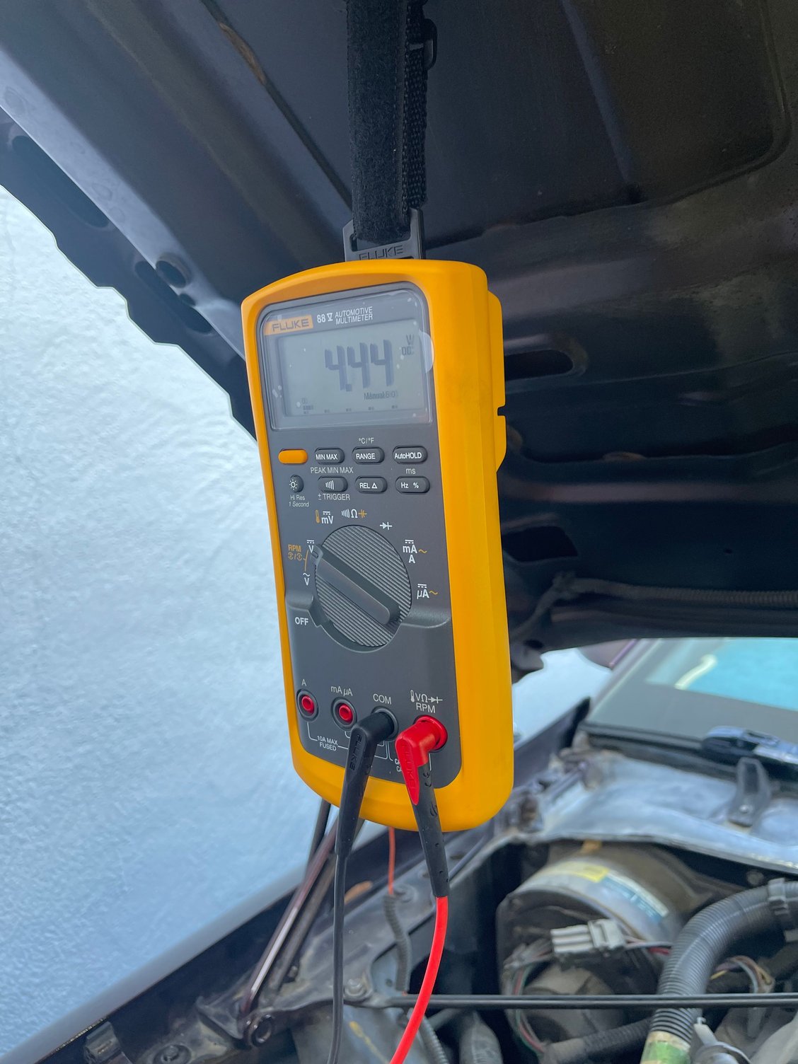

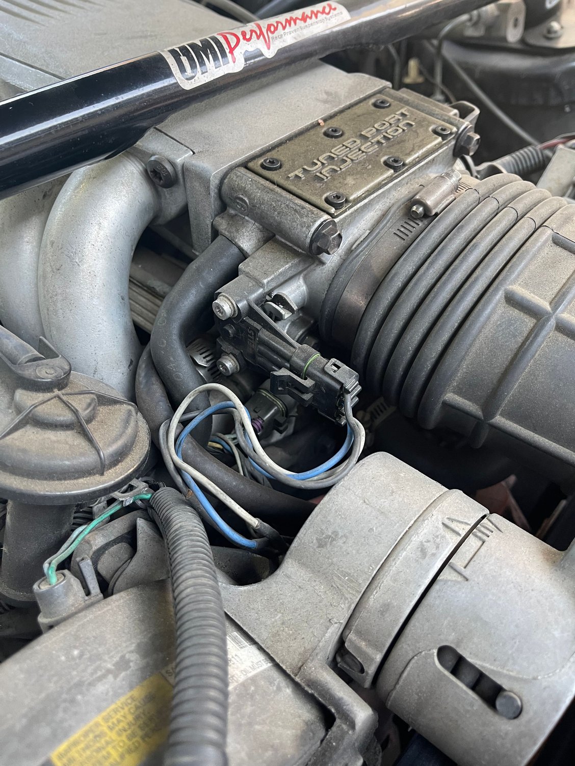

so here were my results i took pics since it was my first time using my dmm
reference 5v wire
idle throttle
idle throttle
wide open throttle
wide open throttle

Are you checking the tps ground ?

when i checked the idle by directly putting the leads on the ground and the signal wire , i got 0.59 at idle and 4.45 at wot, compared to the 0.61 idle and 4.44 connecting the ground lead to frame of car. Did i measure the ground wire correctly?

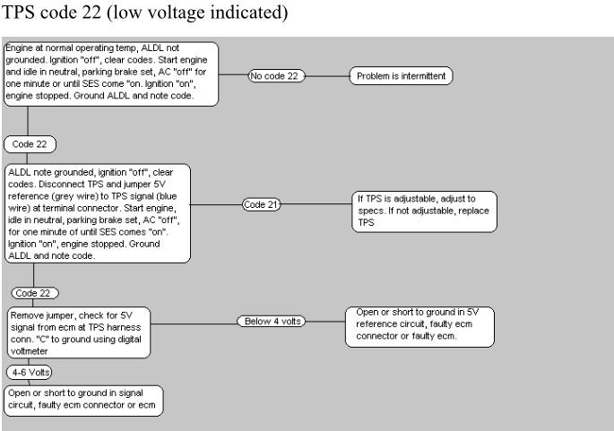

Yes you measured correctly. Might clear the codes and see if 22 comes back.
just remembered tps ground shared with mat so I don’t think it’s a ground issue might effect both sensors.
might try this trouble tree

What is the ALDL?

It’s the connector under the dash drivers side knee level.
