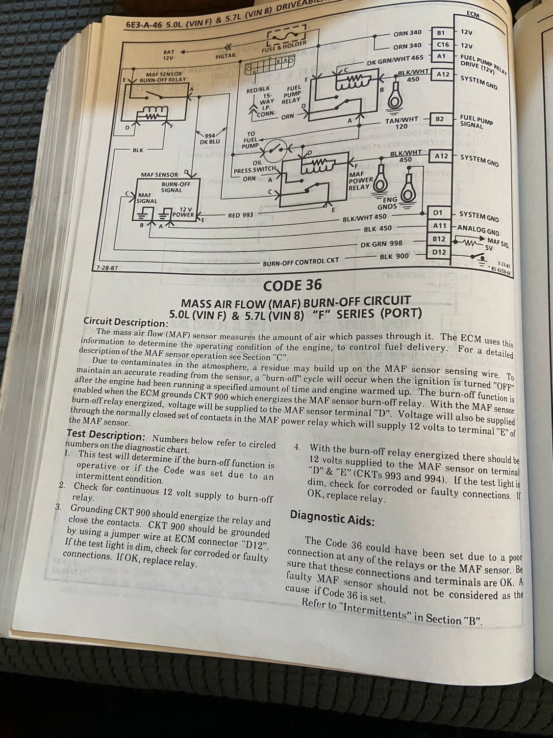

As you saw in that linked thread your car might not like the Delphi MAF, it seems some do and others not so much. If you have a shot at a legit NOS Bosch that’s not a reman for $200 I would get it, as you know they are tough to find and you could get your money back reselling IMO if you don’t need it.

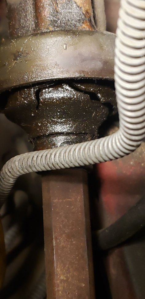

In other news, what is this? What am I looking at here? How dangerous? How easy to replace?

The top pic is the rag joint for your steering shaft, does the steering wheel have a lot of play in it? They are pretty easy to replace and some guys go to the Astro van or Jeep steering shaft as a possible upgrade to limit play and give more responsive steering. Some claim that this increases noise so do research if you want to go that route. I would replace it sooner than later.
The bottom pic looks like one of the wires for the blower motor if I’m not mistaken. Yours isn’t terrible, there is usually a bigger connector near there that melts completely like on my car.

Well I was planning on doing an entire front end upgrade this winter, so I will add that to the list.
Not a lot of play currently, but im only going to be driving the car until right before the first snow. I reckon just another few weeks.

So I got the new wires + cap and rotor put on, they look great, and I do believe this helped smooth things out a bit. While under the car, it became apparent that my Cylinder 8 Spark plug was loose, with a bit of burning around the outside. I tightened her up and she's nice and snug now.
I took the time to replace my IAC as well, here something else became apparent, it seems that I may not have had the first unit tightened down all the way to the gasket. Finding a proper tool to tighten this was a bit of burden, very small space to work, and none of my wrenches or sockets were big enough.
However after checking a few times, I believe I've created a better seal, and that this had helped. I disconnected the EST and redid the timing, I also went ahead and attempted adjusting my idle. The car, to my surprise was idling at around 450 immediately after beginning the resetting process with the IAC disconnected. There must have been a bit of a vacuum leak with the previous IAC.
This brings me to my next frustration. The "NOS" Bosch unit I received almost immediately began throwing the dreaded code 36. The Delphi unit didn't throw this code once for the last few months I had it installed. I am going to go ahead and try a different relay, although I am almost certain the problem is the MAF itself.
This is annoying to me because the readings coming from this MAF are in line with what they should be. However I can not deal with this code, and if the relay doesn't work, I'll be stuck with an expensive paper weight.
From my small test drive, the BLM and INT seem to be trying moreso to be in line with what they should be, though I haven't been able to take it for a 20Min+ drive yet to relearn the ECM.
So that is where I am right now. My new Ujoint came in, and hopefully I can get this reinstalled over the next few days. I temporarily put in my Steel Driveshaft so I could move the car around.
I will let yall know how the Relay goes, and I will likely be back to solve any further issues within fuel trims.

A large crescent wrench worked for me to remove the IAC but it’s much easier with the TB off the plenum, was one of the primary reasons I did the TB coolant bypass to make removal much easier. There is also a special socket available if you look around, usually can be had on eBay. OTC and Kent Moore made them at one time.
Your old relay might just be shot, the Delphi doesn’t utilize the burn off function because of the non hot wire design so I wonder if that is why the code came up now? I would just replace both MAF relays and check the wiring/connectors.
The FSM clearly states a defective MAF sensor should not be considered for code 36. Sometimes this is a sign the ECM is on its way out too from what I’ve seen and what the FSM said but I doubt this in your case.

I did just put two new relays in last summer, however I am willing to try them again.
I've read a lot of conflicting things regarding these relays, I just want to make sure I get the right ones. Incredibly confusing. I've read that PN 14089936 would work for both the Power and Burnoff.
The two I bought last summer were PN 158240 which claimed to be the MAF Power Relay, these two are apparently the same part.
I'm going to see if I can find a NOS one, without the MADE IN CHINA statement glaring back at me.

So inside my slip yoke I found a bunch of rust at the bottom. I poured some apple cider vinegar in there, I'm gonna see if I can let it sit overnight and scrape out the majority of the rust.
It must have been in there a while, and I never noticed it, a bit unfortunate, hopefully no damage is caused.
In other news, I tried an alternative relay I had sitting around. It definitely clicks on shutdown, I still have one coming in that is apparently NOS.
I can't imagine the connections are bad, and I have to believe that it is the MAF itself causing the issue. Much a disappointment, as again, it seems to be getting closer to where I want this car to be.
I have not wanted to drive it with this code, so I am going to switch in the delphi tomorrow (later today) to alleviate the code. I know you mentioned that the Delphi doesn't use burnoff, but wouldn't the code still be set if it was a relay or ecm issue?
