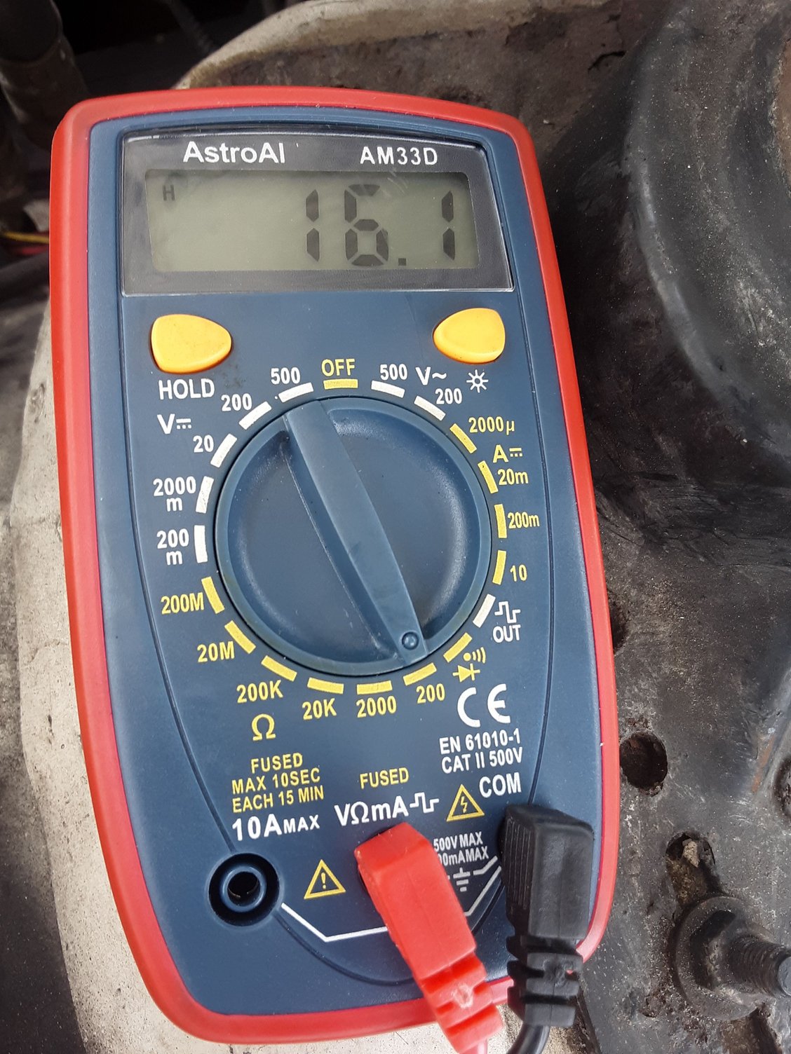

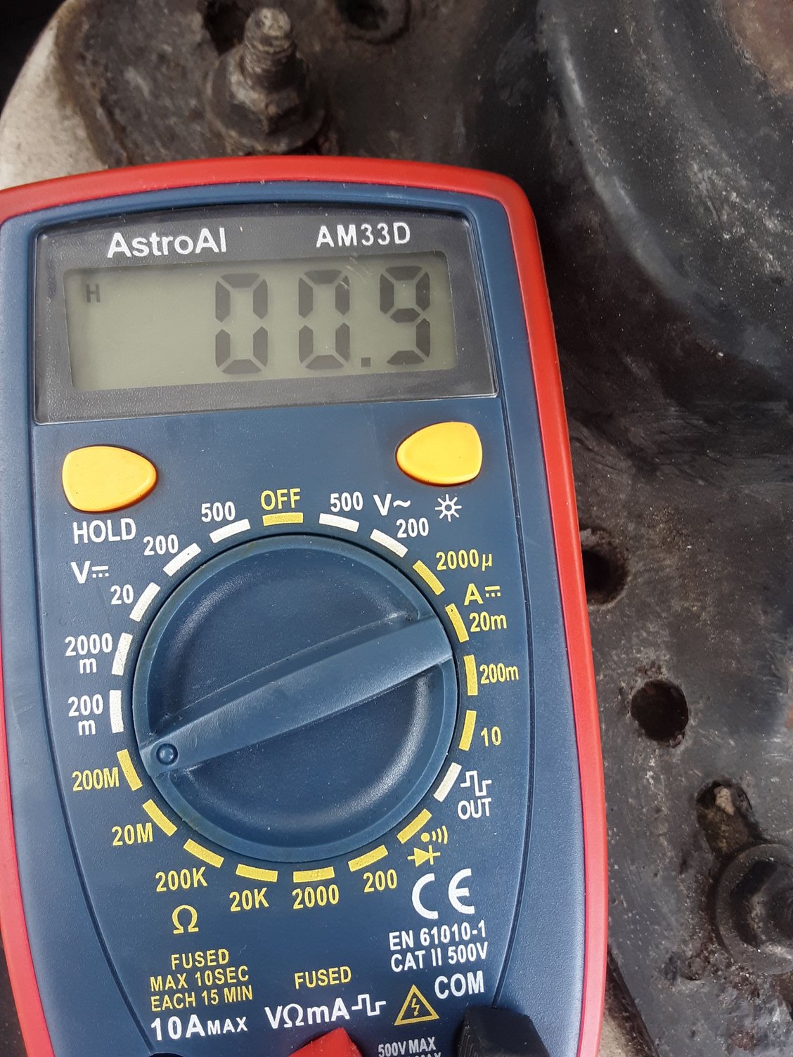

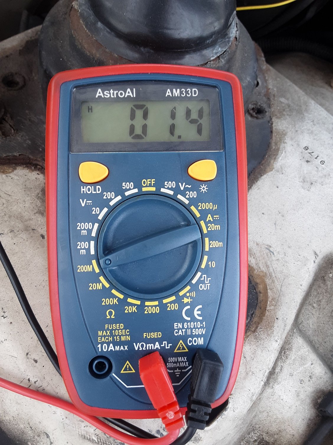

Could someone tell me if I am testing my ohms correctly? I tested Cylinders 1,3 (driver's side) 2 and 4 (pass side) and I get 0.09. Are all 4 that bad or am I testing wrong? I set my multimeter to 200m and touch the two metal tabs with the prongs.
When I set it to 200k, 20k, etc. I only get the 1 or the I.
Injector 1
Injector 3
Old Nov 1, 2021 | 12:27 PM
Vinscully50's Avatar
Joined: May 2013
Posts: 604
Likes: 29
Car: 1986 Camaro IROC Z
Engine: LB9 305 TPI
Re: Strange Metallic Sounds From Engine (Videos Inside)
Never mind I "fixed" my multimeter. Wrong 200 setting...
All injectors were around 16.5. It dropped before I hit old.

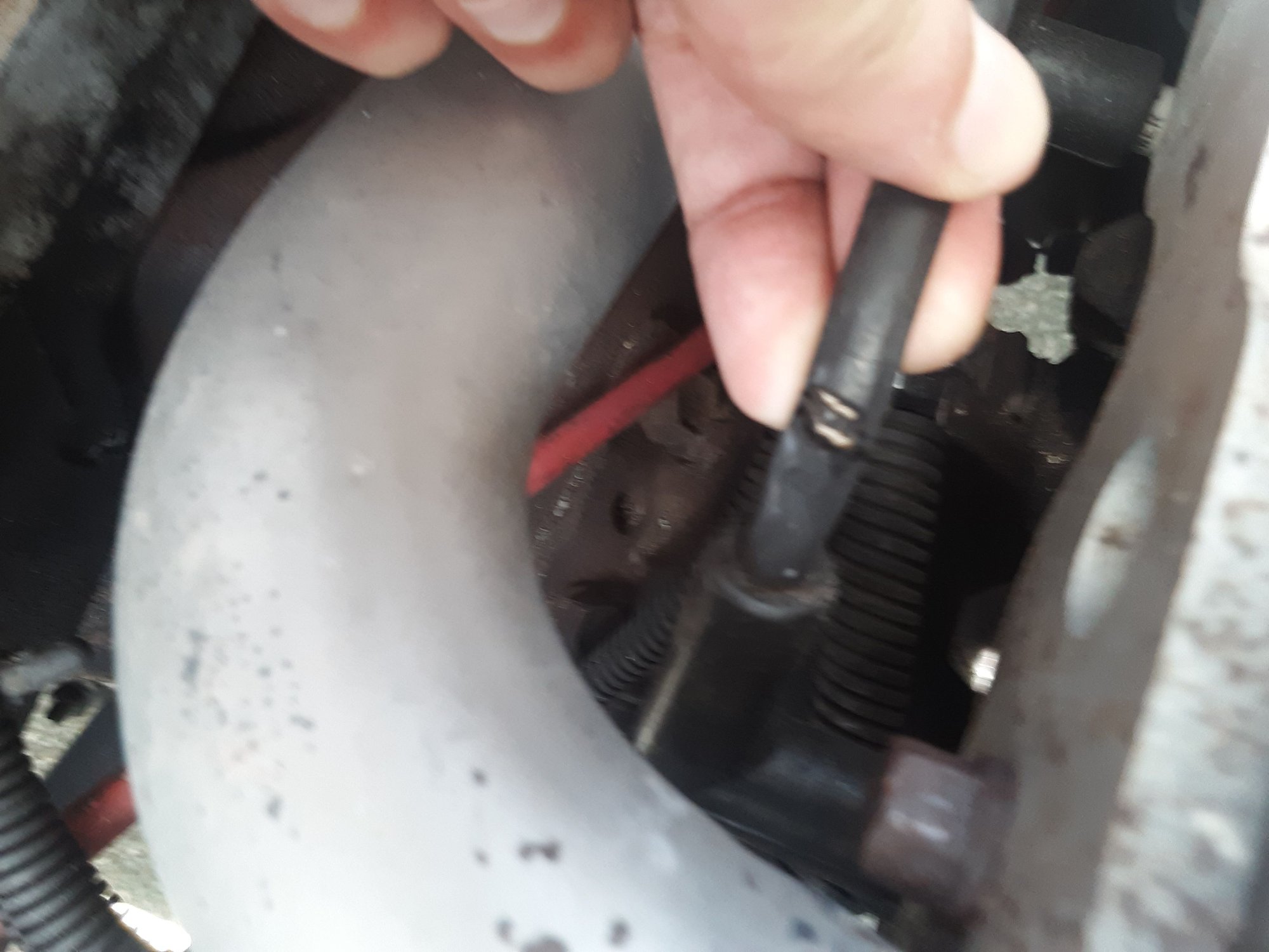

I did notice this.. hmm... I think I need a new set of wires and some boots...
Old Nov 1, 2021 | 12:29 PM
Joined: May 2013
Posts: 604
Likes: 29
Engine: LB9 305 TPI
The wire looks pretty split. It's cylinder 2. These are Taylor Thunder Wires I ordered a year ago. For now I'll run out to the auto parts store and replace that wire and see if it fixes my problem. I probably should have ordered boots with the wires...
Is it ok to mix wire brands? Since more than likely the store will be Delco.
Old Nov 1, 2021 | 12:51 PM
aliceempire's Avatar
iTrader: (14)
Joined: Nov 2008
Posts: 2,106
Likes: 181
From: Milwaukee
Transmission: T-5, TH350, T-5
You *can* mix them, not the end of the world. Not ideal but will help eliminate that one wire from being a problem.

The mixing would be temporary. I'll be the set and replace all of them later this week. I just wanted to put one on there to see if that cures the problem. It's crazy, my last set I didn't run boots with them and had no problems.
The picture doesn't do justice to how split that wire looks.
