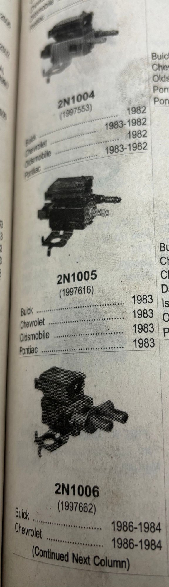

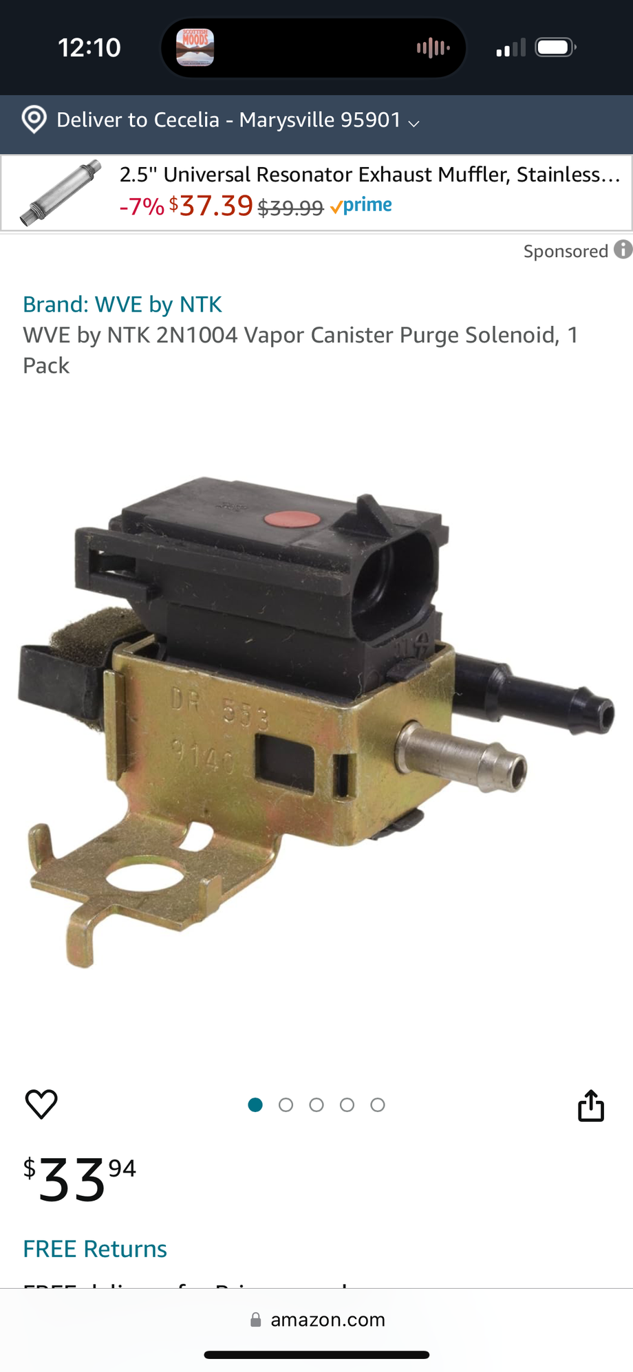

Old May 16, 2024 | 03:25 PM
HelpLess's Avatar
Joined: May 2024
Posts: 2
Re: 1982 Z28 Can't find replacement purge solenoid?
The top is 3 part numbers that interchange with part an Amazon has it but currently out of stock
it took 1 month for Amazon to get it for me

Replying to Vader;6533201
The replacement connected right to my original connector an is working like a charm. Haven’t had any problems.

Thanks for posting this! That's awesome info. I went ahead and ordered the Amazon one you posted and hopefully I'll get it soon enough. I've waited this long without finding one so a month to ship wouldn't really bother me.
