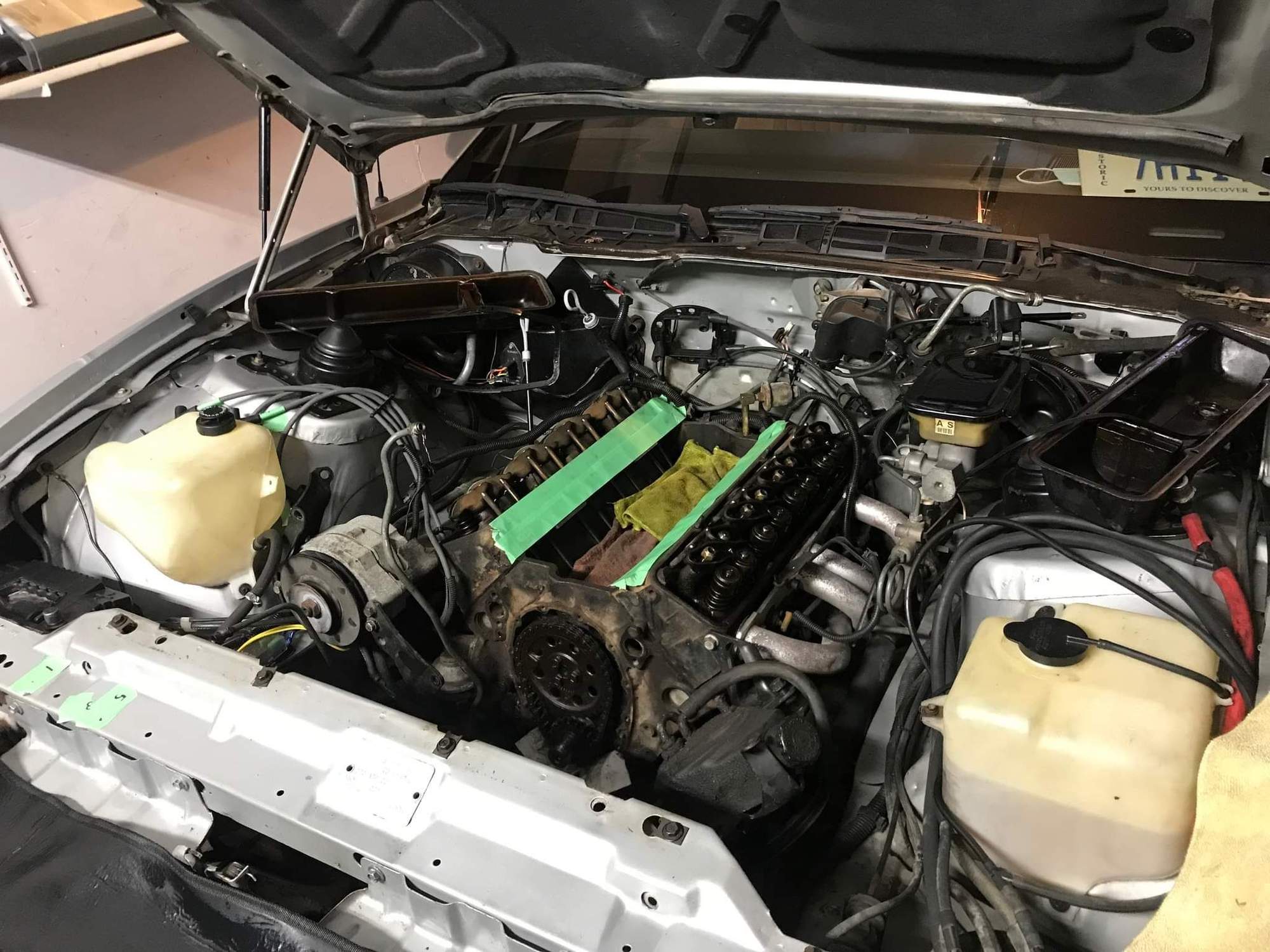

Sbc ​​​Nube installing cam and lifter kit, lifters are new in box - no cleaning or soaking.
Doing what I can with inspection to ensure smooth break in.
I noted most most of the lifter plungers mover freely when depressed, however some are very stiff - to the point where I cant really be sure if they are moving.
is this typical? Are the stiff units si,ply "pumped up"
thanks for your replies.

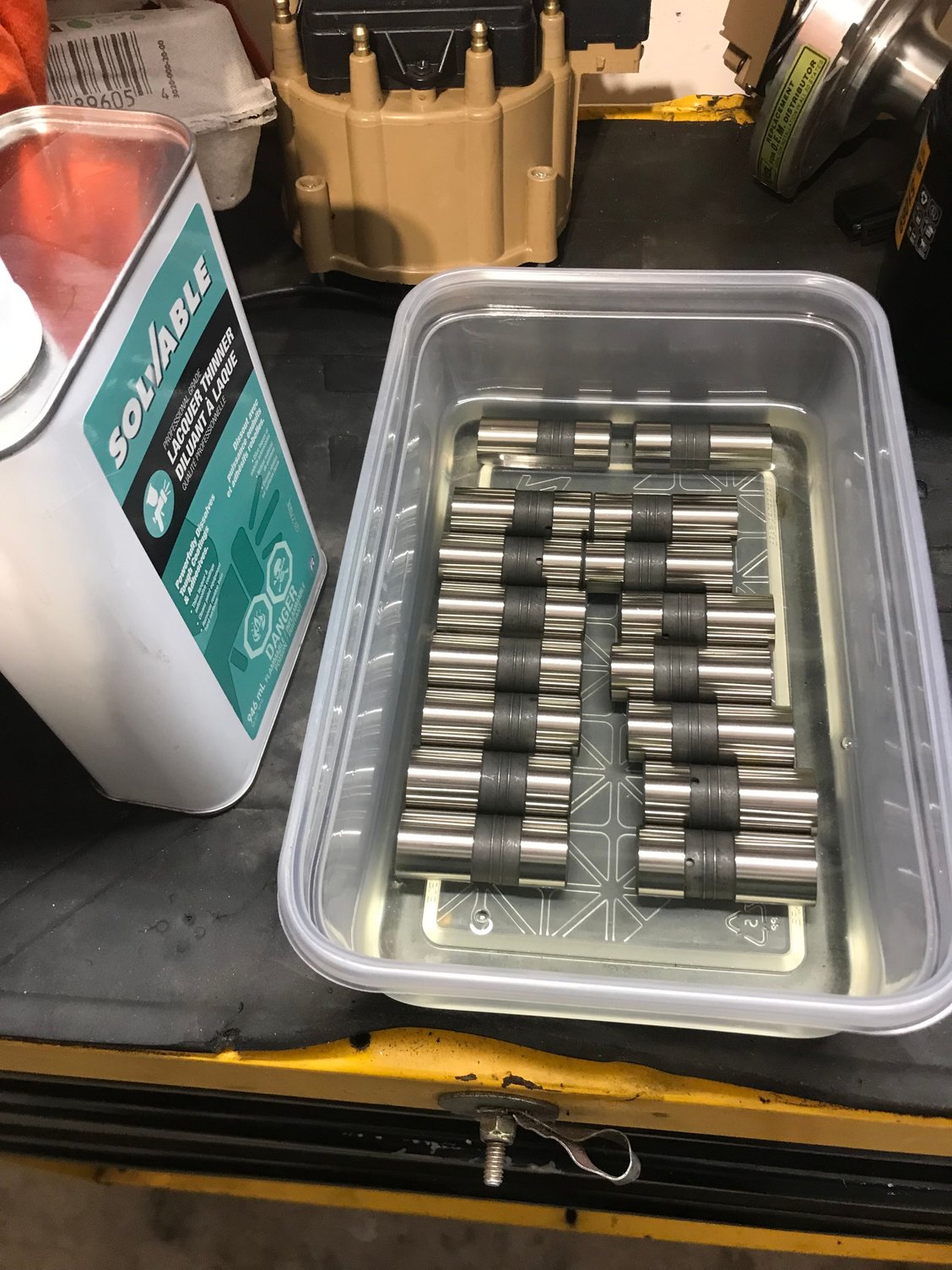

I’m a bit ashamed to admit it, but I called Lunati at lunch yesterday (on the company cell phone, so at least I didn’t pay for the call):
They confirmed it is typical - the “grease” they use in assembly is water based (EPA compliant), it does evaporate off and can leave the lifters bound up.
They recommended Seafoam to clean/rinse the lifters (epa compliance?), and then soaking in sae30 or break in oil.
Thanks again for the thoughtful (and entertaining) response. Fwiw, if you’re kids don’t believe they know more than you, what have you accomplished?
I've never used thinners before, it stinks like crazy. All right to put the thinners and lifters in a plastic container to soak?

I’ve had heads off of sbc previously, even iron dukes (industrial versions not auto) but this is my first effort with lifters / cam so I’m likely to make mistakes if I’m not told otherwise!
Soup’s done!
there is a notable yellow tinge to the thinner. Time to dry them out.

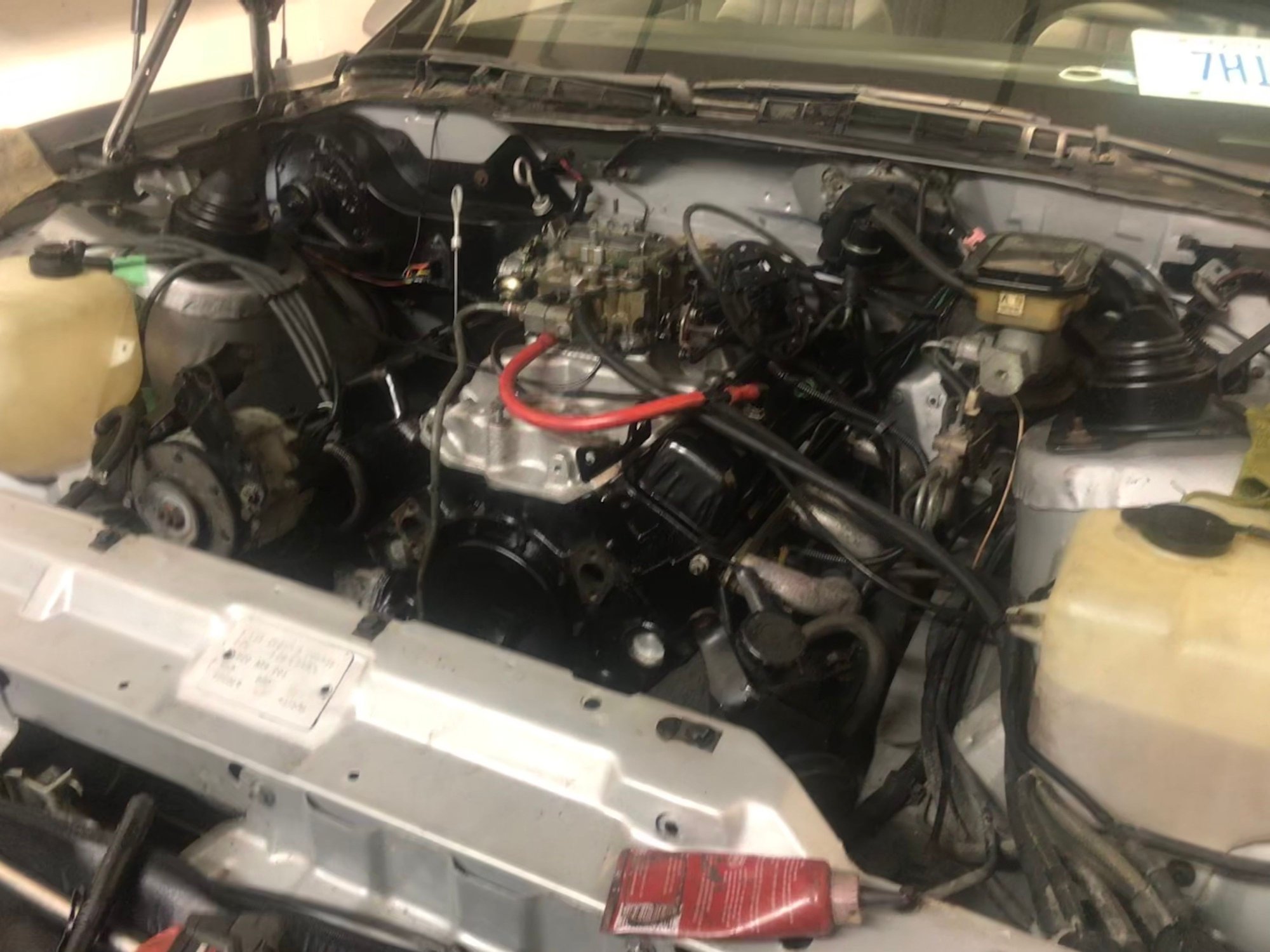

Old Dec 24, 2021 | 06:58 AM
theraymondguy's Avatar
Joined: Jun 2020
Posts: 488
Likes: 116
Re: New cam install, lifter question

Ive done top end work on industrial engines, no one cares what the finished product looks like so it takes no time to finish by comparison. Wire wheeling, cleaning, more wire wheeling, primer and paint add so much time. I’d be ashamed if I were on the clock for this one.

Some more today. Balancer, fuel pump, valve adjustment, engine oil primed.
