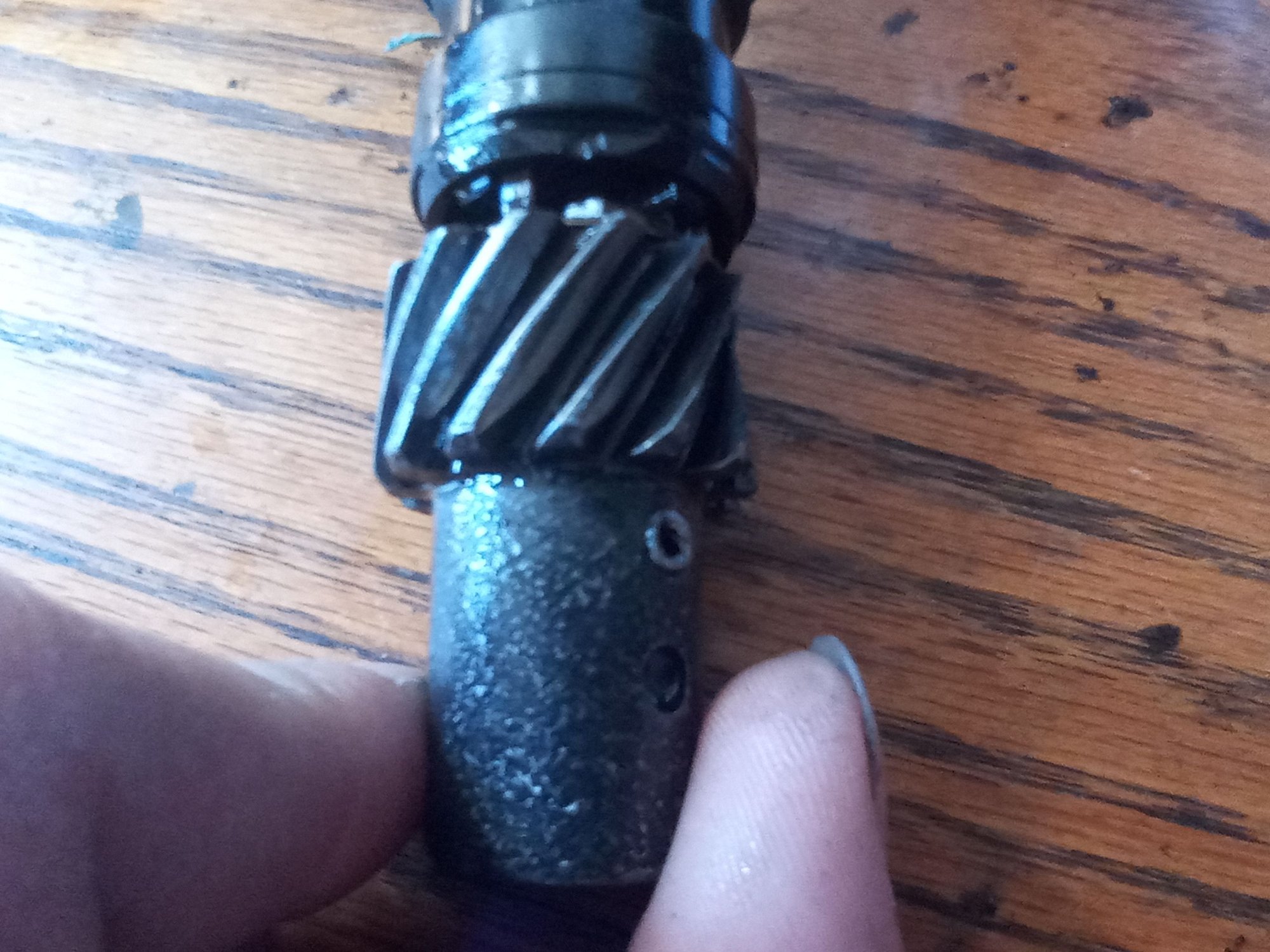

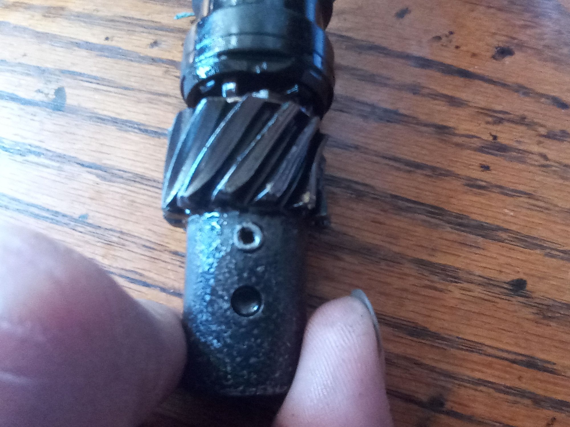

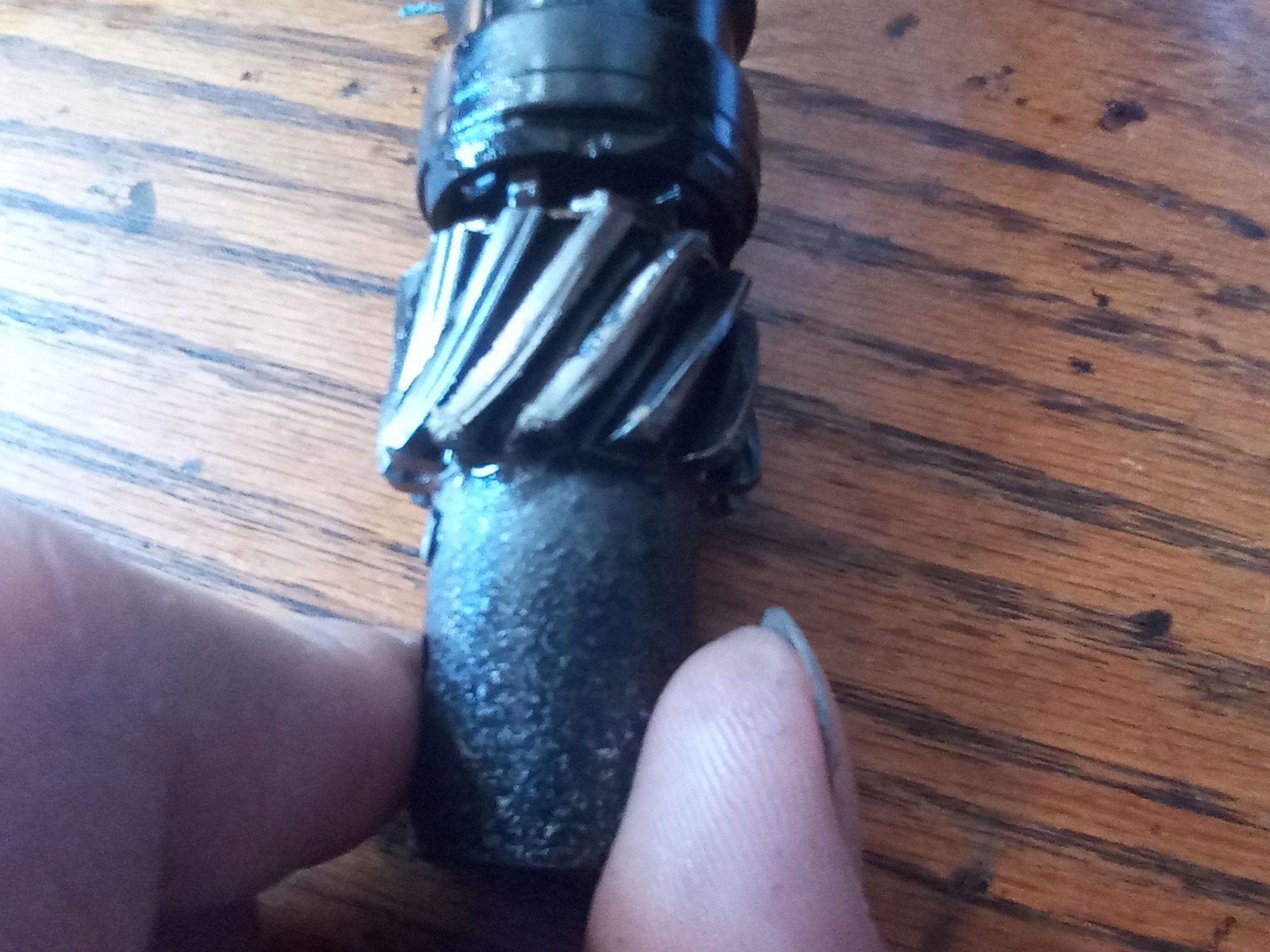

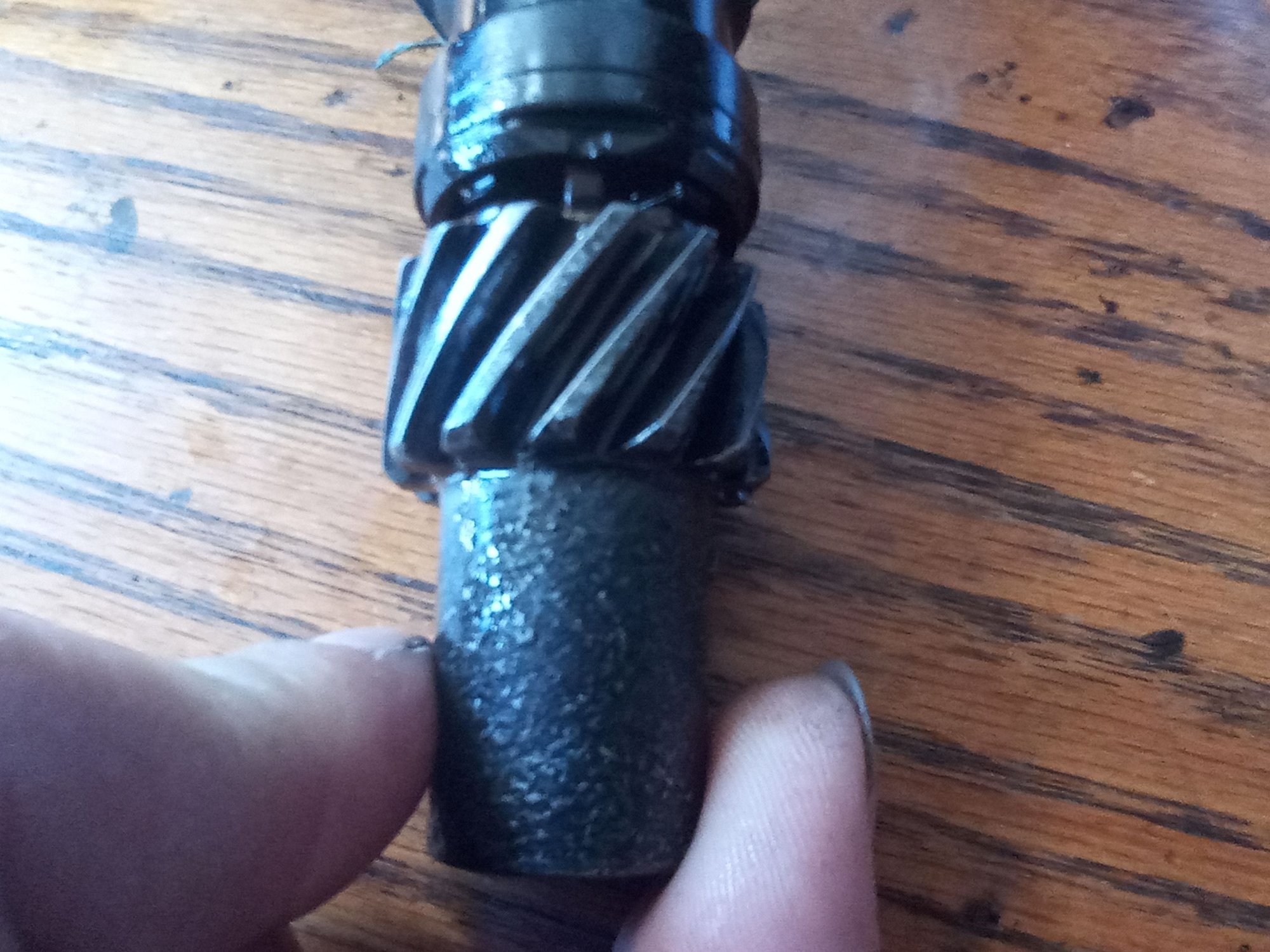

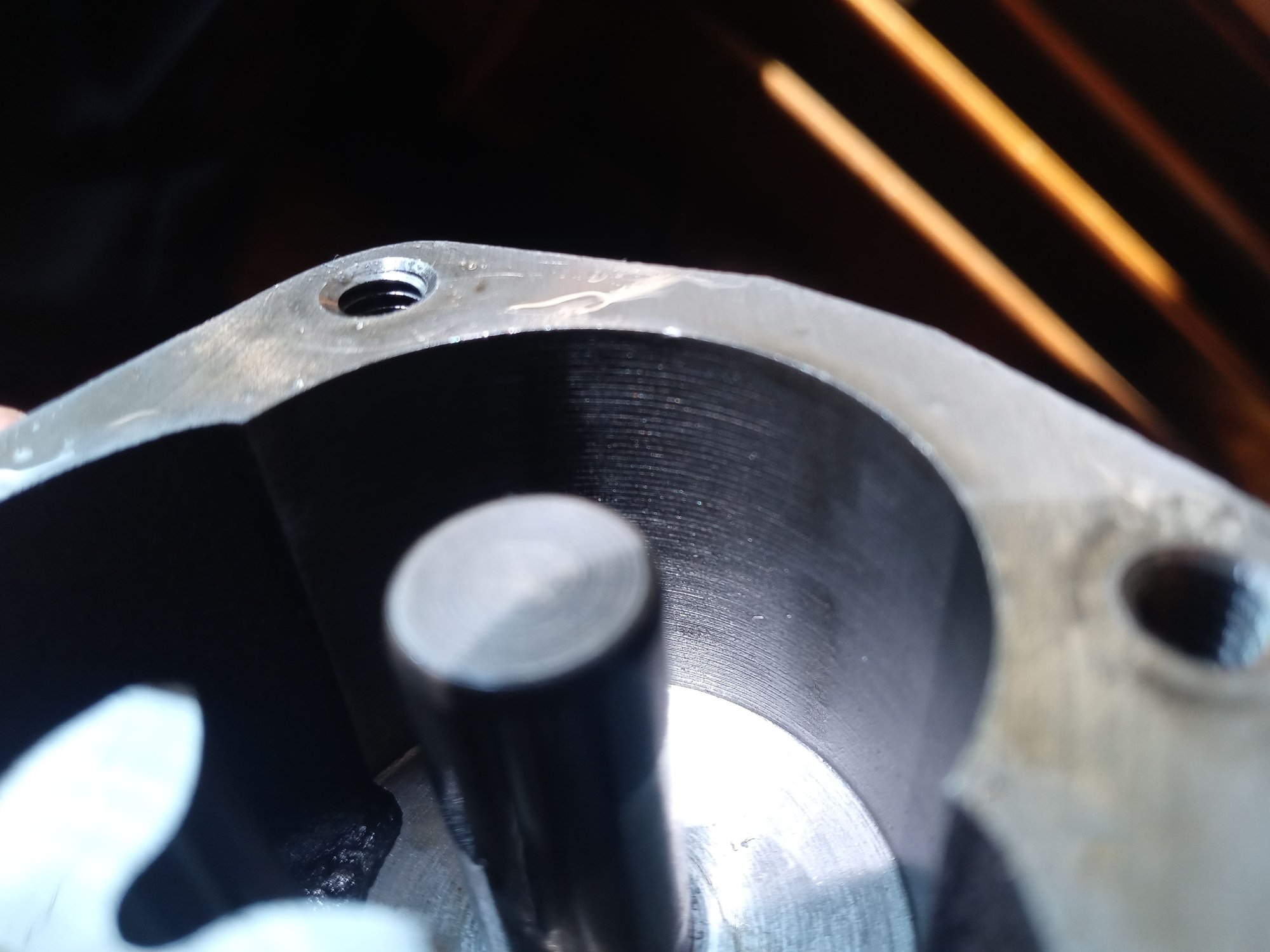

So I stripped the dizzy gear on the plastic vortec 350 distributor . Haven't yet looked at the cam gear . I hope it's ok. Cam is an Lt4 hotcam which I was running a melonized gear with as called for. The vortec dizzy moves around a lot and has a lot of play when setting it in the hole. Misalignment be to blame? What to do in this situation? Pull pan and clean out debris or will they be in the filter or could the pump sucked some of the debris and ruin my engine and pump damn man .?

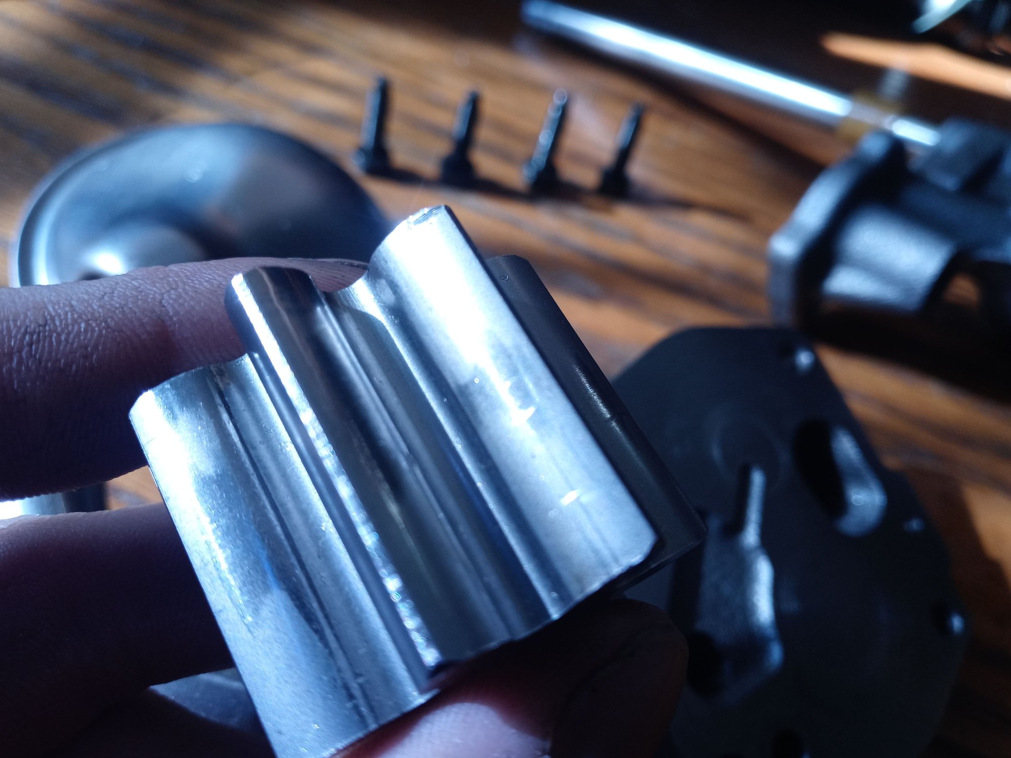

I have a theory on what I might have done to cause this, maybe. If you notice in the picture I made a T into the Ramjet intake from my pcv on the drivers vc. Thing is the Ramjet intake already has a pcv. I started noticing a very light smoke a while ago and I checked the pcv on vc and it had oil in it and was sooty around the base of the vc hole gasket. So maybe vacuum was really high in the crankcase and I was sucking up oil causing me to run low and the dizzy rotor not being lubricated resulting in a chewed up gear? When I was experiencing backfires at higher rpms the chewing of the rotor began and I tried to keep the rpms as low as possible to not replicate the backfires. I ran it at least a good half hour that way before it gave out completely and I was being real easy on it, I was doing low rpms in like 5th gear when it gave out. I even checked my pressure before it cut out and it had dropped to 15 psi at idle when I usually run low 20-25 warm, but I was also running low on oil.. So for sure I have metal in there. Going to pull pan, oil pump and filter and see what's in them. What do you guys think of the two pcvs, could have been sucking oil huh? Or I was also thinking I might have a few leaking valve seals maybe but there was definitely oil in the pcv

I've seen it more than once. Usually has something to do with the oil pump. What kind of pump is in the motor? What kind of oil has been in it? What's the oil pressure been?

If the distributor "has a lot of play when sitting in the hole" , as in side to side play, something is wrong there and misalignment of the gears is an almost certainty. In all of the distributors I've ever worked on the distributor has always fit perfectly with no side to side play, forget chasin yer tail with the oil stuff and go find a distributor that properly fits .........

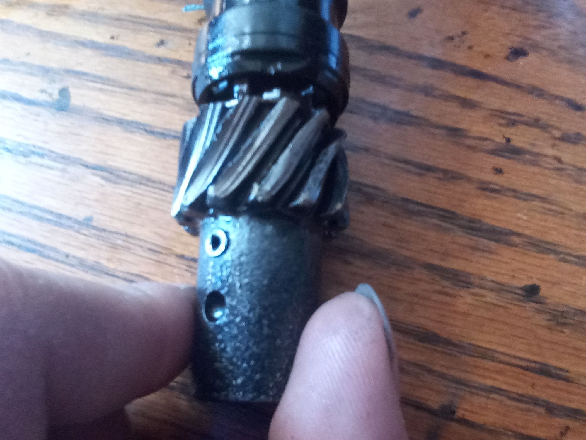

Look's like the shaft on the distributor is bent. The first pic of the gears look good then as you turn the shaft it looks like the gear is losing a good fit & starting to 'climb' up the gear. I am sure if there is the play you stated would be a factor. As the dist. would not stay 'centered' . As was suggested get a proper fitting dist. or maybe a whole ign. system from like MSD or someone if room is the reason for the dist. you used. Also, I would be very sure to remove the cam & do a close inspection of that cam gear. You might also be needing a cam.
As far as other damage I am sure some metal got around but a decent filter should have caught the particles. When you look at the cam gear also look for scoring on the bearing's and surfaces. If there is none your possibly ok. When the timing cover comes off pay particular attention to the 'corners' ( where it joins the oil pan,ect.) for metal. If none you gor lucky. Even if there is you would have to do a 'refresh' rebuild to clean out all the oil passages. Sorry to say that, but thats how we learn about precision machines. Good luck.

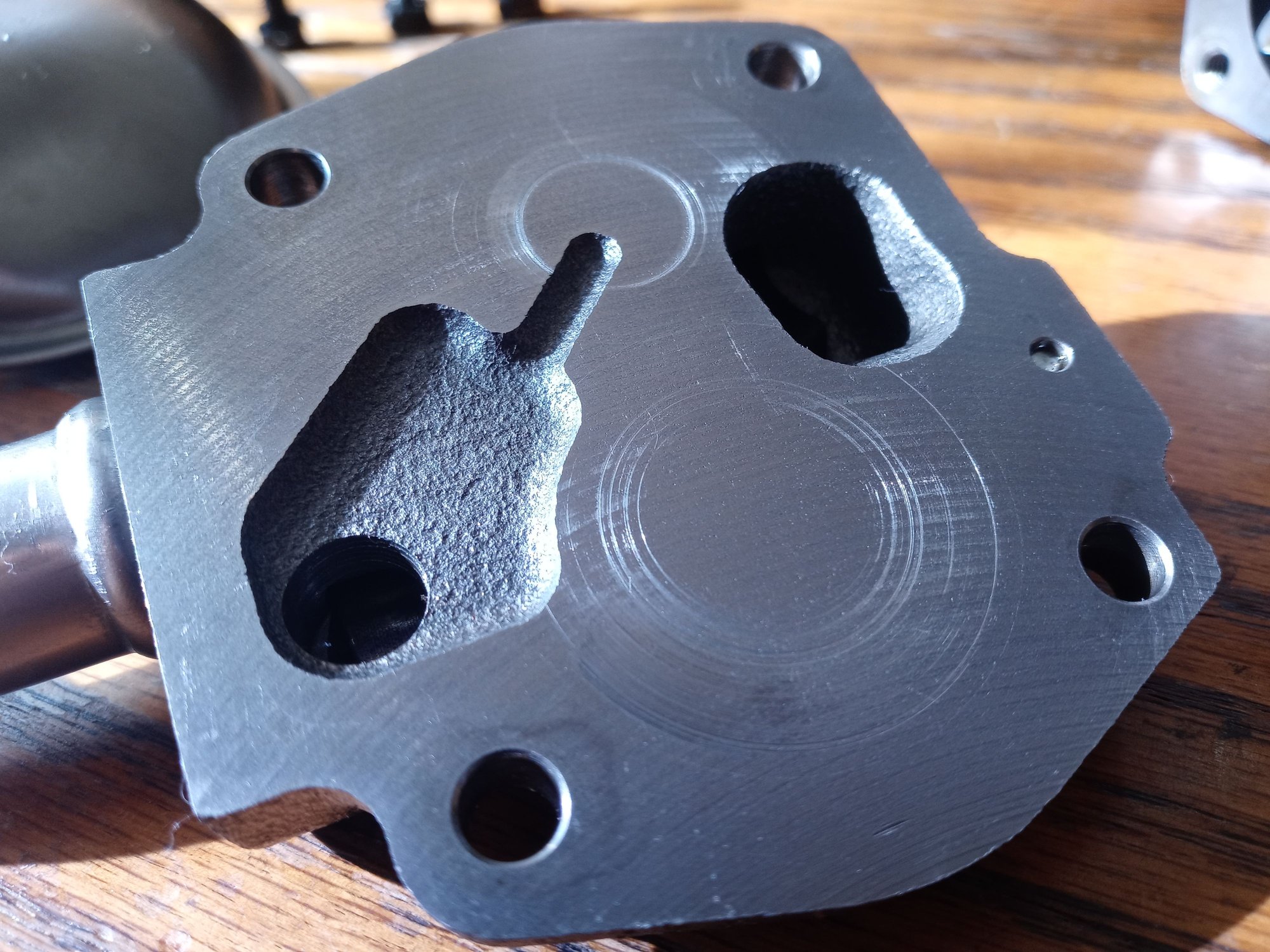

Don't forget guys, before the oil gets to the filter, it has to through the oil pump.
If you find metal in the filter, you WILL NEED an oil pump at least.
Aftermarket intake manifolds typically have HUGE distributor holes.

That is true. At least inspection. Melling pumps are only like $40.

Yep, shaft is bent . Has a mean wobble. The 500 ponys my LT4 Hotcam was putting down must of done it ha! I knew these vortec distributors were notorious but damn! First thing I noticed when I swapped over my melon gear from the hei over to the vortec dstributor was how skinny and weak the shaft looked. Should have known better and not ran it and went with an aftermarket one with a bigger shaft. The shaft on the hei measures 12.5 mm and the shaft on the vortec measures 10.5 mm. The body on the hei measure 24mm and 22mm on the vortec and made out of plastic. Definitely NOT a performance distributor. Thanks man I need the luck. Going to be removing pan soon.

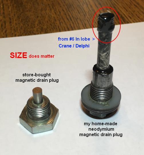

As many Vortec (96-2000 SBC) motors as there are in the world, I can't believe that the design is inherently inadequate. Might look weenie next to others but there's not supposed to be that much force on them.
Looking at the one in the pics, looks to me like it was severely side-loaded, and ate the bushing in the bottom of the housing. Given that the dist itself is only a very tiny load, the only possible explanation is that the oil pump loaded it beyond its happy place.
Wouldn't surprise me a bit if the magnetic stuff was the root cause, and it getting into the oil pump caused enough interference with it, that it tore up the dist gear. I'd bet money that the glitter is from somewhere else if I was the betting kind. (I'm not) Not what you want to hear I don't doubt, but it's always important to separate symptoms from problems. Kinda like, if you see a little old lady laying on the sidewalk with her face turning grey, you don't ask the first passing woman to put more makeup on her so she looks better; you administer CPR and call an ambulance for a heart attack even if nobody wants to have that happen.

What the heck is "melonized"? The word is not even in the dictionary...

if it's not knocking yet you may be able to save some of the inard pieces/parts. keep going and some of the pieces/parts may become piece/part.
I'm sometimes the curious type and might try turning that oil pump through the dist hole with one of those pre-lube dizzies that doesn't have the cam gear. see how much resistance I had.
either way though, I'd be looking forward to pulling the engine hoist out and putting it together for a project.

https://www.chevytalk.org/fusionbb/s...php?tid/23575/

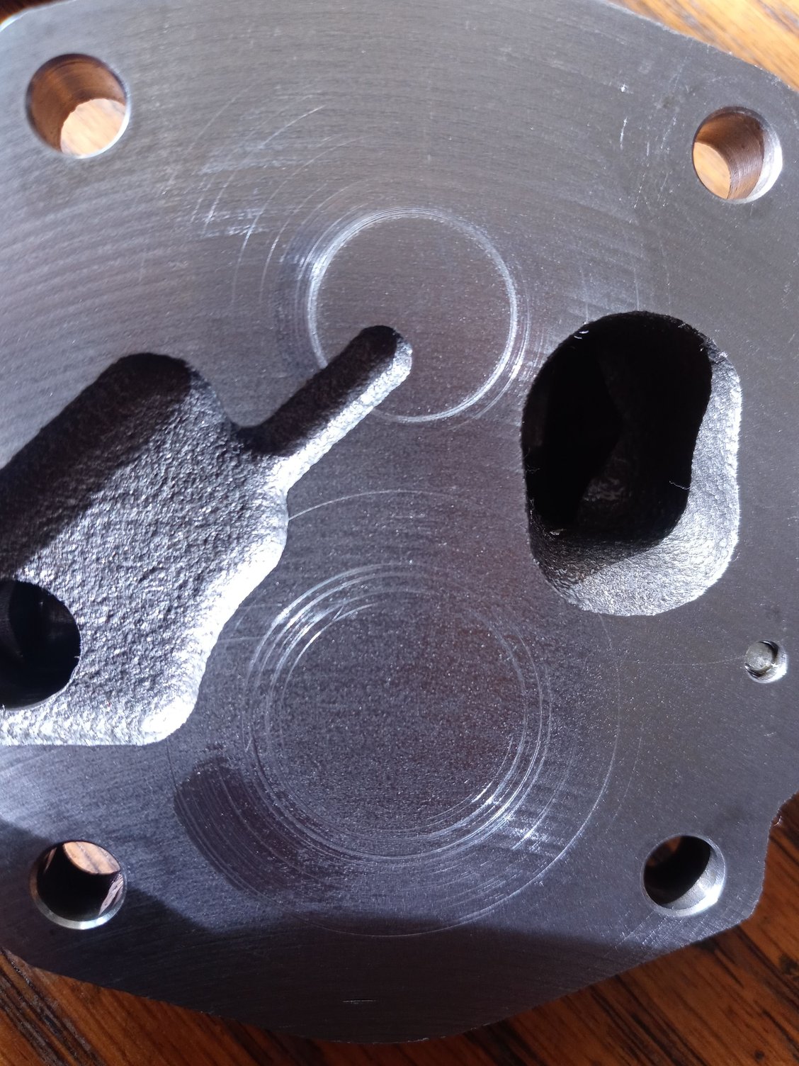

Got the pan off and it was pretty clean. No big pieces of metal. Pretty damn spotless . Pickup tube was clear, nothing in there. Guess all the metal went out when I drained the oil. Cut open filter and it had metal in it but not much, very small specs. Opened oil pump and it has some wear, check it out. Timing chain is ok and cam gear looks pretty good on one side haven't turned it over yet. Still trying to figure out what happened. I removed the shaft on the vortec distributor and it looks like it got hot. Has a burn tone. Sofa you said it might have been side loaded meaning that the cam is starting to push towards the the passenger side? Cam bearings worn throwing cam out of alignment?

Looking at these pictures over and over and over and something was just odd about it.
For giggles, I'd pull the cam out and check the runout of the gear running the distributor.

The interface between the cam gear and the dist gear is to the side of the dist shaft. ANY load on that gear interface is inherently side load on the shaft.
The dist itself present basically ZERO load to the gears. The ONLY thing that creates any significant load, is the oil pump.
That pump definitely has had some metal go through it.
How bad is the rest of the motor hurt?

So load on the dis gear would have to be coming from the camshaft moving side to side? As far as damage, everything looks great under the oil pan, cam lobes look real good, cam gear looks good too. It was driving just fine until it got to higher rpms then it would misfire but no weird noises before it just shut off. I was doing very low rpms in 4th or 5th. Hmm.
Old Feb 12, 2022 | 06:59 PM
Posts: 27,962
Likes: 2,471
Re: Stripped dizzy gear help.?
The load on the dist shaft comes from the cam gear struggling to turn it. The gears try to push away from each other. The harder the cam gear has to try to twist the dist gear, the harder they try to push apart. The harder they try to push apart, the more force there is on the dist shaft, where it's trying to keep itself at the right distance from the cam and not get pushed over to the side.
The only significant load on the dist comes from the oil pump. If not for the oil pump there would be virtually no load on the gears, therefore virtually no force trying to push them apart, therefore virtually no side load on the dist shaft.
Has nothing to do with the cam moving side to side. The bearings (bushings, really) that the cam gear is between have about 50 times the load-bearing area that the dist shaft bushing has. The dist shaft bushing is the thing that's gonna lose that fight, every time. The cam will run true and not even notice the distress the dist is in.
If there's metal in the oil filter, it came from SOMEWHERE. Your mission now is to find that source and rectify it. Or, decide that it's insignificant and just put it back together and move on. Which could conceivably be true as well. I didn't see it so I have no clue and can't offer any advice as to that choice. You gotta take the risk vs expense/effort vs reward, one way or the other. One thing is for sure though; if the dist gear is plastic, then any metal at the scene of the crime didn't come from THAT, or, from the cam gear.

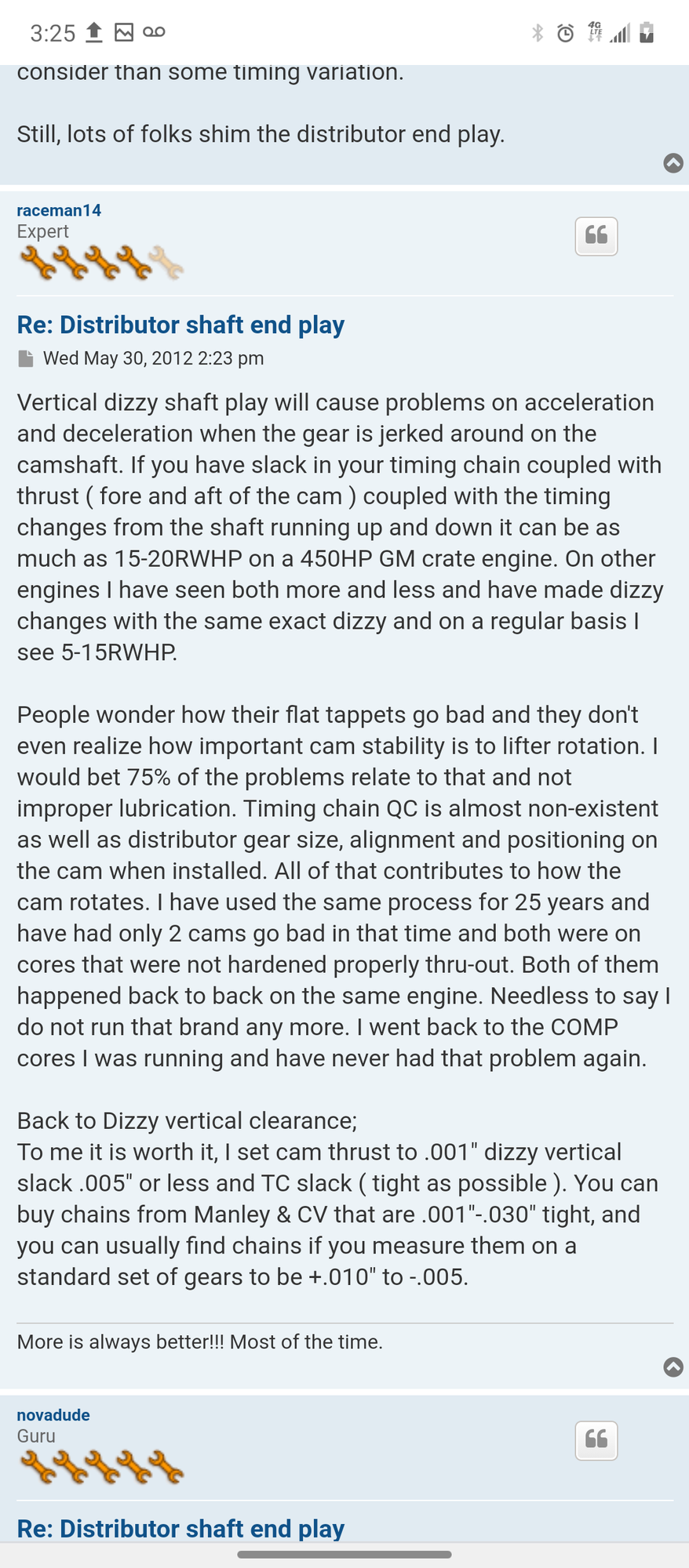

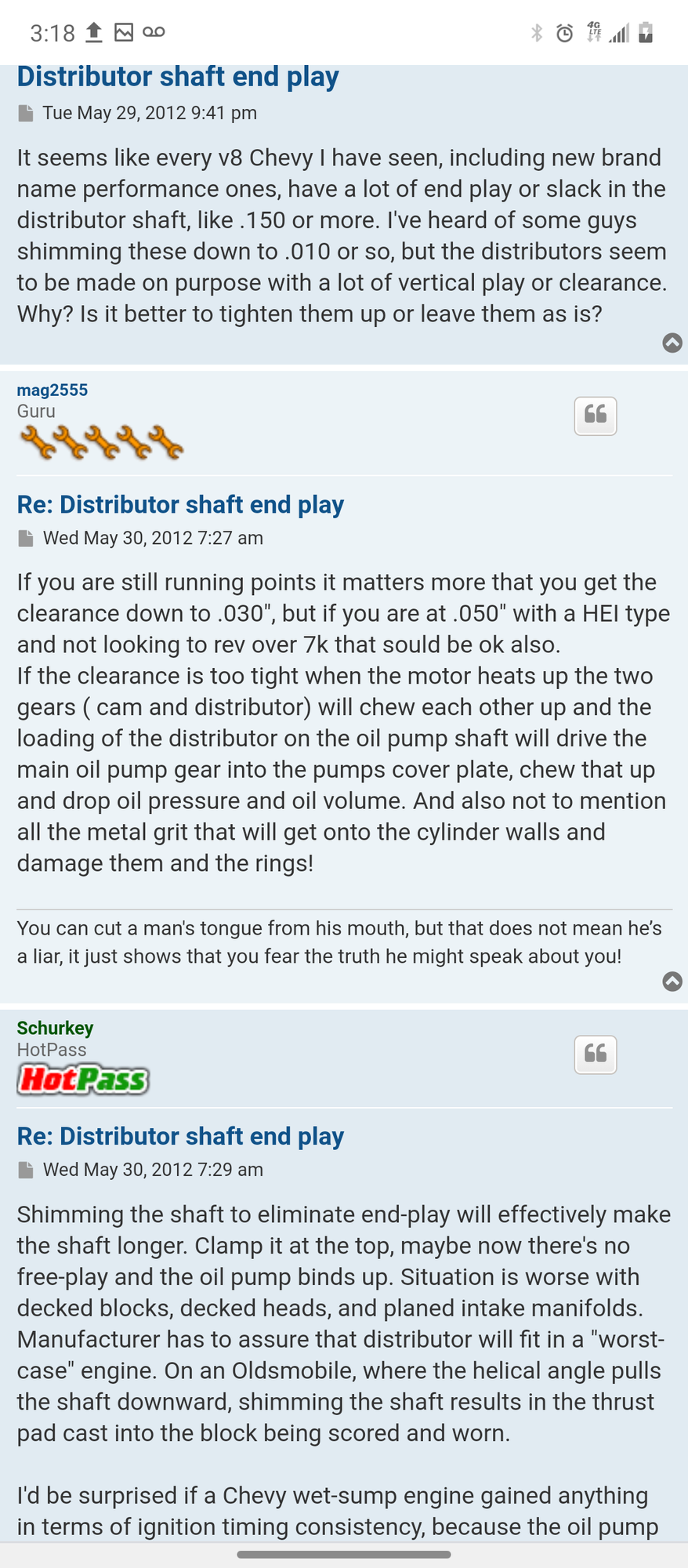

Post 41. I'd at least look closer at the cam gear just to rule it out 100% I was thinking the cam in the thread below was a steel cam with pressed on cast gear but it's a cast cam with messed up machining.

This post describes exactly what happened to my oil pump were the main gear dug into the cover plate as you can see in the pics due to too much endplay or not enough. Maybe need to ship body to intake? Never did set my shaft endplay. Also talks about accel and decel and how it affects the timing and distributor gear. Looks like a detail I missed. What do you guys think on this subject? I believe the gears got hot due to low oil and low coolant as I had just put everything back together from swapping out tob and didn't fill up my coolant all the way. Sound like a theory? Also read that aerated oil can put shock loads on gear and pump. Low oil could have attributed. If shaft had lot of endplay I can see how it can be moving up and back down putting downward force on pump gear upon decel and accel especially with a manual were I have a tendency of being in gear and repeatedly accel and decel. Dude was saying this ccan afdect timing and rob the engine of power. Does anybody have a slight jerk when letting of pedal when in a gear? Always noticed that and didnt think much about it.
i believe

Originally Posted by maroe624
….but waiting on a magnetic oil drain plug

So I found out my issue. I used the wrong size distributor gear. Used part number 10456413 which is .491 for an HEI , on the smaller .430 vortec shaft. I remember when I swapped over the gear from my hei to the vortec shaft, I noticed the play but didn' t think much of it. Rookie mistake. Damn I hope I didn't cause too much damage . Going to get it back up and running and hope for the best. Anybody care to share a horror story similar to this? Thanks Tuned Performance.

Boy I thought about all kinds of theory's as to why this happened but was nothing but stupidity on my part. I noticed the play and still ran it . Few more things and I'll be ready to fire it up. Hoping for the best. Yo that wrench is definitely Made in the USA.
