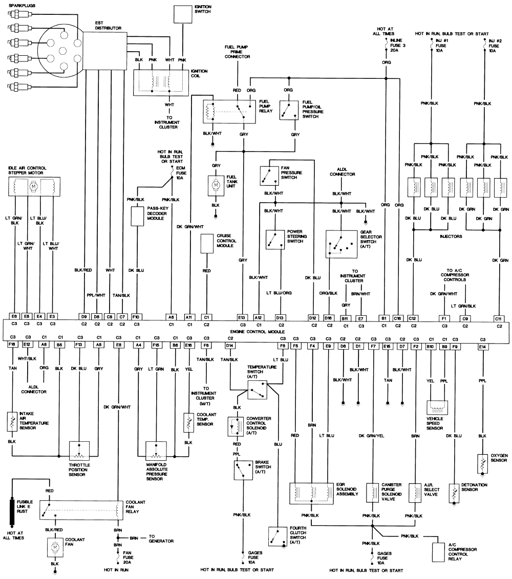

Hi Dave, here is your injector wiring diagram for the 1991 V6. To begin, I will state with complete certainty that VATS is not your problem. VATS will kill the starter and the injector pulse (providing it hasn't been tampered with) so the fact that your starter cranks your engine, and the engine starts briefly, rules out VATS. One thing that CAN cause you symptoms, that I didn't see in your list of replaced parts, is the "ICM" (Ignition Control Module) which is located in the distributor. Note that I'm NOT saying "Buy this, it'll fix your car", what I am saying is that it could be that. Anyway, the top righthand side of the diagram shows your injectors, I hope this helps......

Thanks for this - Can anyone tell me how to check the injector location we feel we have possibly mixed the injectors plugs up - its a nightmare.

On the third gen fuel injection system, there is no mixing up of the injector plugs possible. The 3.1 MPFI is just that, MPFI and not SEFI (which would be a problem if the plugs were put back in the wrong position). I have to leave my computer for the day, but while I'm gone I want you to do a search for "Batch Fire" and "Sequential" injector setups, so you'll understand why the injector plug placement is not important on your car.
