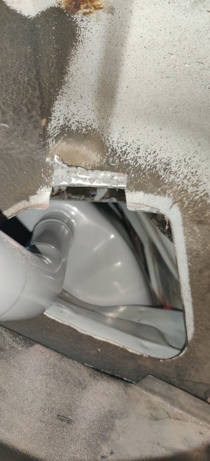

Am in the dreaded process of putting my new gas tank in, and Im up to my limits with this job. I have absolutely no idea how these are expected to go in, the lack of room is astonishing!!! I dropped my axle completely, shocks, exhaust, springs ALL REMOVED!!! there seems to be no way of getting the filler neck in and simultaneously placing the tank up against the frame. There is seemingly no end to this nightmare of a job. If anyone has any tips that would be greatly appreciated.

Update: cut open where the filler neck went and slammed it in, was the only option besides removing the entire differential which I don't have a proper jack to do. Anyway, looks like I got it done... Lol
