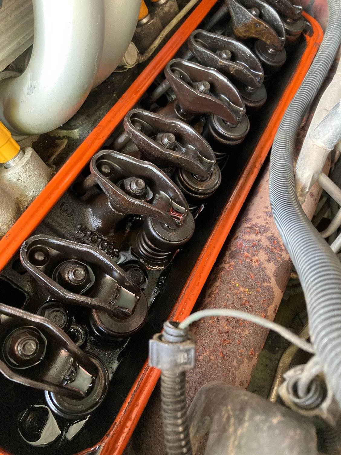

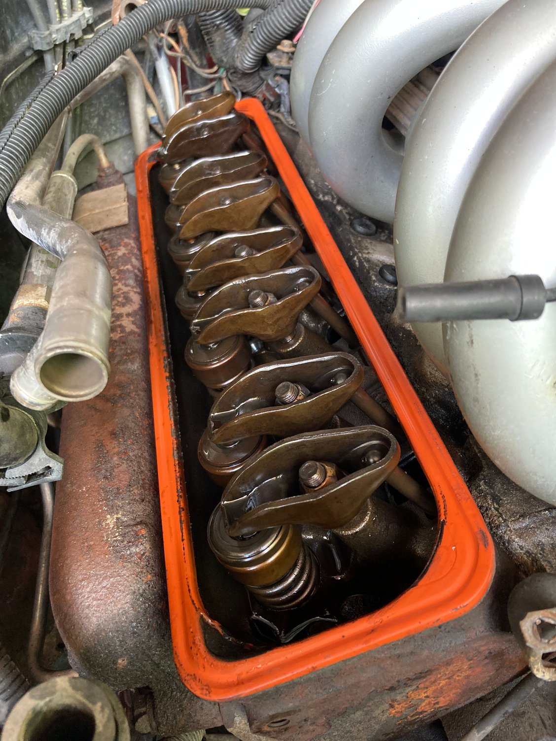

Finally got the valve covers off. What a PITA! I finally had to just bend that AIRS tube back some with a pipe wrench to get clearance. 7 and 8 look like they'll be fun trying to get that spring compressor tool onto.
I notice the driver side rockers are a lot dirtier than the passenger side. Is this because the PCV is on that side or a sign of something else?

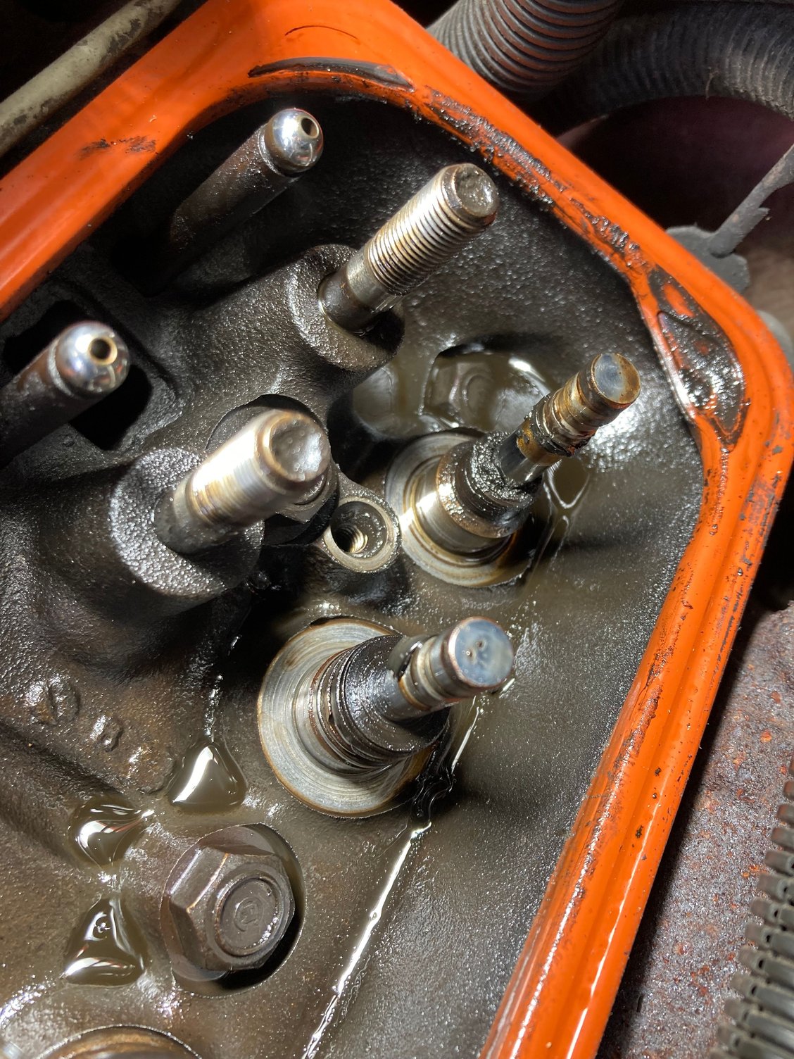

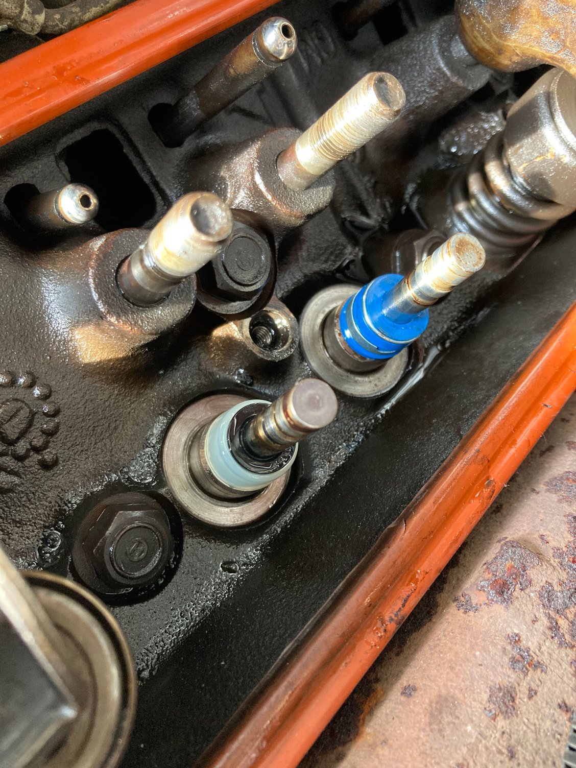

Well it's taken me about 5 hours today just to get to valve covers off and the plugs removed (with a couple of breaks). This is going to be a several week job for me since I can't spend a ton of time on it everyday. Overall though I don't think my spark plugs looked too bad. Had to remove the O2 just to get the #5 plug out.

Well the rope thing seems to be working, and I got cylinders 1 and 3 done. When I started on #5 my cheap harbor freight spring compressor started messing up, so I'm done for today. I'm going to try one of those pry bar style ones and see if I have more luck.
My intake valves already had positive style seals to my surprise, and they didn't look all that bad. They're black instead of blue like the new Fel-pro ones. Exhaust valves had nothing, and the o-rings on both sides fell apart.

I got all of the seals done on the driver side. The old o-rings pretty much just crumbled apart so I vacuumed the pieces out with my shop vac. I've read where a few of you say to use the positive seals on both intake and exhaust, but I had already bought the umbrella seals for the exhaust valves so I used them. Returning stuff to Rock Auto is a pain.
All in all, for a 164k mile engine, I think it looks pretty clean. None of the oil passageways are clogged, and I can see right through the holes in my pushrods.
