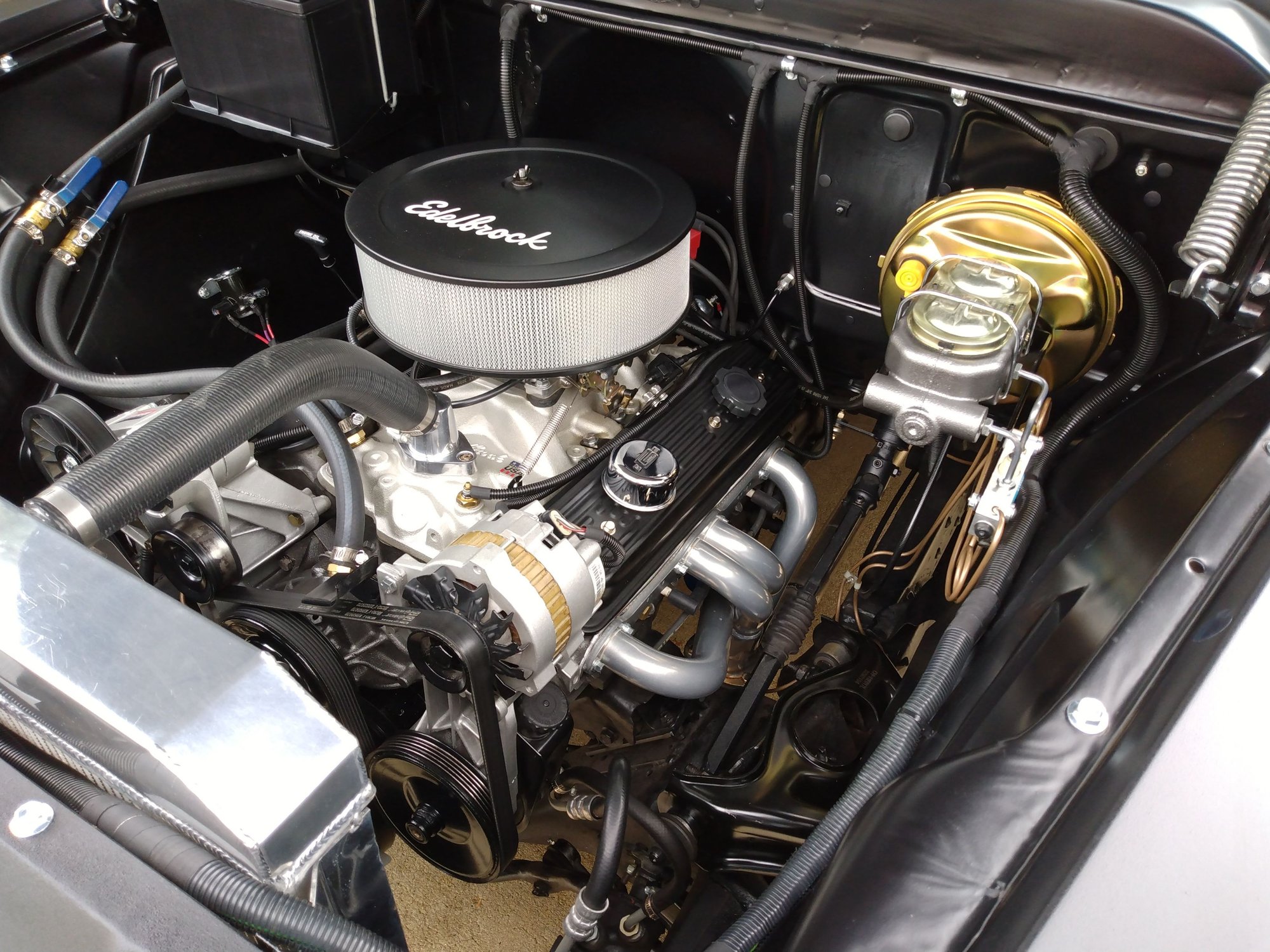

Hello,
I've got a carb-swapped L98 that I want to add more fun to... Looking to change heads, intake and cam. Mostly street/daily use. I'd like great off-idle responsiveness w/stock converter, while pulling harder and farther into the RPM range.
Currently;
29" tires
3.73:1
700R4 w/stock converter
600 CFM carb (Edl. 1406)
Edelbrock Performer intake (Change recommendation?)
Stock heads (Change recommendation?)
Believed to be stock cam (Change recommendation?)
1-5/8" shortie headers w/ 2-1/4" exhaust
I'm considering (but would really like your input);
Edelbrock performer EPS intake
Flotek 102-205 heads or similar w/ smaller intake runners (I'd really like to keep my stock center bolt covers, and I don't see any Brodix, AFR, or Dart offerings w/ center bolt config)
Comp Cams XR258, or XR 264
Thanks in advance for your input!
- Maker

As for port velocity, 180 cc should give you what you want. There are 170 cc heads (Vortec for example) but if you check out CFM vs size, the word is that the AFR 180's hold their own.
But the cam selection will make or break this deal more than anything.
I don't have anything definitive yet, but I'm really expecting the typical 9.3:1. I did a compression test on Thursday. Hi- 135, Lo- 128, Avg- 131.6, Dev- 5%. Took a look down the plug holes with inspection camera. Pistons look to be original iron-head L98-type, shallow dish w/valve reliefs. I'm planning on using Fel-Pro 1003's @ .041" compressed. I'm getting ready to pull the engine here in the next week or two.

Looking at it from the way I put a 350 together, I think the biggest struggle will be building enough compression. It's not just about horsepower as you've stated that you want that pull from off idle. That's torque. And to build torque, you need compression. Low static compression can be aided somewhat with a short cam so as to get the intake valve closed sooner. So while that will trap more air, there's going to be less time to actually fill the cylinder. This is where power output goes down. And this is where the difficulty lies.
A cylinder with a smaller chamber will give a boost. There are 60 cc options. A thinner head gasket will help too. I'm sure you'll find that the pistons are at least .025" down at TDC. Maybe closer to 30 thou. An .026" gasket (which I've used countless times) will restore some of that. (There are thinner shim gaskets but I've no experience with them).
There are other ways to get the compression up but that's far removed from a heads and cam swap.
Anyway, which ever direction you go, I'm sure it'll be a step function improvement over what you have now.

One thing I meant to add was the option of using the L98 Corvette heads. GM 10088113. With a 58 cc combustion, a 12 cc piston, .025" deck and a .026 gasket it gets close to 10:1 (9.87 give or take).
Centre bolt compatible and I believe they also have early style centre intake bolt angles but don't quote me on that.
I greatly appreciate the suggestion...
One thing I forgot to mention in the OP was that I really want to keep using cheap pump gas, which is 85 octane around here. If there was one, I'd go for a simple fix to add a few more points to the CR, to~ 9.5, but I'm worried going higher than that would necessitate more $$ at the pump. I'd like to keep some squish in the head gaskets in case of any minor discrepancies in mating surfaces, and I believe .041" is already on the thinnish side. Also, I really don't want to spend any money at a machine shop to shave heads, block, or to change pistons or rods if the ones I have are found to be in good shape at tear-down. Right now I'm leaning hard towards saying adios to my center-bolt covers, going with Brodix IK 180's/64cc, and the Comp Cams XR264 Roller. I know these are pretty benign mods compared to what many do, but I'm thinking that'll be a big change from what I have, and enough to put a smile on this 'ol non-racer boy's face, whilst keeping fuel costs low and MPG on the higher side.
This is the engine I did for my previous daily-driver. A 1967 Bobbed Deuce and a half. 478 cubes, engine weighing literally a ton, with a whopping 145 HP.
330 HP and 420' lbs in a vehicle weighing 3,500 instead of 10,500, should be quite a change for me :-)
I think the Brodix are an excellent choice. They were at the top of my list but didn't include them because of the perimeter bolts. Remember too that your cam choice will be a big player regarding eventual compression pressures and fuel requirements.
With a 64 cc combustion chamber, a 12 cc piston, .025" deck and a .040 gasket it gets close to 9:1. (8.89). Make it an .026 gasket and you're at 9.3:1.
As for the the head gasket, in the twenty or so that I've used, with CR from 9.5:1 to 11:1, iron or aluminum heads, decked or undecked block surface, not one failure ever. And thousands of miles of service too. Mahle 5746. The resellers listings are all over the map but in Mahle's catalog it comes in at .026". Just throwing that out there. Remember that getting the piston to head clearance to at most .040" pays dividends. It elevates the detonation threshold for one. It also aids combustion efficiency. Keep in mind that compression also helps in the MPG department.
As for the cam, the XR264 has an IVC of 58°. As a measure of pump gas grade suitability, some folks like to refer to the effective compression ratio or DCR. I can reference it because I'm dealing with only one engine platform (Gen 1 SBC) and a general region of engine output so I've learned what works for my builds.
That cam, installed on it spec'd centerline, yields a 7.8:1 DCR. That should produce about a 190 PSI cranking compression (at sea level). Aluminum heads will provide some greater tolerance to low grade fuel although I'd be remiss if I didn't say that 85 octane might be pushing it. Inlet air temperature, coolant temperature and timing will be key.
Great info. Thank You Sir!
