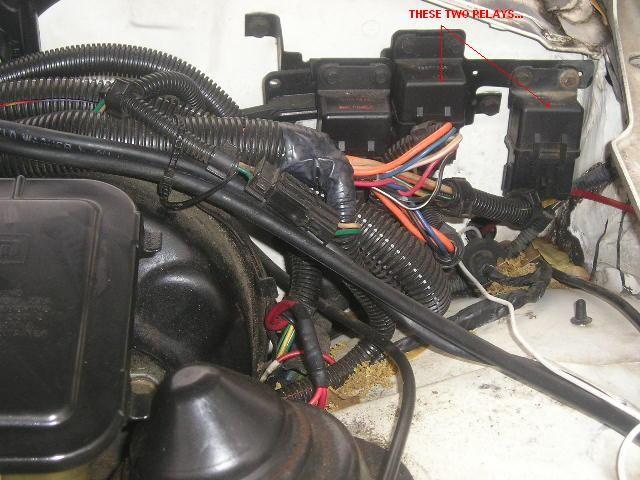

There's a few relay in the engine bay along the driver side and like 1 along passenger. Are any of those related to spark? Actually I think there's 1 under the dash behind a gooey wall that I had to replace once as well.

None of the relays has anything to do with spark. Best way to see if you have that is, unplug a wire from one of the spark plugs, plug it onto another spark plug, and have your assistant crank the engine while you hold the shell of that plug solidly up against something grounded, such as the intake manifold, but not touching the plug itself with your hand (unless you enjoy getting shocked). You should be able to hear it even if it's too bright around you to see it.

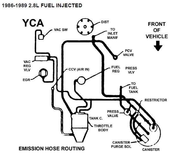

No, it ain't gonna start being so flooded that fuel is dripping out of the throttlebody......
What your gonna do is, put all the fuses back, so that the fuel pump will be able to do the two second prime when you turn the key from off to run.
Then you will disconnect the vacuum line from the fuel pressure regulator to the throttlebody. It's the plastic/rubber block thing with two black plastic pieces of tubing going to it that's plugged into the back of the throttlebody.
With that tubing block thing unplugged, turn the key from off to run (but not start!). If fuel shoots out of the smaller black tubing, replace your fuel pressure regulator diaphragm.
See in this pic the round circle labeled "Fuel Reg"? See how it's vacuum line goes to the back of the TB? At the TB is where you'll disconnect it for this test.

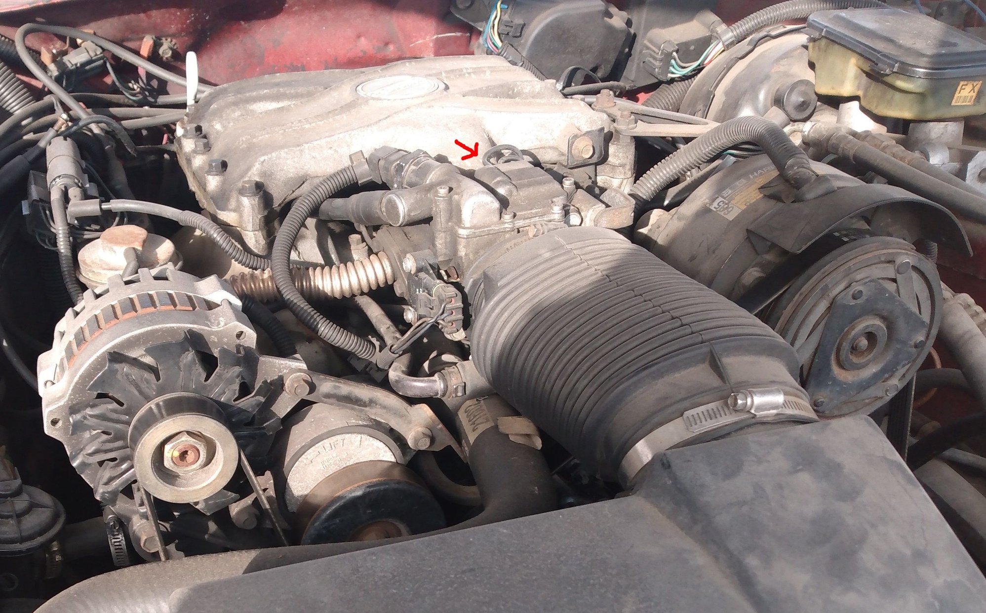

Is it this guy right here with the red arrow? Thanks for the suggestion. Will try that out if I can dig my car out of the snow in the next few days

Yes, that’s it. If fuel comes out of the line. Pull the plenum and replace the fpr diaphragm. Change your oil and you might have to swap out your fuel fouled spark plugs.

Yep, that's the one
