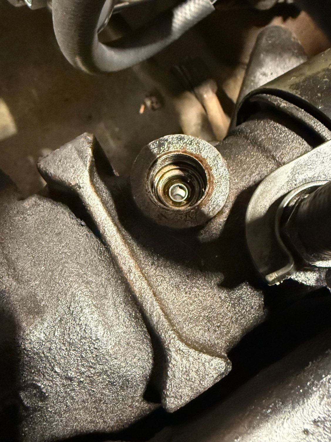

What size fitting?
What is the size of the fitting that goes into the steering rack for the power steering? Thanks!

16mm x 1.5 and 18mm x 1.5

Note also that the type of fitting is the Saginaw O-ring type. Looks something like the O-ring end of this except that the OEM part had a nut that was free to turn on steel tubing rather than a single solid object. https://www.summitracing.com/parts/dsr-090202sds There's 2 possible sizes, this one and the other one. Please excuse the cryptic description the mfr uses for its application. There are also other mfrs and suppliers of course.

Alright. I’m trying to convert it to an hose but I’d see two different sizes for the steering box apparently. I was thinking at first it was 11/16 -18 inverted but then there’s also the metric like what shiftycapone mentioned.

It's metric. Blee Dat.
Did you click on the link I gave you? Does the description match your car? Then it's one of the 2 potential right ones. What was its size? Use your calipers to see if it's that one or the other.
It's just not that hard. Don't make it so.

Yeah I went to the link it helped and figured out which one it was I needed and found the adapter to go AN line. Already ordered it and it’s the last piece to get my car back on the road. Appreciate the help!
