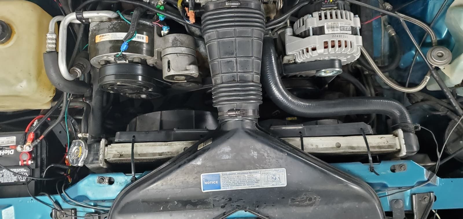

So the project with the fans is finished, except the alternator. With the AC on, driving around low idle, im at about 13v. When I got home it took a few hours to trickle charge back up.
So people say the cs144 is the way to go. But it doesnt line up with brackets. Does anyone know exactly what to get in order for this to work? Ive been all over youtube, summit, and other places and cant find what I need.

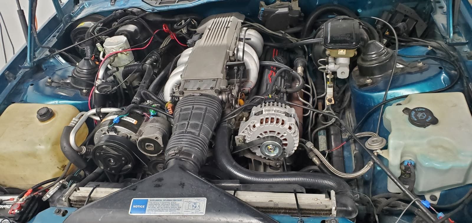

Thnx for the replies - a reminder to post project updates. Everything is installed and works good. I forget what gauge wire I used since it was last year. Maybe its a 6. Either way I dont have much of a draw other than basic electronics, lights, AC, and fans. There's no stereo or any other big draws right now.

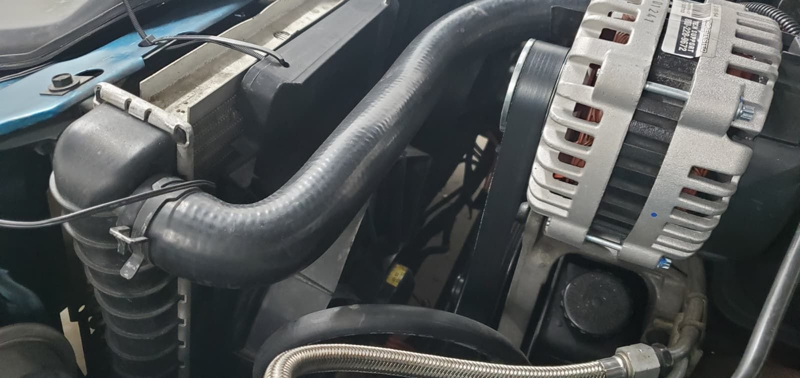

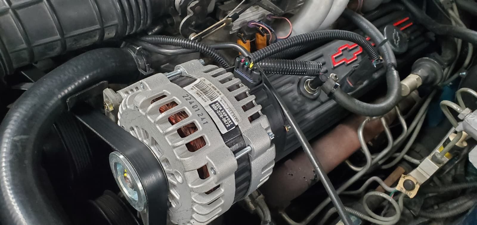

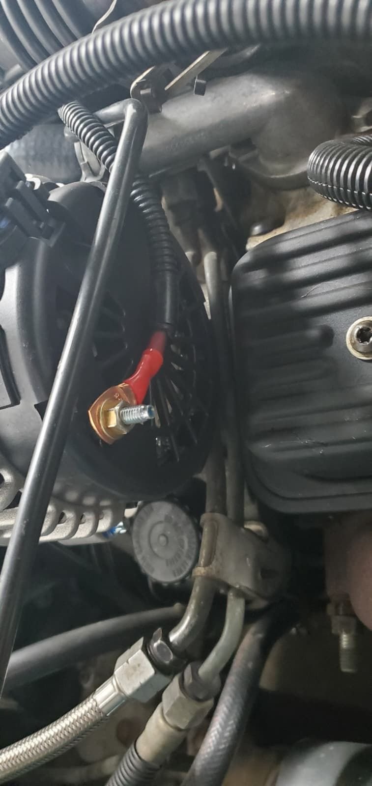

Its part 8237603 and is for early 2000 GM trucks. So like 1999-2002 4.3, 5.3, 6.0, etc. I think even the later 350s used them also after 2000. Like the vans that didnt get the LS motors till a few years later.
Trimming was very little with it. Maybe just half a millimeter and it sat in perfectly. And then the 1 wire harness I think I picked up from autozone or somewhere.

It sounds like its more of a direct fit while the CS144 requires opening the side hole about 1/8 for proper fitment however the CS144 is 140 AMP and is plug and play. They each have their benefits it seems.
I should add the rear brace does not fit and new support brace will need to be fabbed up although I see many owners simply leave it off.
