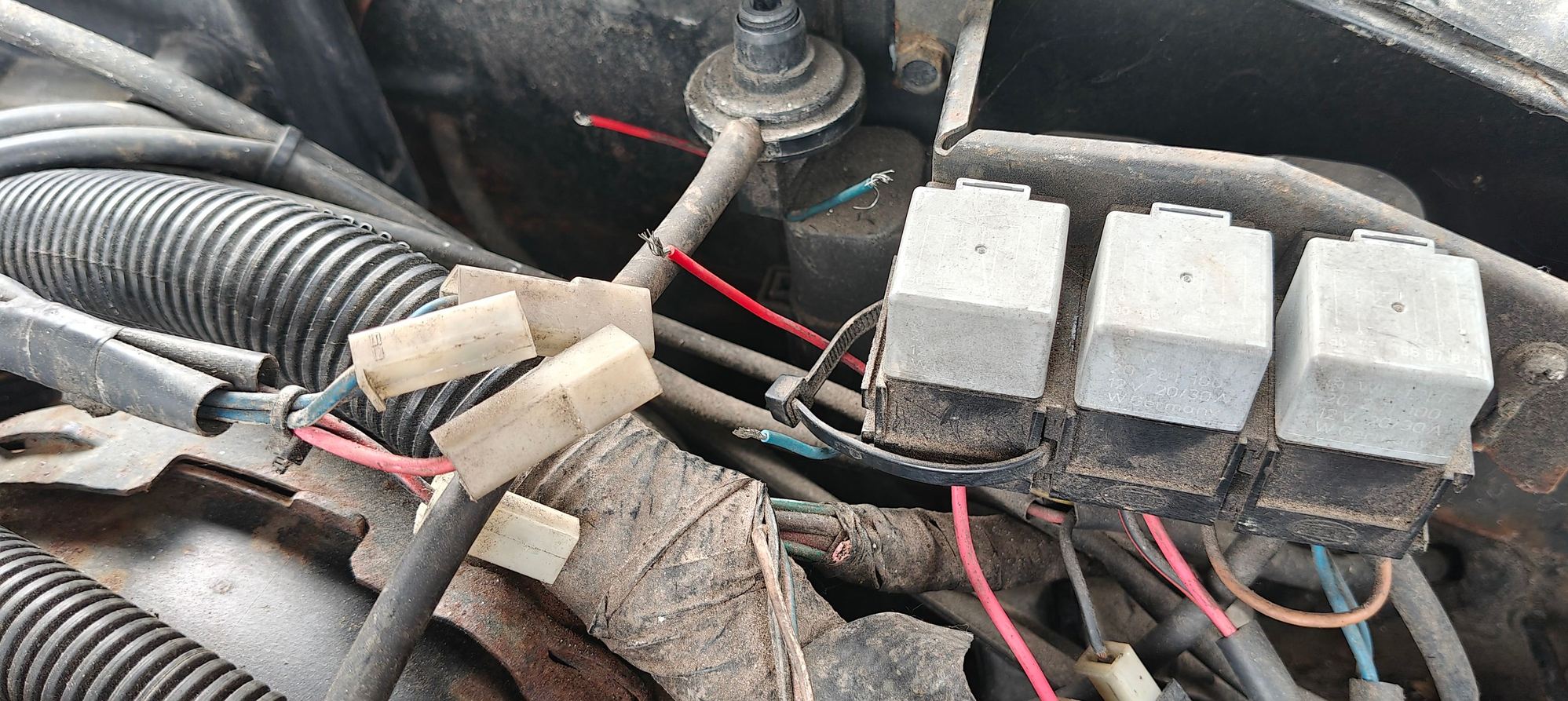

One thing, I see the fuel system has been modified, partly because this car also ran on LPG (no LPG tank now, so only gasoline). So they installed a switch to turn the fuel pump on and off. And disabled the relays, as shown in the photo?

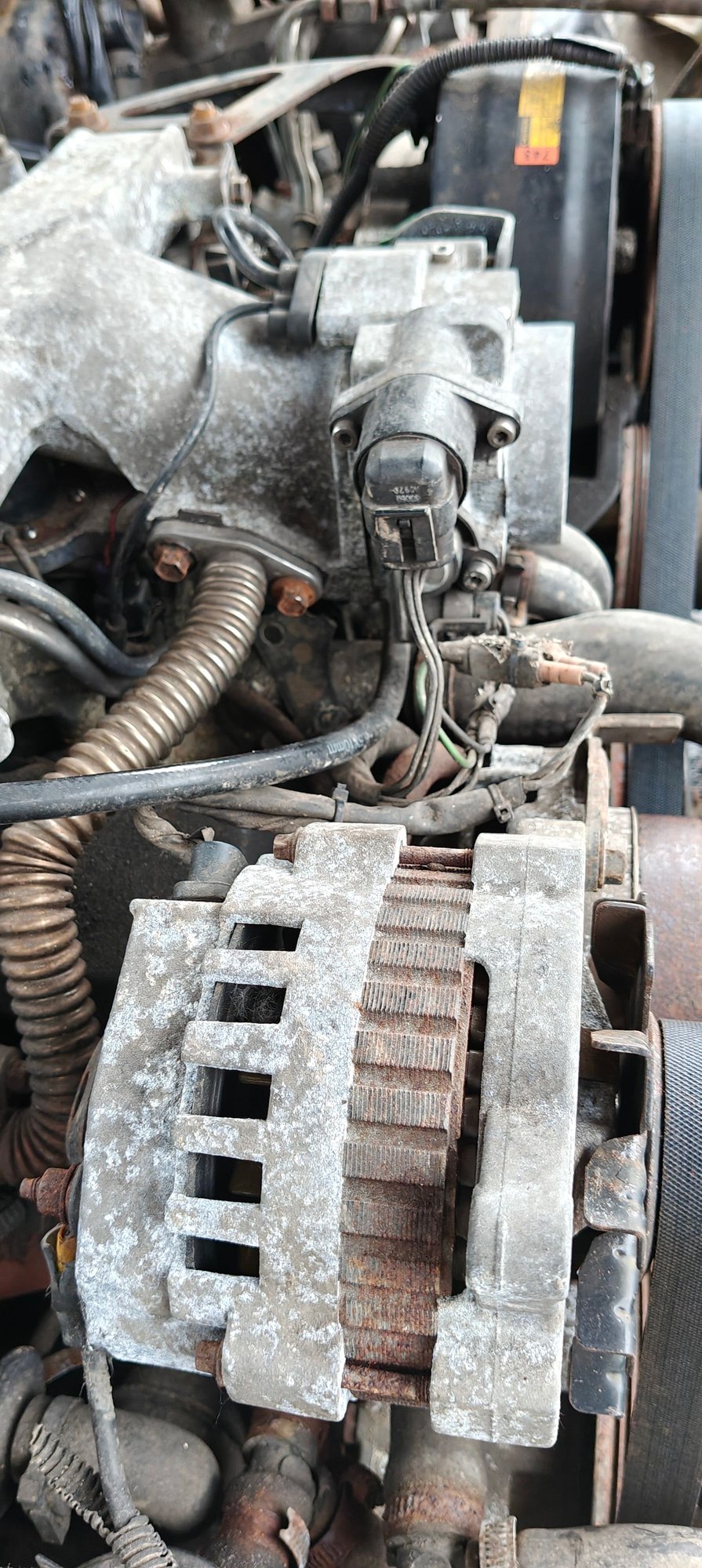

It has also no maf sensor? And the tps sensor located wrong? Chatgpt making me crazy 😅
It is speed density, I’m not seeing the tps issue

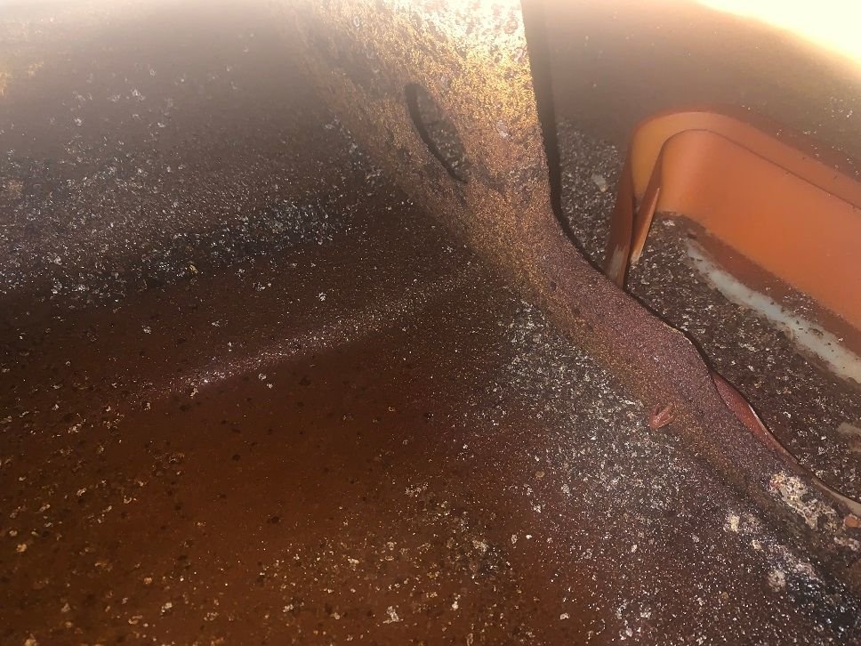

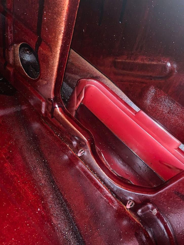

My 1986 2.8L MPI sat for about 30 years as well before I got her back into running condition.
1. When you replaced the fuel pump did the inside of the tank look rusty? Mine sure was so I had the tank repaired and a plastic liner put in to stop future rust.
2. Did you replace the fuel filter under the car?
3. On my car because of the rust in the tank the fuel injectors were plugged on the intake side. You may have to pull yours and inspect them. I changed mine out..

🤯 Blown fuse at inj1 fuse- slot
After the injector relay lost 12 volt power, I checked the fuses. The Inj1 fuse was blown... so that was the problem?
Replaced it, and the Firebird starts and runs like a charm!
  • After checking the inj2 fuse, I noticed that (without the fuse) there was 12V on both sides. Is this intentional, or is it still a cause for concern?
But for now I can sleep well tonight. 😅

Inj 1 and inj 2 don’t run through a relay. But who knows what was done with the cng conversion.
