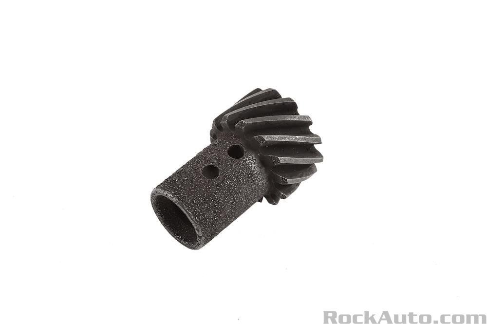

Your Accel HEI distributor may or may not have a melonized distributor gear. Of the 5 Accel large cap HEI distributors they have for sale from $125.75 to $171.95 nowhere do they mention "Melonized", "Melonite", or "Melonite/QPQ processed". They just mention "High-Quality Distributor Gears". If it doesn't have one of those Melonized gears and it eats the distributor gear all that metal runs through the engine's oiling system and everything the oil touches in the engine.
Seeing the price of those Made in China Accel HEI distributors one has to wonder just how much of a "High-Quality Distributor Gear" can you get when for twice the money or less you can get the entire Accel HEI distributor for what a quality "Melonite/CPC" processed distributor gear costs.
MELONITE / QPQ
A melonized distributor gear at first will appear like any normal iron gear. But if you look closely, the melonized gear (left) offers a mottled appearance on the collar while a standard iron gear is smooth (right). (Image/Jeff Smith)
I believe MSD Pro Billet HEI distributors use the 0.500 distributor shaft and the Accel HEI distributors use the 0.491 distributor shaft.
I would trust a Genuine GM melonized steel distributor gear to run against a Genuine GM cam gear on a Genuine GM 5150 alloy billet steel roller camshaft.
For $77.79 from Rock Auto plus tax and shipping the GM part is worth a lot of "peace of mind" over a Hung, Flug, Dung Made in China gear on the Made in China Accel distributor. Don't forget to use one of the Rock Auto promo codes posted on the Rock Auto Promo Code thread here on the forum for a discount.
GENUINE GM Original Equipment 456652 - Roll Pin, Distributor Gear
GENUINE GM Original Equipment 19432310 - Hardened Distributor Gear For .491" Shaft - (Old Style HEI , Coil In Cap) For Use With Roller Cams
GM GENUINE 19432310
GM GENUINE 19432310
Description
This melonized steel gear is required on all GM Performance Parts crate engines with a 5150 alloy billet steel roller camshaft.
If engine is assembled not using this melonized steel gear it may affect your GM Performance Parts crate engine warranty.
0.491 inch shaft size for use on old style HEI distributors with coil in cap.
I don't see any reason why someone couldn't run this gear on an older points and condenser Chevy distributor with a 0.491 shaft if for some ignorant reason someone wanted to do so.

I have both in my bin of extra parts. Both from GM. The melonized gear does have a "mottled appearance on the collar".

The GM "Melonized" distributor gears come in a smooth appearance on the collar and a "mottled appearance on the collar" version. Both versions are "Melonized" but the earlier version got the "QPQ" treatment on the entire gear and collar and the later version only got the "QPQ" treatment on the gear portion.
GM Genuine Parts 10456413 Distributor Gear_
GM Genuine Parts 10456413 Distributor Gear.
GM Genuine Parts 19432310 Distributor Gear. (1)
GM Genuine Parts 19432310 Distributor Gear. (2)
The gear on the top 10456413 was used in 1987 to 1991 C4 Corvettes with the computer controlled large cap HEI distributor with a 0.491 diameter shaft.
The gear below it 19432310 replaced that gear 10456413 at some point in time when it was discontinued. Maybe GM switched suppliers for the gears, or their supplier changed the manufacturing process for the gears. You will notice they aren't exactly the same gear. The smooth finished gear has the groove machined into the collar and the other one doesn't. I assume the new supplier saw no need to do the "QPQ" treatment on the collar and only did it to the part that matters. The actual gear teeth.
