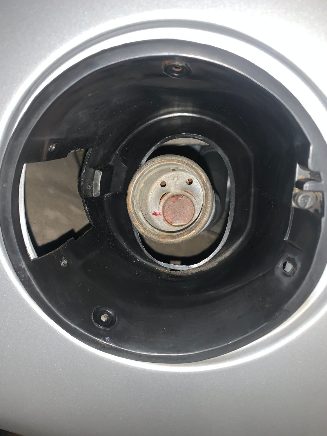

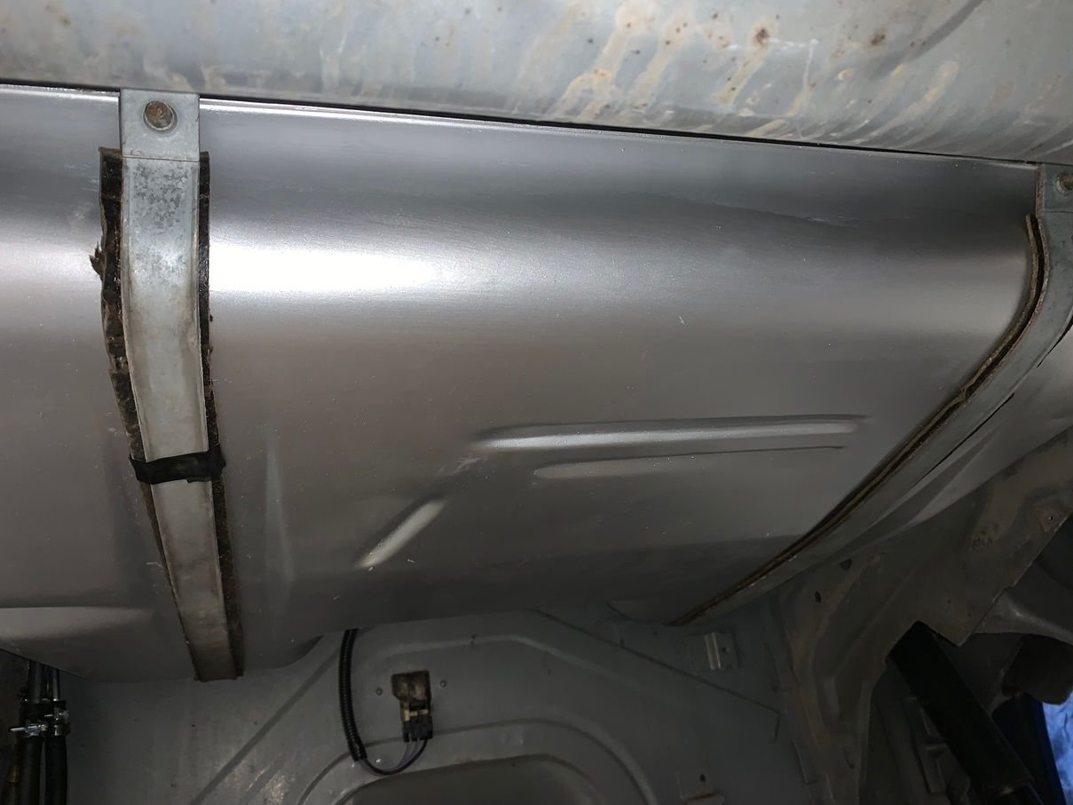

I got a Spectra tank from a local parts supplier. I spent a full 8 hour day just getting the old tank out with more that a few choice works and even invented new ones. I had the car on my lift, everything lowered and disconnected. Although time consuming getting everything ready to drop the tank, the bigest issue and most frustration was getting the neck out, probably spent 2 hours just trying to work it out. Last tank I did was on my 78 T/A and had the new one in and running in 3 hours. Not looking forward to installing the new one

Yeah, it sucks. Now is the time to think about an access panel. I wish i did one.
its an absolute miserable job. I had a harder time getting the tank in than out. I did a lot of cursing putting it in. Good luck!

I had the entire rear end and exhaust system out of the car when I installed my new tank and it went in pretty easy. I'm sure that's how it was done at the factory as well.
Remove the muffler/tailpipes and drop the rear end down as far as you can and it should go OK.

exhaust was completely out, axle was dropped as far as it would go and I still had a lot of trouble with the neck. Im thinking GM may have made slight changes were the neck goes through in later models.
Definitely not. Same stamping dies for all the body parts for all the years. Mass-produced, engineered once and built about a million times over 11 years in 2 different factories.
It's just imperfections in the replacement parts, coupled with, the gas tank was probably installed into the car on the production line, at some point where something or things that gets in the way when you're replacing it, wasn't on the car yet.
Go visit a vehicle assembly plant someday and you'll see what I mean. EVERY car moves down the line at the same speed. EVERY part is put onto the car as it rolls down the line. The car spends the EXACT same time at EVERY workstation where an operation is performed. The "official" name for this is the "takt time". It's adjusted, within some certain range, as production demands change. It's usually measured in SECONDS, not hours, or even minutes. Now, it helps to ALSO remember that things are already partly assembled when they go into the car. For example, they don't put the seats in before the dash; they don't put the dash in at one workstation, and then the worker lays on their back up under it at the next, putting the harness in, and plugging plugs into stuff that's way up in there; rather, the wiring is ALREADY on the dash, and when they put the dash in, it's like 3 screws and 2 big nuts, zip-zip-zip-zip POWER TOOLS, and then at subsequent workstations they mount the fuse block to the firewall, plug in other "assemblies" such as the HVAC system as they're put in and their plugs appear, and so on. Everything is done in an order such that nothing gets in the way of anything else, and everything goes in, in ... however many seconds it is. Including the gas tank. 43 seconds or whatever it is. 43 seconds per seat, 43 seconds for the rear axle, 43 seconds per brake assy, 43 seconds for the hatch, 43 seconds 43 seconds 43 seconds (or whatever it is).
Learn how mass production works, and how to work WITH it in your mass-produced product, rather than AGAINST it. I suggest the Corvette assy plant in Bowling Green KY as your introduction, since if you're gonna watch cars getting built, might as well be Vettes, eh?? not Escapes or something.

I removed the exhaust system and dropped the rear axle down as low as it would go, removed the gas fill door and the plastic trim piece at the filler neck but it was still a bit of wiggling and twisting to get the tank back in to the car.
It doesn't help when your laying on the floor and working blindly over your head but it is doable.
I replaced the fuel pump and sender, had a plastic liner installed and then I painted the tank before I put it back in, so hopefully I won't have to go there again for a long-long time.

Your probably right but if they made the pass through for the neck just a couple inches larger I would not have created new words
