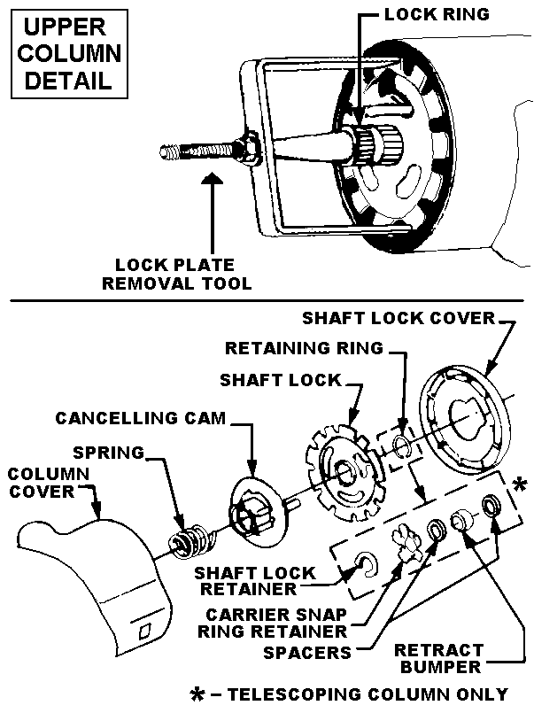

Remove the steering wheel and lock plate.
Remove the turn signal cancelling cam.
Remove the HAZARD signal button and turn signal lever screw.
Remove the turn signal switch.
Remove the lock cyninder buzzer contacts and lock cylinder pin/screw and slide the cylinder out of the column.
At this point, you may be able to test the lock cylinder with the key to make sure the cylinder will move far enough to start the engine. If the lock cylinder binds, the cam plates in the cylinder are probably damaged and you'll need a new cylinder. If the cylinder rotates freely past the point where the engine would crank, continue.
Using a large screwdriver in the recessed slot of the sector gear, try to turn the sector enough to start the engine. If there is any binding or interference, don't force the assembly or you'll risk breaking something even worse.
Carefully unplug the VATS connector on the lock cylinder and remove it completely. Remove the upper steering column trim cover screws and lift off the trim cover. You should expose the sector gear and rack assembly, along with parts of the starter interlock device. Inspect them closely for distortion or damage. If the assembly appears to be intact, remove the sector gear and rack, and try to start the engine by raising the actuator rod with a screwdriver or pliers. If the actuator rod cannot be moved far enough to start the engine, you'll have to remove the lower steering cloumn trim and lower the column from the dash to inspect the switch, interlock, and acuator rod. There is little left after it is that far apart, and any problems at that point should be readily apparent.
When you reassemble the column, it would be a good idea to lubricate all the mechanisms with a white lithium grease, such as Lubriplate. Lube the linkage rods and guide, sector and rack assembly, turn signal switch and cancelling cam, and any bearings you may have exposed. Be careful to route the wiring away from any moving parts as you reintall the devices.
Good luck, dude. Hope you get lucky and find it easily.
Attached Thumbnails Key won't turn in ignition past "ON" HELP!!!! vader??-columnlockplate.gif

Autozone usually carries those tools for rental if you dont have one.
