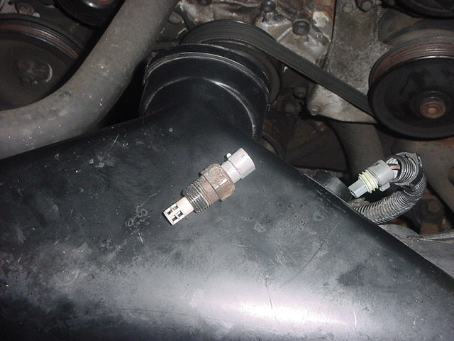

... where I live they shut down emissions for awhile to change the system or somesuch ... don't need a vehicle inspection until my car is 25 years old either ... finally getting insurance on my car by the end of next week, woo .... I'm having an issue with Code 34 as well. I disconnected my MAF sensor and my car still runs like crap, seems ok if I'm pushing it, but it's not a very nice idle. It almost dies out and then revs back up to life :sigh: I'm going "shopping" tomorrow too ... just gonna look around the local junkyards for some of my cars ('87 Camaro 2.8L, '89 Beretta 2.8L, and an '85 Buick Skylark ) Skylark has carb-linkage issues ... and I'm not buying a new carb for it ... I'm trying to sell it anyways :\
So has anyone found any places where vacuum leaks occur more commonly than others? Any help would be appreciated

Sorry, I'm new to all of this .... What's this sensor for?
