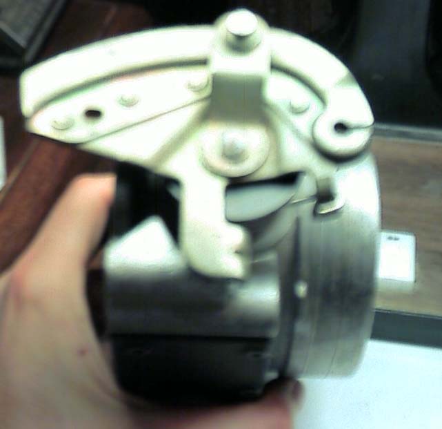

We'll see how this turns out. My digital camera is a piece of crap , but here goes. This is the LT-1 TB. Most of you already know what the TPI TB looks like.
Attached Thumbnails Differences between the TPI and LT1 throttle bodies?-lt1.jpg

What year LT1 TB is that? If I'm not mistaken, the first model which would have been '93 looked more like the TPI TB on the throttle side because they used the 4L60 tranny which still used the TV Cable. After GM, switched to the 4L60E in either '94 or '95, the TV Cable was gone and they switched to the throttle bracket like the one you show in your picture. I could be wrong.
Old May 19, 2002 | 01:28 AM
rockind78's Avatar
Joined: Jun 2001
Posts: 355
From: Michigan
lol.........you just answered my question. I was wondering what year it was!!! I thought the guy I bought it from said '95, so what you said would make sense. I hope this it at least kind of answers your question.

Thanks! I know the later LT1s and the LS1s had the throttle cable bracket like the one on your TB.
