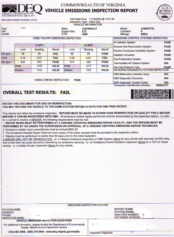

Hi All,
I need you help please. My car just fail emissions today. I have a print out copy attached of why. The can runs great, healthy for the most part, but i gutted out my center CAT a while back ago and left the other two cats under the headers alone. this is why it's failing. is there anything at all i can do to get it to pass with out buy a new cat? I have access to my chip and can make many changes. What can i do to get a pure pass without buying a cat. I'm trying to hold off on the cat because i want to save up for a full exhaust system this coming summer.
BTW i tested it with my stock factory chip..

test results

I asked the inspector if i retard the timing and lean it out will it pass he said then it will fail NOX. any thing will help please

You are close on teh hydrocarbons, and could probably do some tuning to eek by on that, but dropping the CO is going to require a lot more post-combustion air and/or a converter.
You have three converters on the system?
