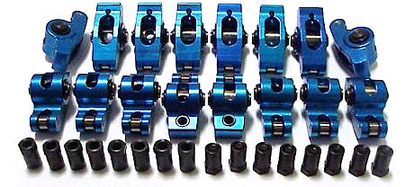

self aligning roller rockers have a guide or flange you could call it at teh tip were as non aligning rockers have none
I've attached images to show aligning and non(well trying anways ) gold ones are the non aligning and the blue ones are

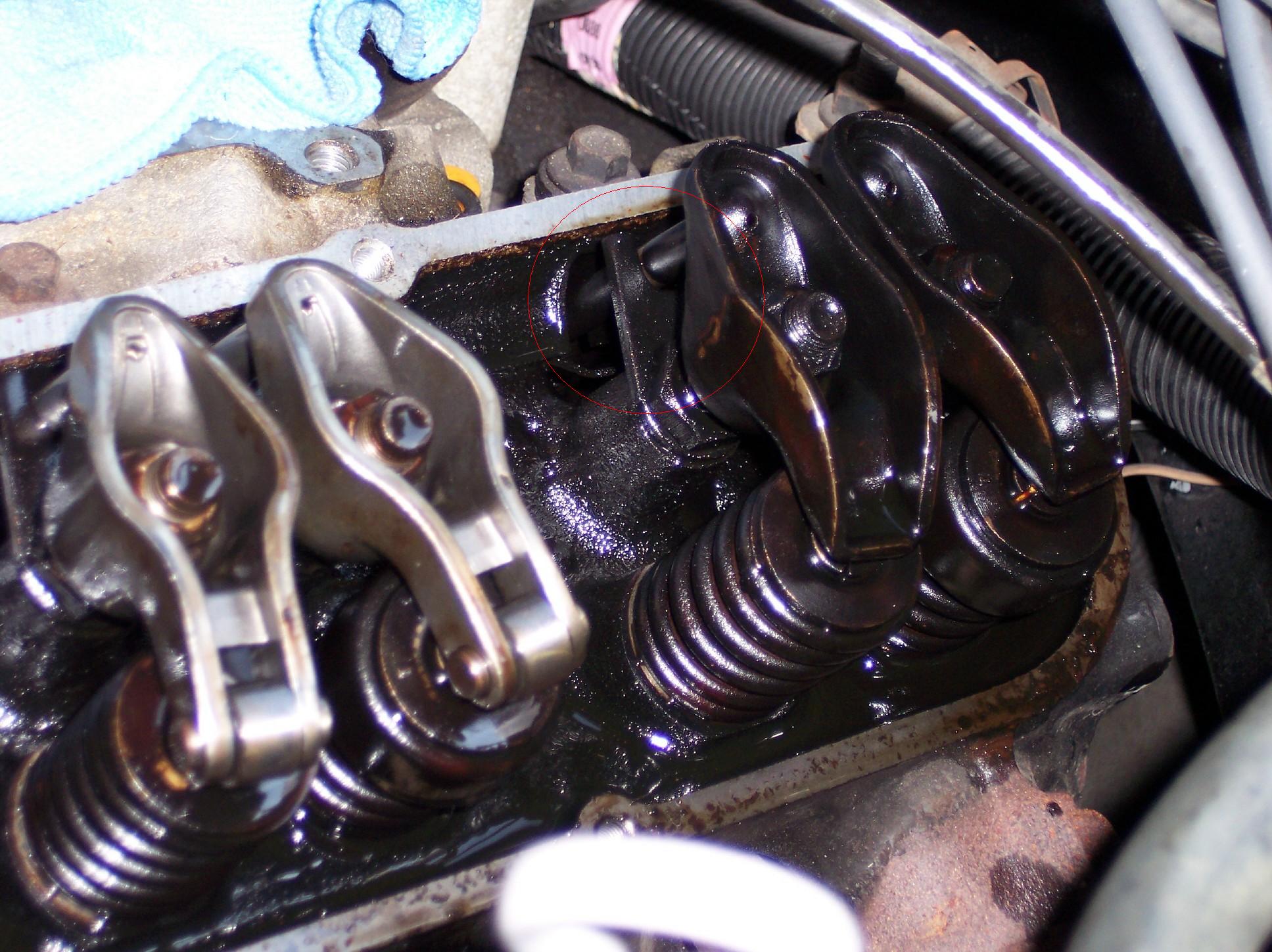

Hey, brian. Unless you know your heads, it's hard to say without looking. Non-self aligning rockers have guideplates that are basically a flat piece of metal with two "u's" ground in them to hold the pushrods vertical.
I haven't taken the valve covers off a SBC 3rd gen yet, do you have to remove the upper or middle to get the covers off (we have to on the V6)?
If not, just pull the covers and look real quick.
