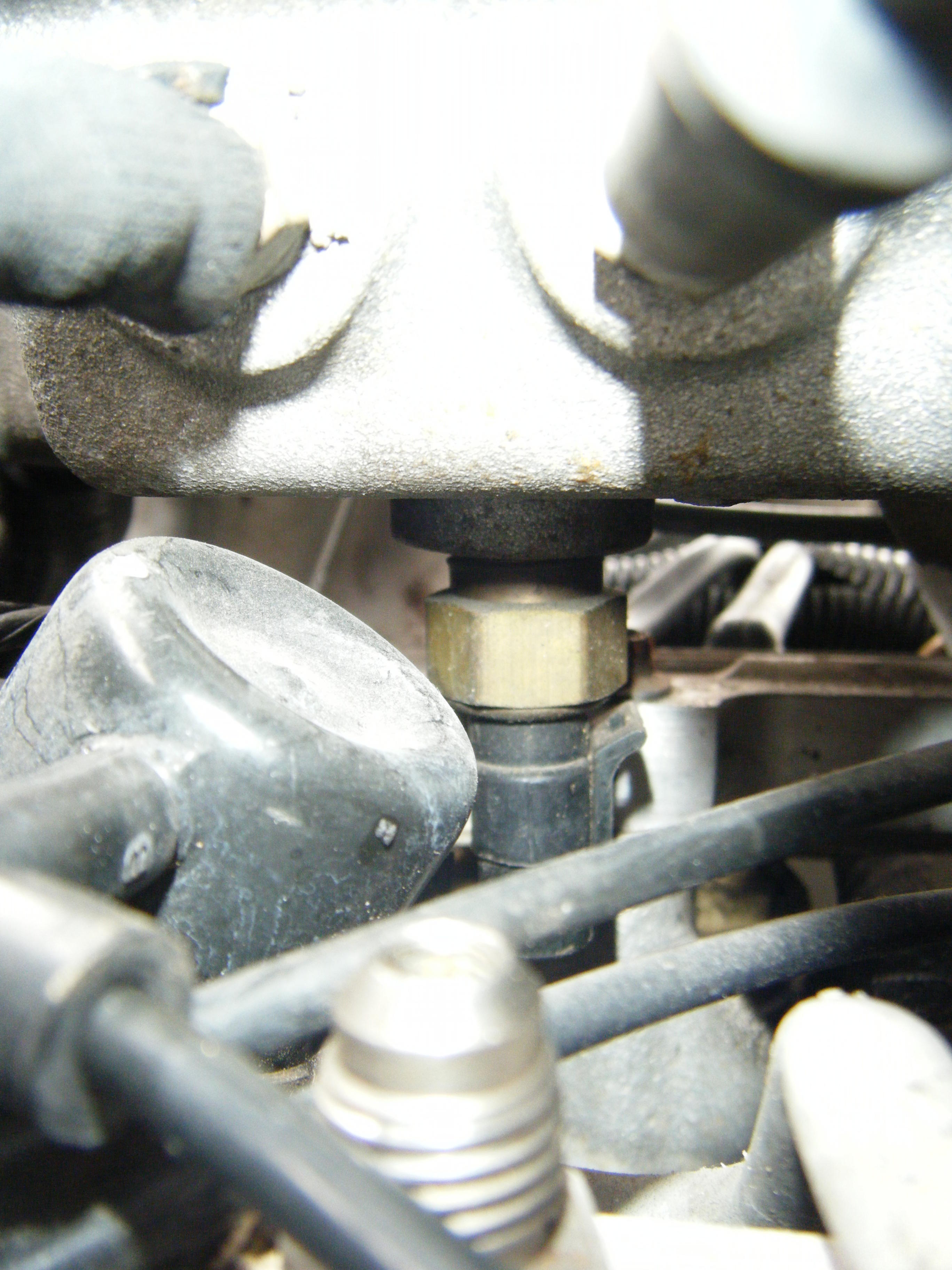

I have 3 bad injectors so I took off the rail tonight.
The bolt that holds the fuel lines on at the front of the block is really fun to get at !!! (it was easier to remove the water neck)
I was able to remove the EGR and and get the Rail out without removing the intake runner on the pass side !
I'm installing 8 new 19lb Ford injectors !
* Yes, I know it needs cleaning....but, Hell, I just bought it last Monday and it broke 4 days later !

When you put that thing back together could you get a pic of where your Manifold Air Temp Sensor MAT or sometimes called Idle Air Temp IAT sensor hooks into the harness. Ive been trying to find this forever cant seem to find it. Heres a pic of mine and the wire coming off of it.
and
Good luck with the rest of the fuel injector changeoever
Mines about 18" long and comes off the back of the upper plenum and it heads over towards the brake booster.
Its not 'in' any harness, it runs all by its self !
