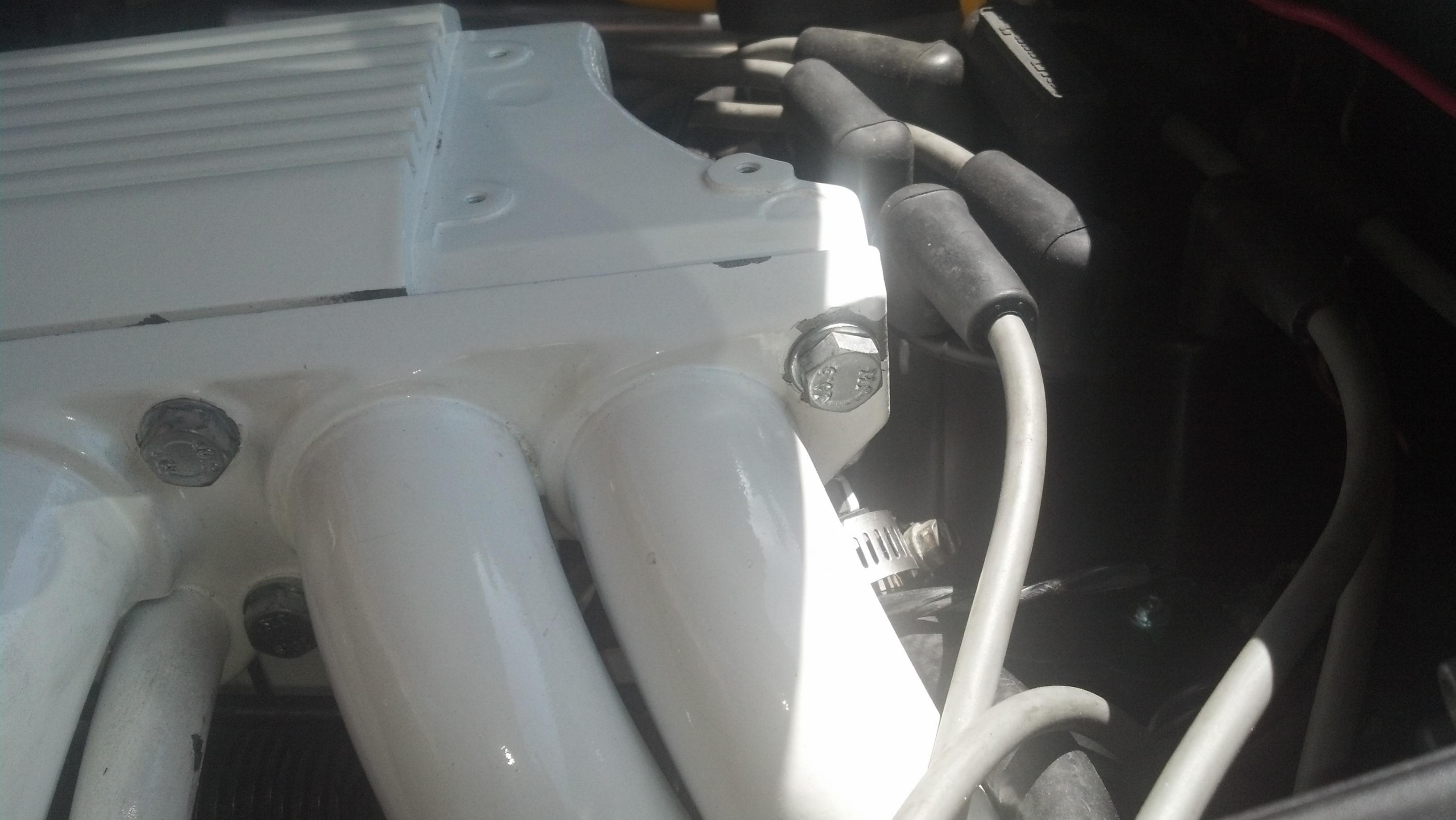

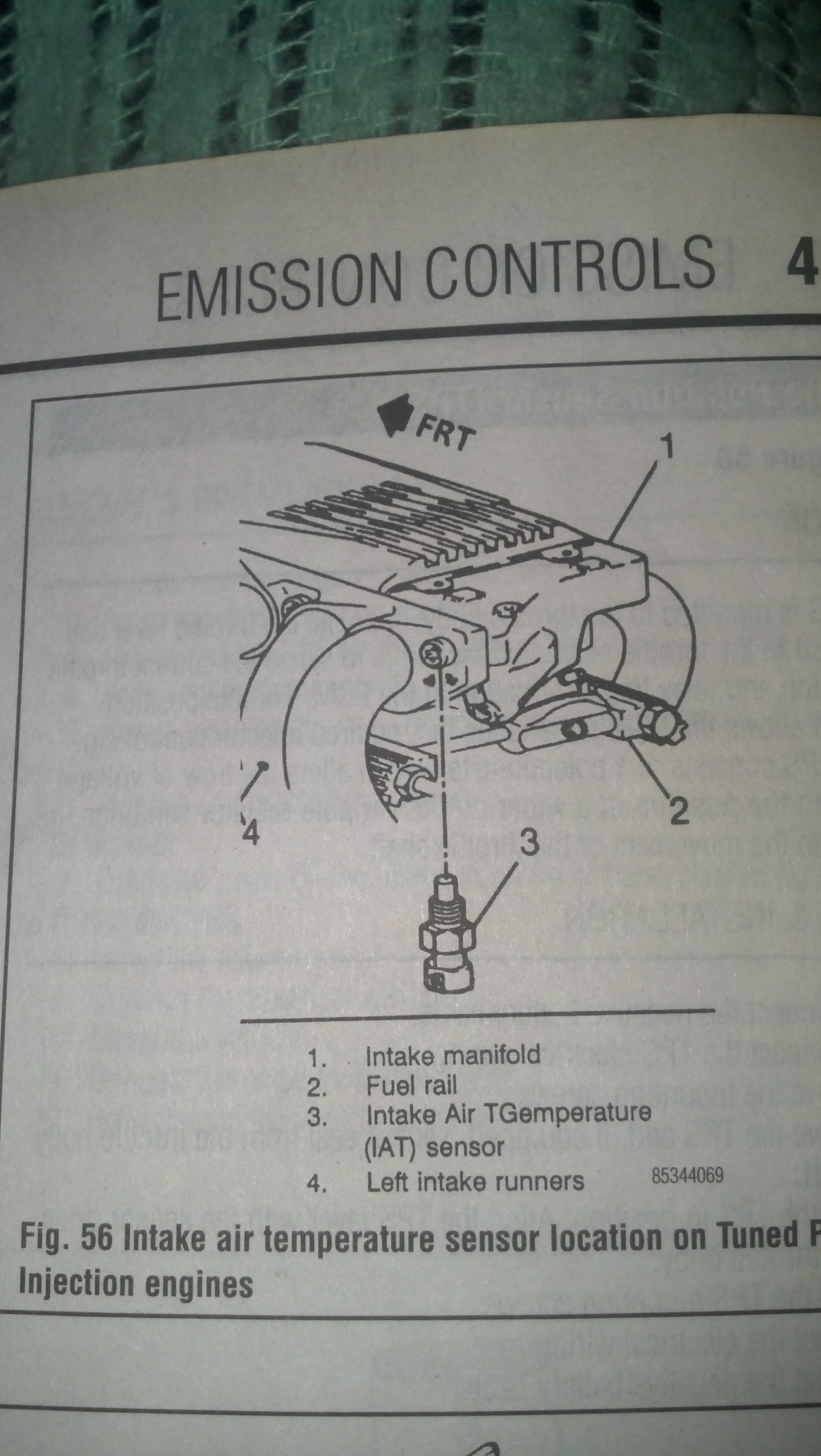

Doing some research I found that there should be an air temp sensor on the rear of the plenum for all tpi engines 87-89. Is this true? When I bought the car, my engine was in a million pieces so I don't have anything to compare it to. I just have a bolt where they show a sensor... And then I have the 2 sensors below the throttle body
Old Apr 27, 2013 | 01:18 PM
killerzombie's Avatar
Joined: Apr 2013
Posts: 27
Re: no acceleration
Here is a photo of my plenum if it helps

all Tpi engine use the mat, these is a extension from the harness to connect it.
gm 15326386 or acdelco 213-928 it is the same as your cts.

Okay I found the sensor on my plenum. Its hidden on the bottom side next to the egr. I was wondering if I could test it with a simple resistance test to see if its working...

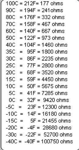

Have you hooked a scanner , to lok at the tps, cts and mat , maf readings ? Does this happen when the engine is cold and at operating temperature ? If just warm have you verified CL operation ?
