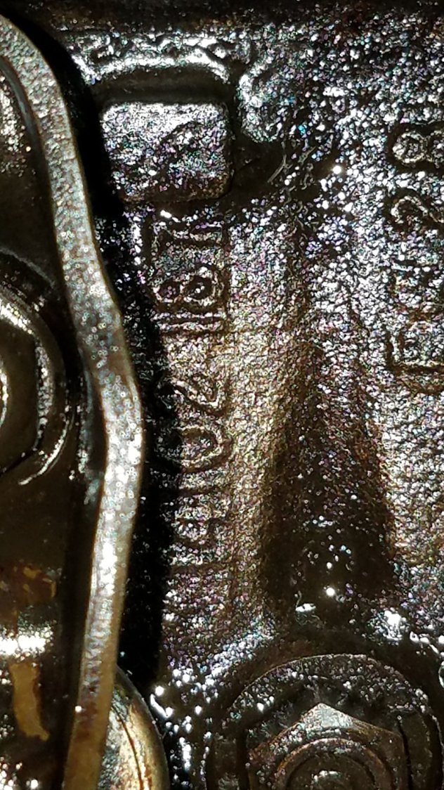

I was just getting ready to decide on weather to replace valve seals on my L98 G92 Iroc and found that 14102187 heads are on my 350. So I went ahead and checked to see if I STILL had a 350 (and I do) and found some #'s
Arn't these heads for a 305???
#'s Stamped by water pump
14102187 heads on 350????
350 Block

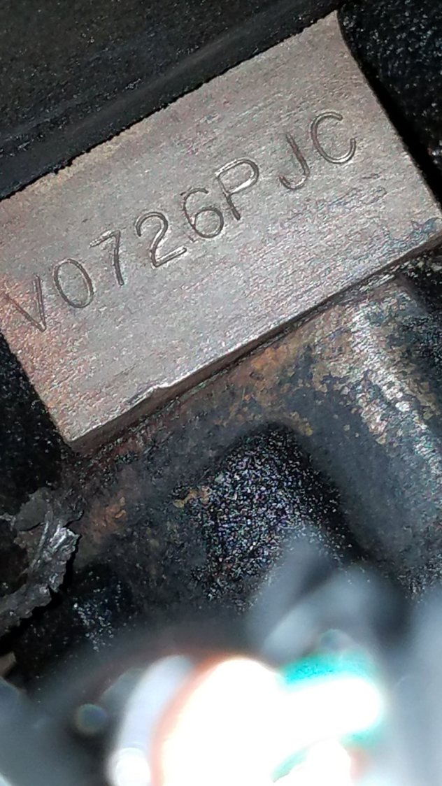

No cast #'s????? I was once told that this was original engine.... I am going to assume that that info was very wrong!!! PJC engine suffix code.... anyone know what that is. I can not find it anywhere online.
Google says it's an 88 Truck engine, but you know how that goes.
On that same pad you should have a partial VIN stamped. If the VIN matches the car, the block is probably original to the car.

Can't see behind passenger side yet... found 638 st
stamped on the front though. Also read partial VIN may be stamped by oil filter.... will check for that soon.
looks like 638 stamped on front of block.

Not to rain on your parade, but I'd also question whether the engine is original to the chassis.
AFAIK, the last six (or eight) characters of the VIN that appears on your invoice should be stamped along with the engine code on the engine block "pad", if the engine is original to the chassis.
I've attached a photo of my engine block stamping and invoice for comparison.
Where engine code is, I do not see any evidence that the VIN was ground off. I have one more place to look..... I found this on another stite, " I have located so far are, 638 located on the lower block side above the motor mounts. and near the oil filter stamped 183551" .....I will look here today.

The 14093638 is a 87/95 block used in cars and trucks so it might be the original block.

638 block is typically a 350 tbi/TPI block. If those were 350 truck heads that motor would be great in a tow rig lol
