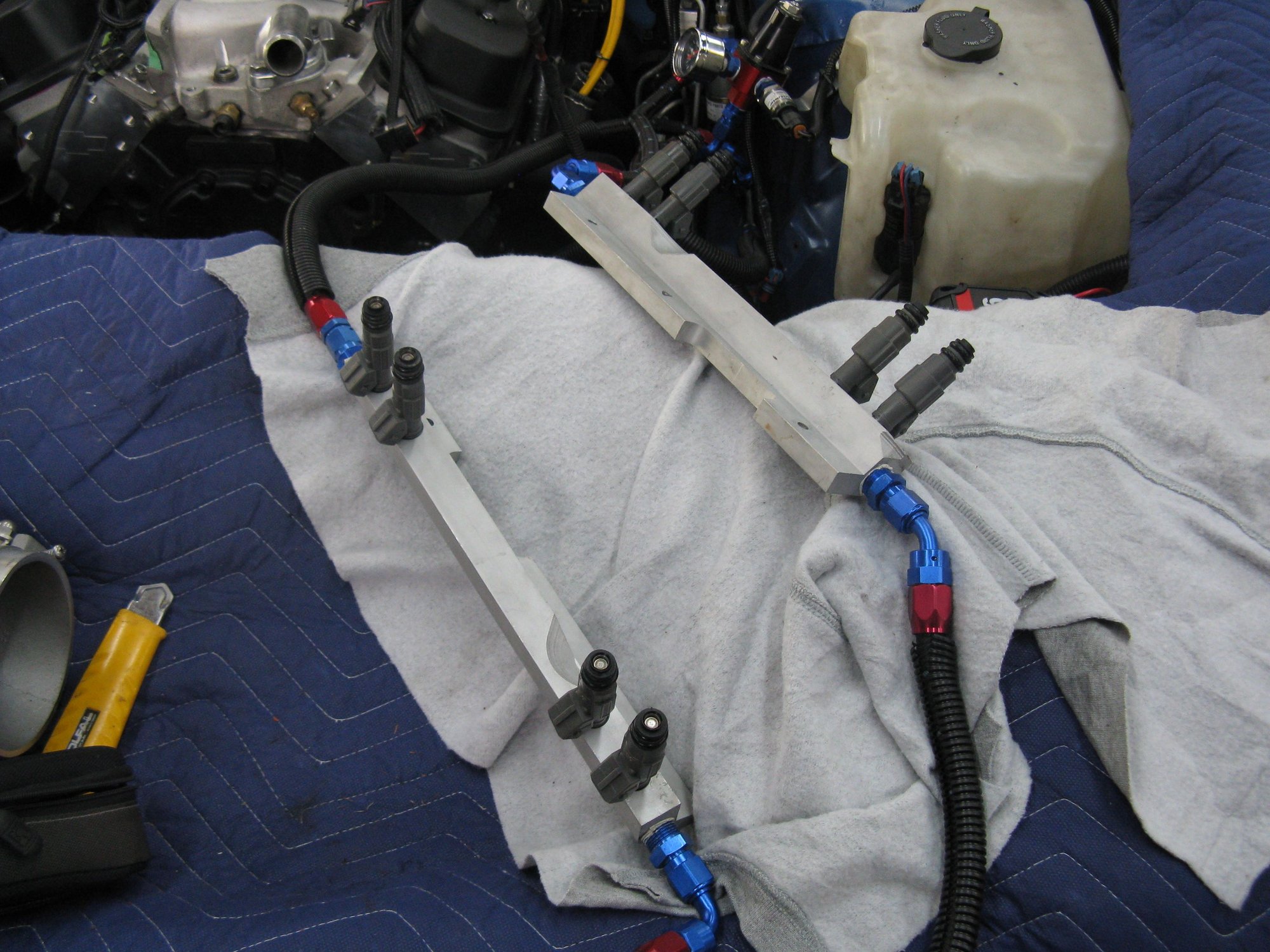

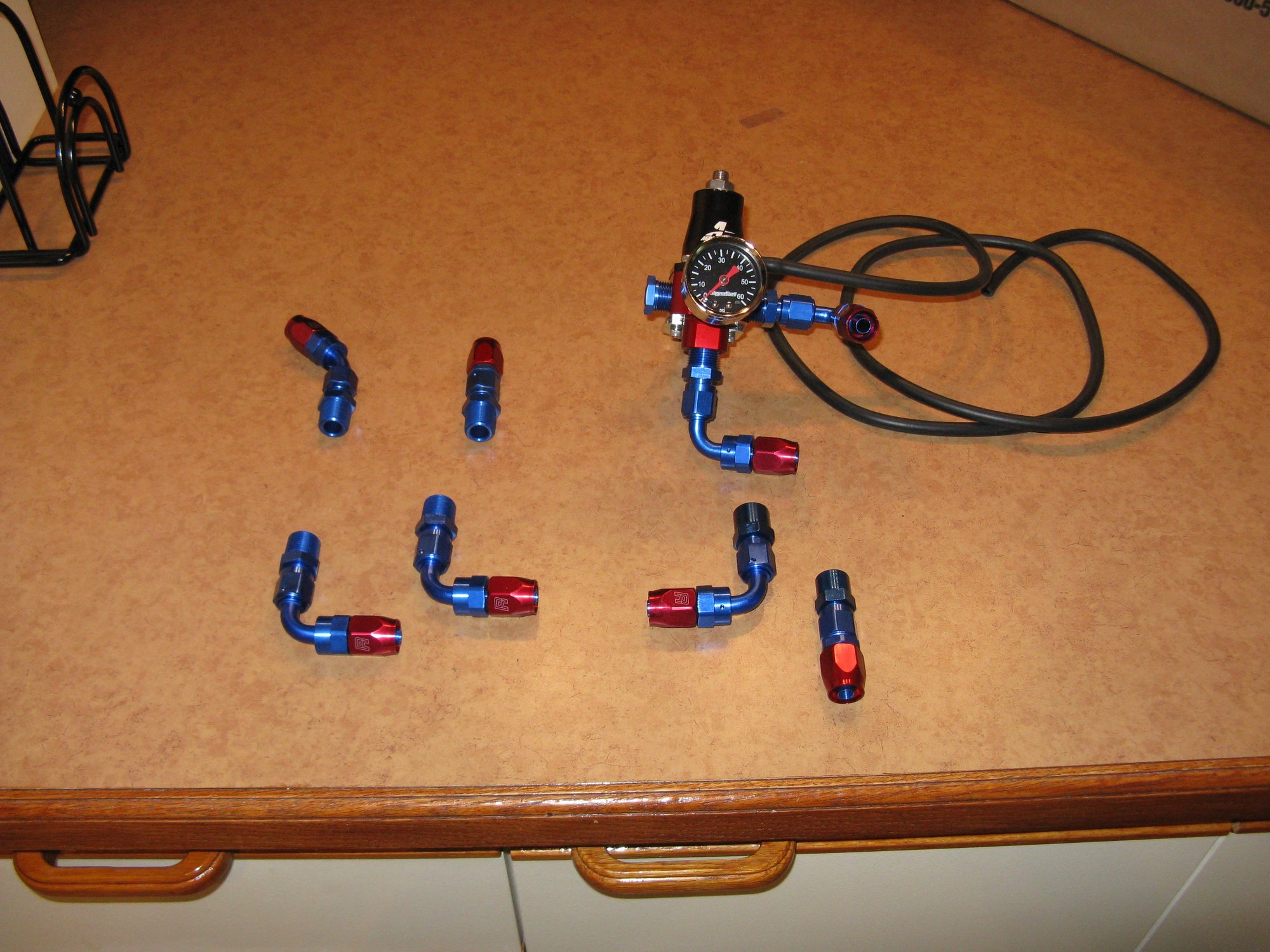

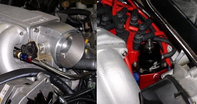

Some of the stuff I needed. You basically have to custom your fuel lines, Fuel Pressure Regulator and gauge, vacuum hoses, EGR if applicable, PCV hoses and valve, EVAP hoses, IAC disconnect harness, some wire reorganizing and coolant hoses. Might have some hood clearance issue to fix. I used flared fitting for fuel lines for safety and MVB regulation compliance. If you have any questions let me know. Cheers

FPR Aeromotive #13301 with Russell fittings

Sweet! Thanks for the links and the pictures. I'm going to use some different brands due to matching my color scheme, etc but I will setup the -6 AN lines similarly to what you did. I'm going to connect the rear of the fuel rails together using some 3/8 NPT 90 degree barb fittings as I'm running a small cap distributor so they should clear that just fine.

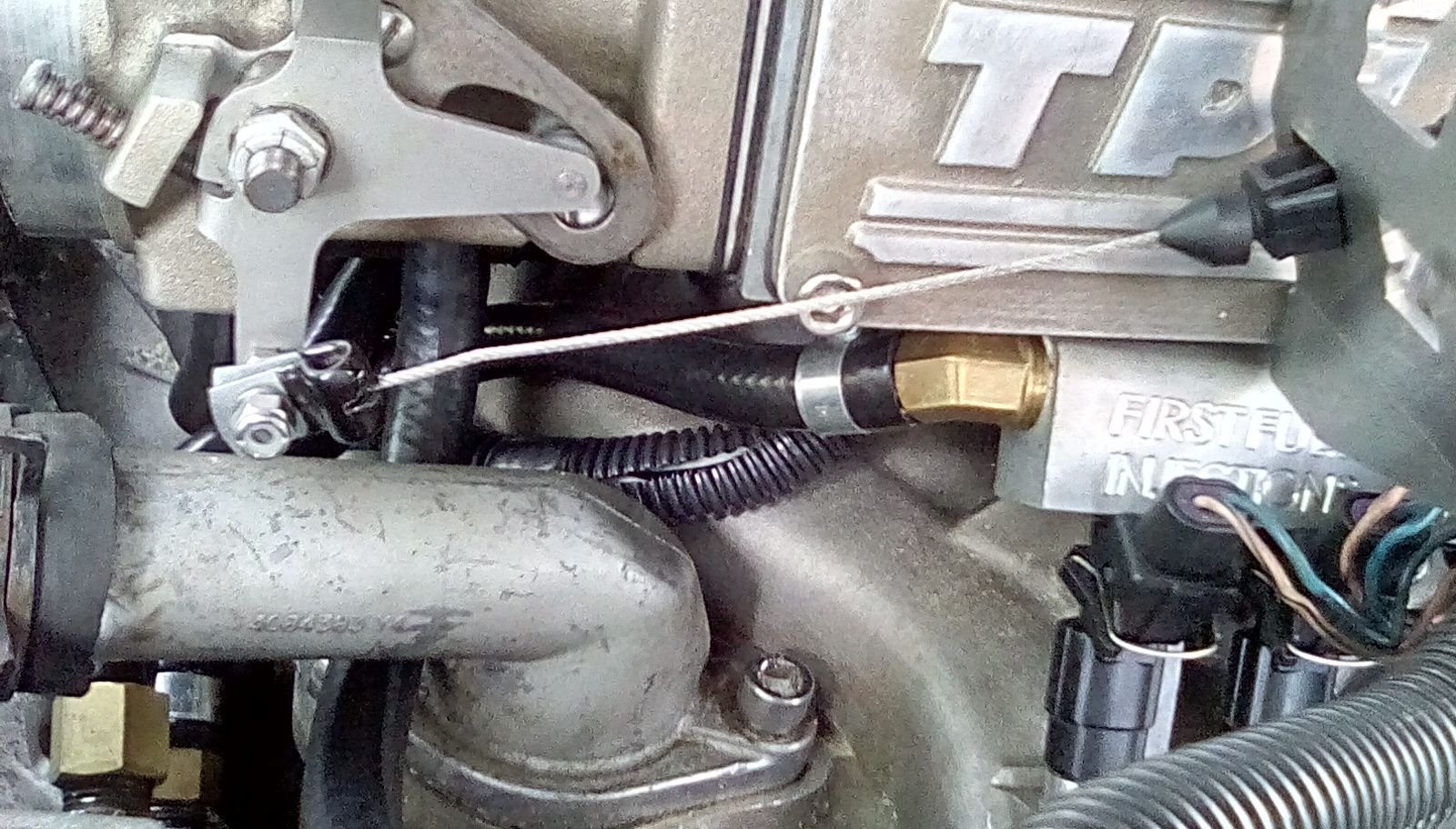

I ran my fuel lines and regulator to the backside of the motor and put the loop in the front. It takes a lot more time but is a much cleaner install.

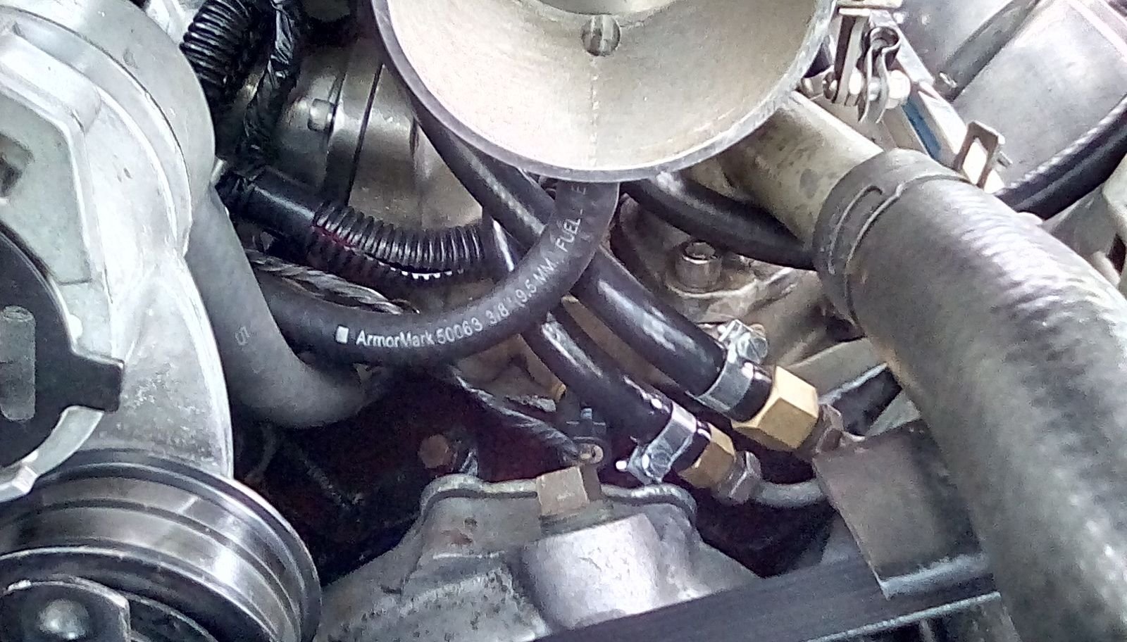

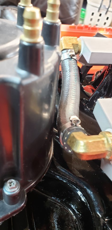

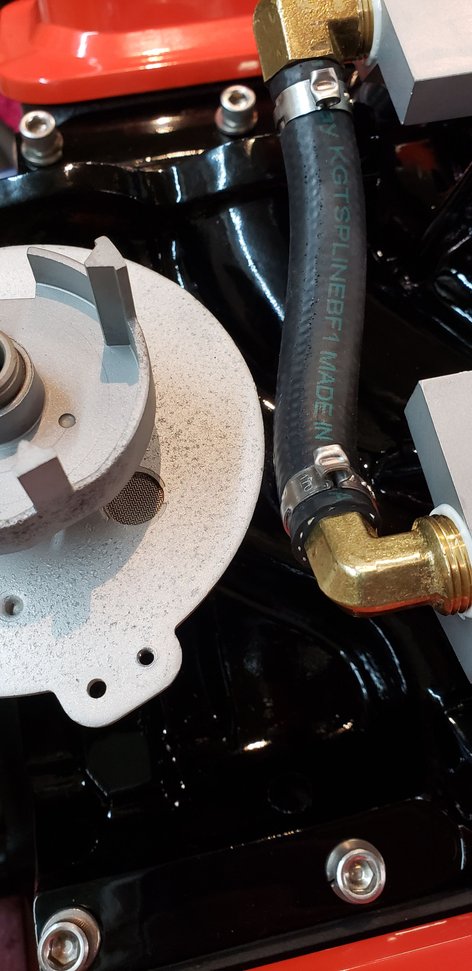

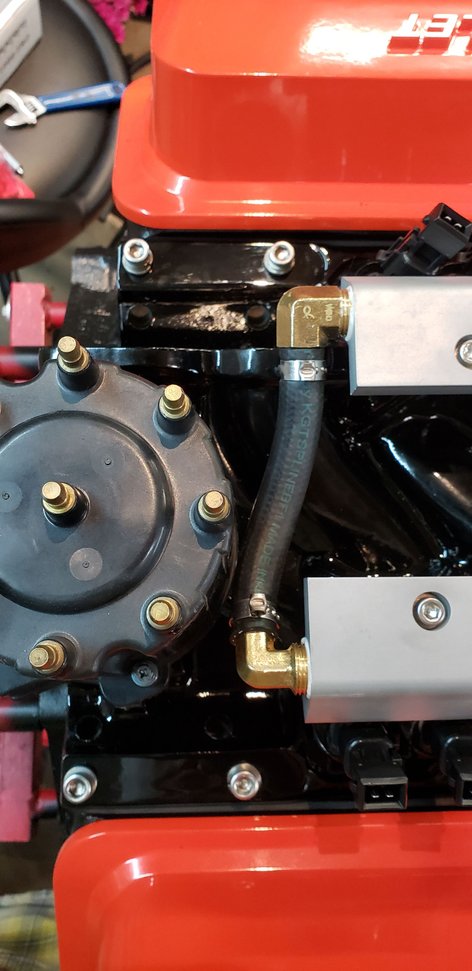

I just installed mine within the last month. I hooked up the fuel rails to the tpi hard lines in the front of the engine. Used a 45* barb in the drivers side rail to clear the throttle body. The rear rails are tied together by 90* barbs, but they are angled downward for a little more distributor cap clearance. So there's a slight bow to that line. I have a small cap dizzy and have 1/4 to 1/2" of clearance. I spliced in an Aeromotive Fuel regulator in the rubber return line just above the steering box. It looks pretty clean to me, and it runs very smooth.

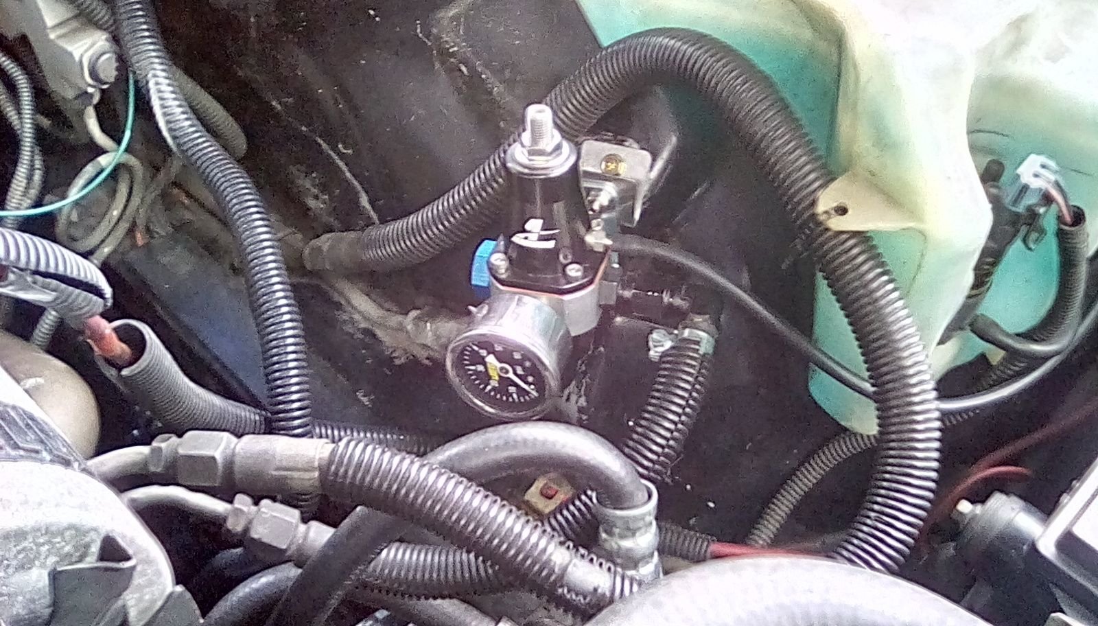

Sounds great!. Any pics?
Here's mine. The AFR has a sensor for Autometer Fuel Pressure Gauge on A Pillar and vacuum line.

If the 90* barbs didn't work out, I probably would have done a 90 off the passenger side rail like you did. But instead of looping behind the dizzy, I was going to take a 180 fitting and route the line back under the fuel rail and connect to the drivers side end. Yours does look good, probably flows better than mine. I also put the MAT sensor in the air duct instead of in the plenum.

I'm also in the works on building my TPI355 with a FIRST. I have some issues you maybe have some ideas to.
I use the same fittings as you SbFormula but somehow they strip out the threads of the fuel rail. I just screwed them in by hand until they got tighter and then did test fitting. I wanted to unscrew them by hand as I just put them in by hand but they soon got tight and I had to use a wrench to get them out and the threads were all stripped. I checked they are correct and they are. Did you guys ever unscrew a fitting from the fuel rail and this happened?
I used replacement injectors from southbay. The fit good and the fuel rails sit flush with the mounting boss were you screw in the bolt, so they can't go any lower. However the short fitting (barb connection) hits the plenum and it's difficult to actually put on a hose and I don't like it rubbing constantly on the plenum. Is the clearance tight on yours too?

"I use the same fittings as you SbFormula but somehow they strip out the threads of the fuel rail. I just screwed them in by hand until they got tighter and then did test fitting. I wanted to unscrew them by hand as I just put them in by hand but they soon got tight and I had to use a wrench to get them out and the threads were all stripped. I checked they are correct and they are. Did you guys ever unscrew a fitting from the fuel rail and this happened?"
That is weird!!! I don't remember having any issues. I did assemble everything first to custom the fuel lines but did not have any issues. I remember it getting tighter because I believe it's tapered. Maybe you want to check with Ken at First. He's very helpful with that kind of stuff. Ken@firstperfcenter.com
"I used replacement injectors from southbay. The fit good and the fuel rails sit flush with the mounting boss were you screw in the bolt, so they can't go any lower. However the short fitting (barb connection) hits the plenum and it's difficult to actually put on a hose and I don't like it rubbing constantly on the plenum. Is the clearance tight on yours too?"
No clearance problem. I used the swivel fittings and custom cut the fuel lines. The fittings are long enough to create clearance. That's why the back hose is so long and attach to the firewall. I did not want anything rubbing or being squeezed. I was not a fan of the the short barb fitting with rubber fuel line and hose clamp. I wanted everything flared. Just my preference. I could not afford an engine fire, specially when a hose is rubbing.

Re: FIRST manifold installation tips on factory TPI cars?
A barb coming straight out from the rail would have hit the plenum. I ended up using a 45* angled barb. So it's pointing down and toward the passenger side. And I have spacers between the rail and mounts.
JJ63: Where did you get the GM fuel injection to barb fittings? I have found the fittings for -6AN, but those brass adapters you have and reusing the front metal feed lines behind the alternator is excellent! I would like to try mocking that up on my setup.
GD
This is the 90 hidden rear rail:
Amazon Amazon
45* barb front driver's rail:
Amazon Amazon
Straight barb front pass rail:
Amazon Amazon
90* rear pass rail:
Amazon Amazon
Barb to front tpi hard line feed:
Amazon Amazon
Barb to front tpi hard line return:
Amazon Amazon
I did the same thing with my install. I wanted the fuel in and out @ the rear of the intake and use an Earl's 90 smooth bend and had to bow the line downward.
I went with Bosch IV injectors (36lb) with the adapters back to EV1 from FIC. Got the offset data by asking.
Holley adjustable fuel pressure regulator on the fuel rail output.
Height of the electrical connector means a few injectors are angled just slight off of 90 degrees but not too bad.

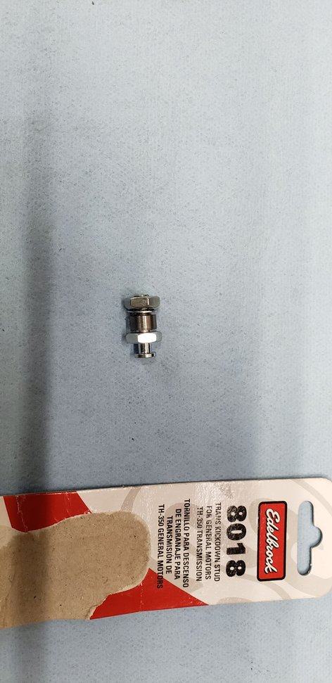

Been working on some plumbing and small details while I wait for the throttle/cruise pin from Ken @ First Performance (amazing customer service - highly recommended anyone interested send him an email).
For my application running the 700R4, I need the TV cable throttle pin to attach the factory cable. I ordered the Edelbrock 8018 throttle pin. It's a little too long out of the package but also that has the advantage that it could be spaced out just a bit and better centered on the cable bracket. I turned up a small spacer on my lathe. It's just some round stock with a 1/4" through hole. It's 0.190" long if anyone wants to make one.
I'm going to run my fuel lines to the front as was done on the stock TPI. I feel it will be cleaner and easier to access. Opinions on this vary. There is clearance in the back with a small cap distributor to do this cleanly. Here's the setup:
This is done with Earls vapor-guard 3/8" hose, Trans Dapt brass fittings, and Oetiker ear clamps for low-profile, even clamping force (these are tongue and groove clamps).
