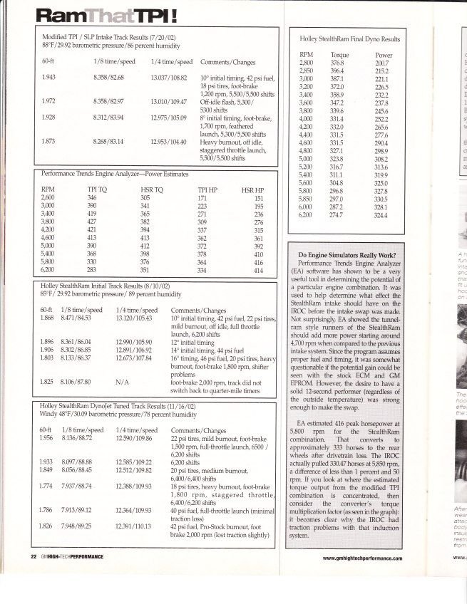

I'm the original owner of an 85 Monte Carlo SS. It has had a couple carbed 406s in it but no 383 with HSR. It's been setting up for about 20-years with me working on a frame-on restoration here and there for the last 10-years or so (unexpected life issues happen). I do have the new 406 built for it and will be converting it to EFI (mostly completed) to run a fully ported and siamesed runner FIRST. Hopefully I will have it all back together and painted in a year or so.
What you may be thinking about is the 355 IROC I built in 2002 for the wife. I was one of the first to do a tech article on the StealthRam back in 2003 for GMHTP. They later republished the article in Super Chevy and they have Part 2 on their website.
http://www.superchevy.com/how-to/030...third-gen-iroc
Here's what they left out of the online article, which is the real meat and potatoes
Originally Posted by Whitebird75
I would love to see the FIRST TPI tested back to back with the TPIS ported intake and the stock intake. It appears the TPIS long runner intake is no longer available, so maybe the FIRST is a better replacement?
Not long after doing the HSR article, I tried to sell GMHTP on the idea of a FIRST intake article like I did with the HSR. I was going to do the swap anyway and was hoping I might be able to recoup some cash. They wouldn't commit to the article until I did the installation and reported the results. Once I did, they declined - I wasn't going to do any dyno testing unless they planned on paying me, so there is none for the FIRST. This is entirely my opinion based on what feedback I received and what little experience I have with magazine companies. Basically I believe since the company (FFI) was not an affiliated advertiser and the results were so close to the HSR that they felt like it might cause issues with those that were (Holley).
Anyway, no dyno numbers but solid track data on the three intakes (best results in similar conditions)
TPI / SLP Intake (fully ported GM base and ported SLP runners to the 1/2 way point)
(7/20/02) 88*F / 29.92 barometric pressure / 86 percent humidity
8* initial timing, VERY heavy burnout, foot brake off idle, staggered throttle launch (pumping the gas well past the 60ft mark), 5,500/5,500 shifts. Practically impossible to launch with the base timing at 10-degrees – dropped timing 8* to help hooking, 6-degrees helped 60ft, but really killed MPH
60ft------ 1/8 ET -----MPH ------ 1/4 ET ----- MPH
1.873 --- 8.268 ----- 83.94 ---- 12.953 --- 104.40
Holley StealthRam (minor clean-up, rolled the top edges on the base intake)
(8/10/02) 85*F / 29.92 barometric pressure / 89 percent humidity
16* timing, 46 psi fuel, 20 psi tires, heavy burnout, foot-brake 1,800 rpm – full throttle launch with heavy burnout, 6400/6200 rpm shifts. A blind monkey could launch the car after a decent burnout,,, no traction problems.
1.803 --- 8.133----- 86.27 ---- 12.673 --- 107.84
FIRST (box stock, even used the older gasket that overlapped the runners)
(4/9/05) 83*F / 29.92 barometric pressure / 84 percent humidity
10* timing, 42 psi fuel, 20 psi tires, heavy burnout, foot-brake 1800 rpm, near full throttle launch, moderate traction problems
1.707 --- 7.992 ----- 85.53 ---- 12.599 --- 106.70
I did a TON or porting on the stock base (it was getting pretty thin in spots) and the SLP runners were siamesed to a little less than the halfway point. They were ported as much as possible without cutting open and welding. I went so far as to take the runners on and off the car and take 1/2" at a time off the runner length until the ETs and MPH leveled off.
That TPI/SLP intake combo was as "tuned" for that combination as it could possibly be and the box stock FIRST was almost 4-tenths faster. In fairness to the TPI/SLP combo, it was VERY traction limited and I had to take timing out of it to get a decent ET. The FIRST wasn't as traction limited and would 60ft a lot better. Neither had a custom chip and both would have benefited. Still, there's no question that the FIRST was and is considerably better and more cost effective (you couldn't pay me enough to port another stock TPI intake like l did this TPI/SLP combo).
The FIRST ran fractional quicker than the HSR, but the HSR trapped fractionally higher. The throttle response was considerably better with the FIRST and overall I liked the FIRST a lot better than the HSR on this mild to moderate 355 with TH350 combo. In fairness, the more cam, more gearing, and more stall speed a car has it will favor the HSR (short/shorter runner), especially the 5 and 6 speed cars. Either can work "better" than the other depending on the combination.
HTH
