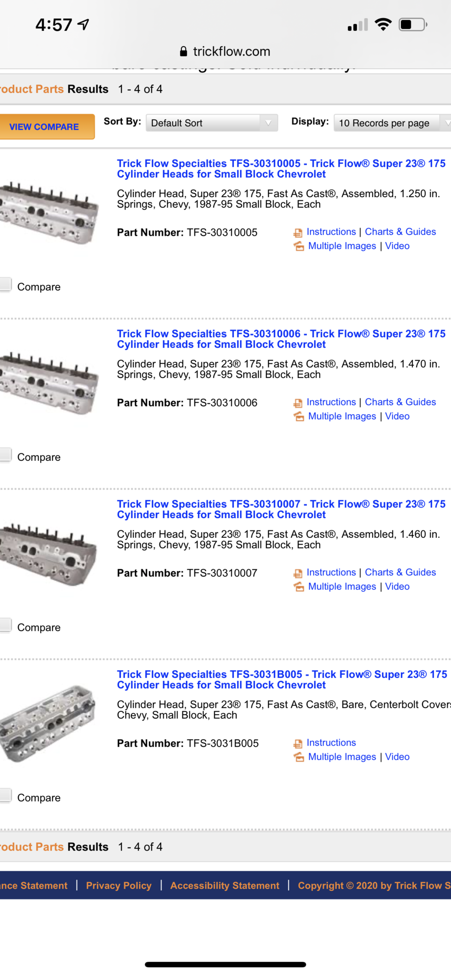

Had a question I see Trick Flow has four different types of cylinder heads for my 305 TPI. Which one would be the best to get? Right now everything is stock. But I plan on getting some headers, and a new cam. Don’t have the money to swap the whole engine even though I would love to have an LS.

Can you post links to the four different heads?

they have that many for a 305? when i looked there was only one. make sure they specifically say 305. all the power in the world is in the heads so do whatever it takes to get the best possible heads you can. if it means saving a bit longer its worth it. trick flow are decent heads though. the heads i saw were the 23 degree heads that had i think a 58 or 56 cc chamber to bump up compression a little which is a really good thing.

Old Aug 9, 2020 | 05:02 PM
Ironmike77's Avatar
Joined: Jun 2020
Posts: 116
Re: Trick Flow cylinder heads
This is what is on the site. And I was just curious. I don’t mind spending the cash for some good cylinder heads. I have to do my intake gaskets, I figured might as well do the cylinder heads since I’ll be ripping into the engine anyways. If I decide to buy the Trick Flow heads, any suggestions what I should buy with them?

It looks like there are 2 heads - the first 3 are perimeter bolt valve cover with 3 different valve spring combos - but the same head.
The last one is for centerbolt valve cover.

https://www.trickflow.com/search/pro...lock-chevrolet
There are two heads: one centerbolt and one perimeter bolt. Each is available four different ways: bare(to assemble yourself), or assembled with 1.250 diameter springs, 1.460 springs and 1.470 springs. The cam lift limits will be determined by the spring diameter. The specs are all there.
These will also transfer to a 350, if you go that route later.
